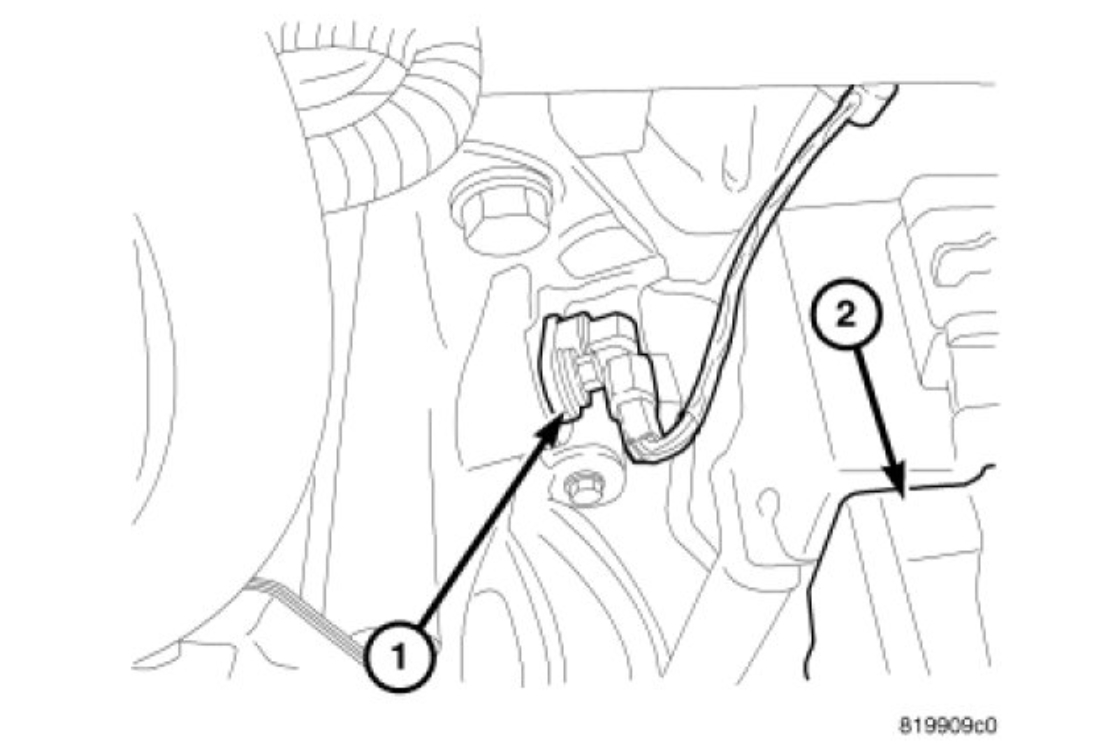

I was driving my car listed above when all of a sudden out of no where it stalled out on me. Red volt a d check engine light started blinking rapidly to leave me with no spark to my spark plugs. crank but wont start problem.

The most common cause of a spark loss is the crankshaft position sensor. Take a look through these links:
https://www.2carpros.com/articles/how-a-crank-shaft-angle-sensor-works
Here is a link that explains in general how one is replaced:
The best thing to do, if you can, is get your hands on a live data scanner. When it is plugged in, crank the engine and check to see if you have an RPM signal. If there is no signal, the sensor is where I would start. Also, while the scanner is attached, check for diagnostic trouble codes.
If you find the sensor is the problem, here are the directions specific to your vehicle for replacement. The attached pic correlates with the directions.

pic 1
The crankshaft sensor is located on the driver side of the vehicle, above the differential housing. The bottom of the sensor sits above the drive plate.
1. Disconnect negative battery cable.
2. Unlock and disconnect electrical connector from crankshaft position sensor.
3. Remove sensor mounting screw. Remove sensor.
