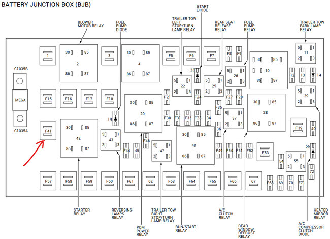

The lights come on but the engine is not cranking?
2010 FORD EDGE
235,241 MILES • 3.5L • V6 • 2WD • AUTOMATIC
NAKAIAGH
My car was just fine 40 minutes ago. I went to start again, and the lights came on, but it is not cranking.

It sounds like the starter motor has gone bad, but can I ask if the engine will crank in neutral? Also, please go over this video which can help you fix it:
https://www.youtube.com/watch?v=6YRW8fyNudY

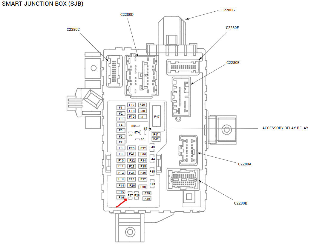

I would check the fuse #f27 in the smart junction box on the left side of the dash and fuse #f41 in the fuse panel under the hood. Here is a guide to help you:
