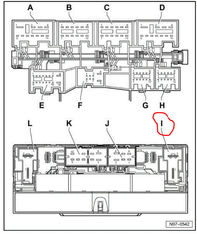

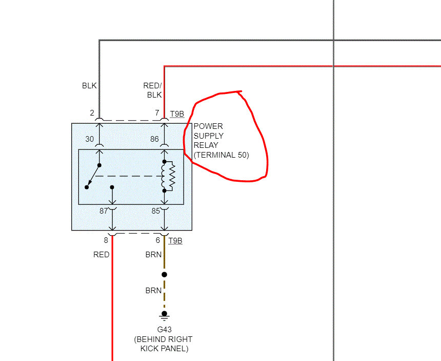

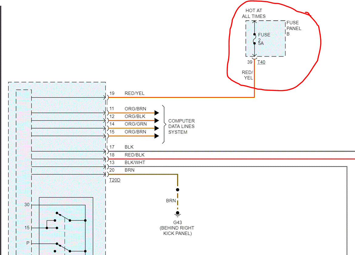

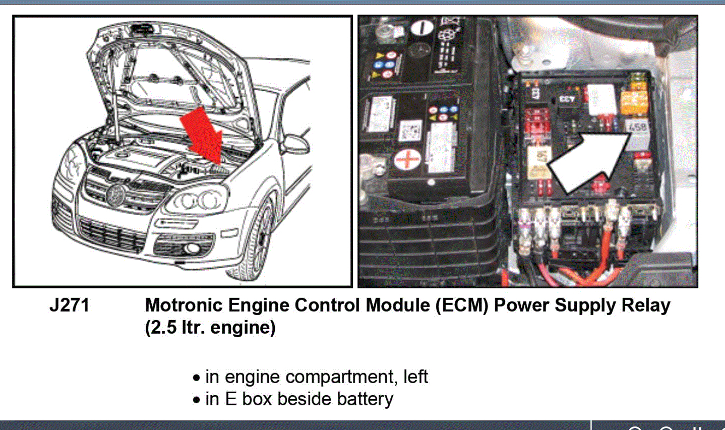

Car was running. shut it off and went inside house. came out and it will not crank or nothing. Has new battery.
May 18, 2020 at 7:36 AM
  • 110,244 POSTS
The first things to check are fuses and the power supply relay. See pics 1 and 2 below. Pic 3 is for location of the relay box and pic 4 shows terminal 50 power relay.
As far as fuse 2, it is in the vehicle on the left side under the instrument panel.

Thank you sir, everything that you mentioned was checked. it did have a bad relay, but it turned out to be the starter that was bad. Replaced the starter and it started right up. Thank you very much for your timely reply and your expertise. You helped out more than you know. thanks again.
