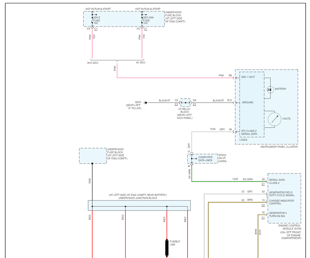

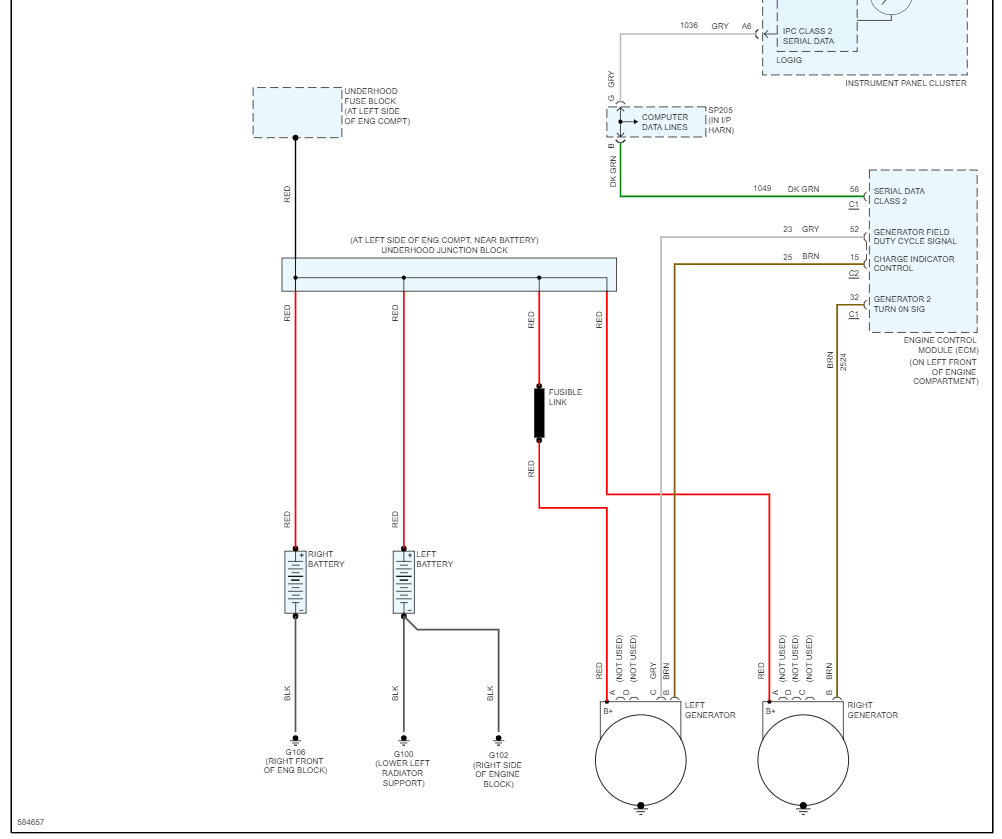

Truck is a c4500 Kodiak. The truck has new-ish battery’s (they were tested fine) but the truck won’t charge off of the brand-new alternator. While driving the dash became dim, then the ABS light came on. Then the transmission lost reverse then the gauges went out then the sputtered for a minute and shut off. Went back about an hour later fired right up still no gauges ran for about 3 to 4 minutes then shut off again. Replaced alternator figured that's what it was started up gauges came on power probe and battery gauges started at 9 volts. Idled about 8 minutes then shut off and wouldn't start.
Bench tested the new alternator and it passed. I checked the 12v battery the junction box to the battery and it was a clean 0.1ohms, then I checked ground strap for the engine, 0.3ohms and clean. Suggestions?

It shows this vehicle having two alternators. Also did you check the fuses? Here is a guide to help and the charging system wiring diagrams so you can see how the system works and which fuses to check:
You should check the connection from the alternator to the battery (main power) Check out the images (below). Please let us know how it goes.
