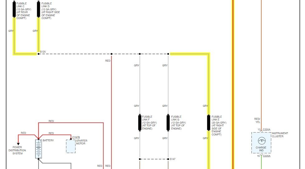

My batteries were draining overnight so I found that if I unplugged the pigtail on the alternator it was fine. I would just plug it back in when running. I bought a new alternator and installed it and when I plugged the pigtail in it hummed. So I am sending that one back and got a replacement from AutoZone ( alternator was lifetime) when I installed the new one I have nothing. No battery light on the cluster (cluster was rebuilt and I tried another and changed bulb) and when I test the lug on the back of the alternator I have only battery voltage. Yes I am waiting a couple minutes for glow plugs to go off. I also put the one that I ordered back on and it charges but hums key off. Any help would be appreciated. thanks

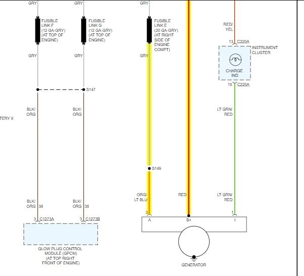

Good evening,
There should be 2 wires with battery voltage. The red and orange wires should have voltage all the time.
I attached a diagram for you to view. Let me know which one is not hot.

The wire with the fusible link has power all the time as it goes to the batteries. The other wire gets power when I start the truck.

I have constant power to the wire on the pigtail and when I start the truck I get voltage to the the other wire on the pigtail (the one that goes to the cluster).

The orange wire should have power all the time. The red wire should have power all the time as well.

The orange wire is powered externally. It has nothing to do with the alternator itself. It comes from the battery through the fusible links as in the diagram I sent you. When that wire gets voltage, the alternator will work.

The orange wire with blue tracer also has a fuse able link directly to the battery and has power all the time.
Nov 27, 2019 at 11:30 AM
Okay, so the orange/blue and the red have power with the truck off?
What about the green/red wire?
