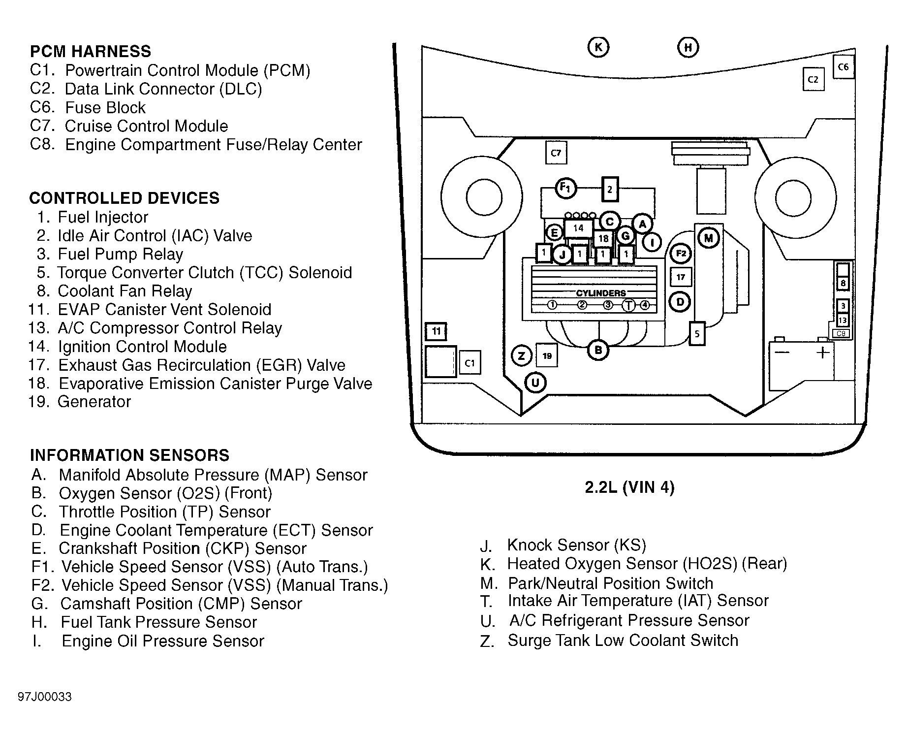

My car will turn on perfectly, run, but when I try to accelerate past forty mph, the revolutions drop which reduce my speed, so I cannot get past forty mph. Also, when I am parked and the car is on I can smell gas. Check engine is on.

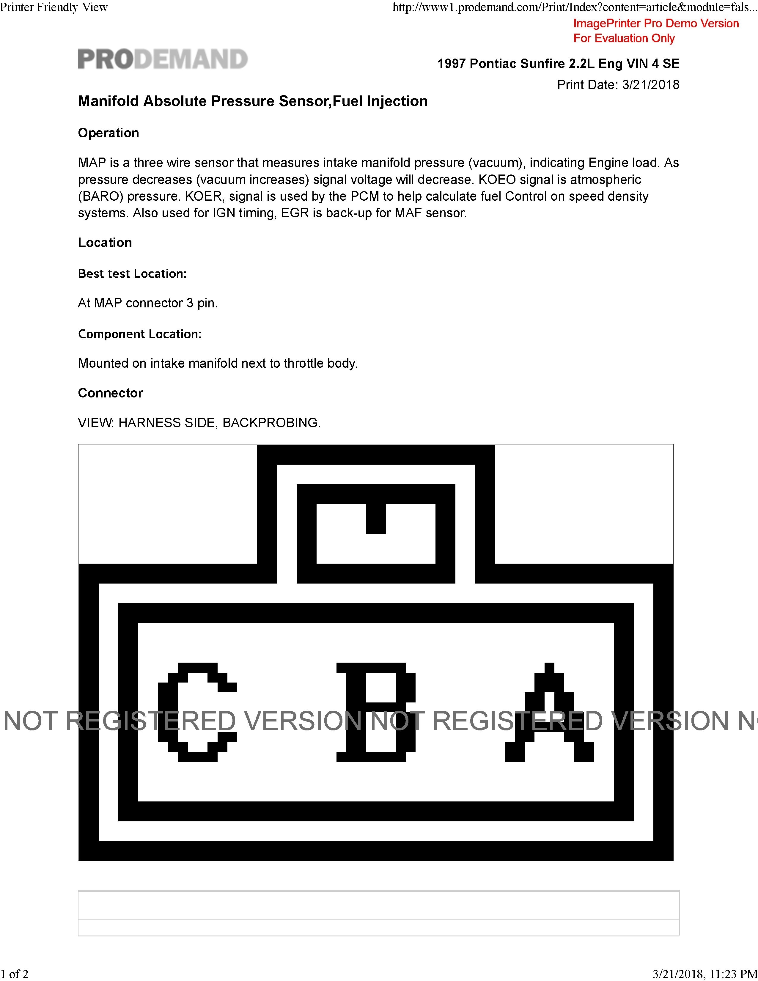

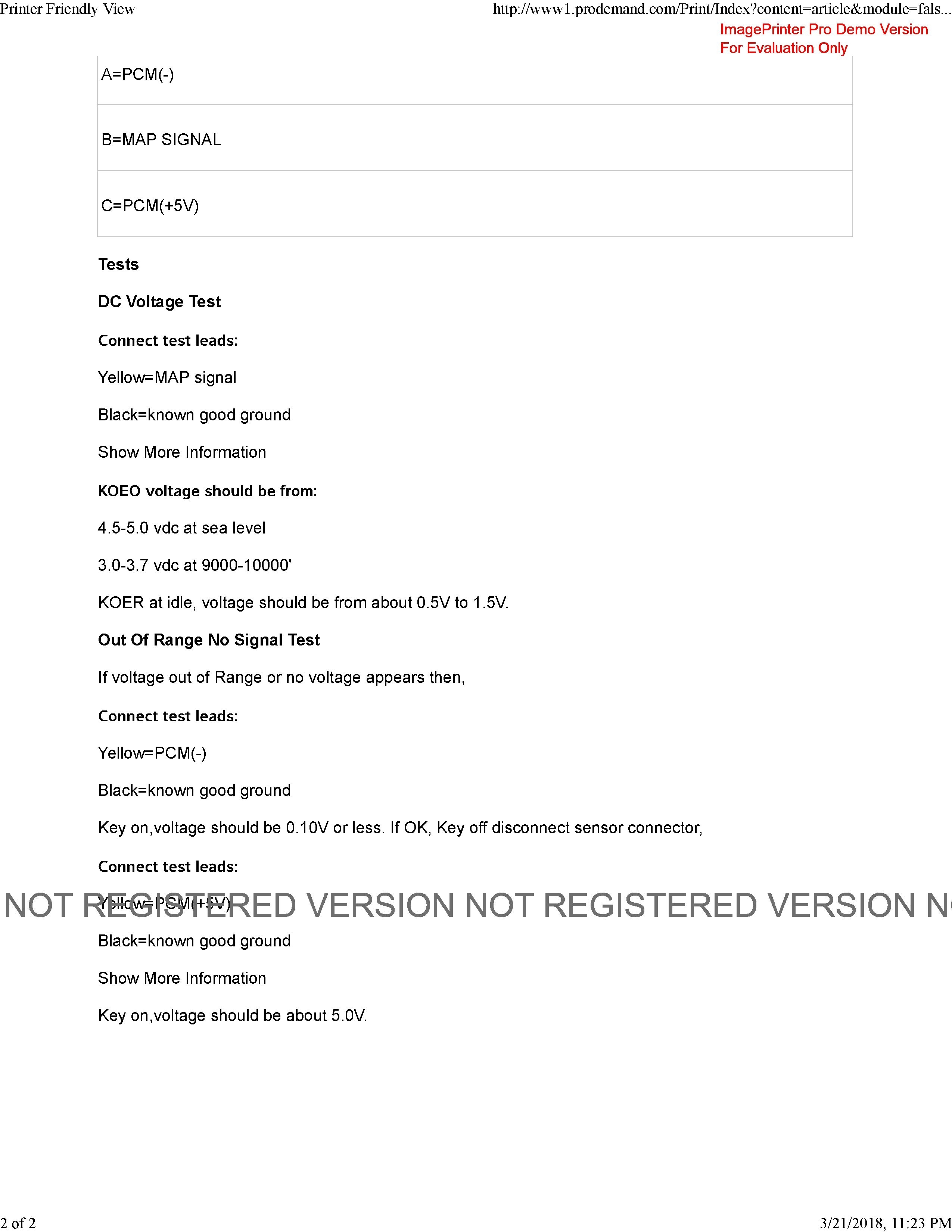

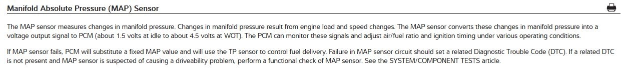

HEYMAN1104, I tried doing that. It seems like it had a worse performance. I just got a new reader and it shows that the O2 sensor is bad. I took a look at the O2 sensor and it looked pretty dirty and worn, so I am going to buy a new one and try it out. Afterwards I will look at the knock sensor. What is odd is that even though I changed the MAF sensor the reader is telling me that there is a MAP sensor error, but I do not think this car even has a MAP sensor since cars usually have one or the other. Besides that if nothing works I think it might be the wires are damaged somewhere along the way. What do you think?

It does indeed have a MAP sensor. I am attaching all of the pertinent information that GM has provided on it in the images below. Please check it out and go from there.
