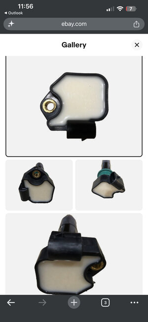

I have a North Star engine on my 2005 Cadillac deville. I’m trying to change the coil packs but my car they are one single coil pack where as now they sell them on a bracket of 4. How do i convert my car to be able to fit the bracket of 4? Is there a wiring harness i can buy to make it work or what should i do

When i go to buy the coil pack it says it’s discontinued. So what do i do then?

First off, why are you changing the coils? Misfire or damage? The units are a plate with the coils bolted to them as shown in the image above and individual coils are still available, the complete plate assembly design is what is no longer available. The replacement units are a plug and play replacement for the 4.6. Now if you mean that your car has a single coil but 4 plug wires per side like the image attached, you may want to check the actual year of the vehicle as that coil unit was used from 1987-1999 and has replaceable coils on it. Could you take a picture of the coil assembly you have, please?

This is the coil pack that I have on my car a single one. And there’s 8 of them. The problem as to why I’m changing them is when I start the car it shakes when idling. The whole car shakes. I’ve cleaned the maf sensor the air filters good the idle air control and throttle body are both cleaned as well. So I hooked it up and it’s throwing p0300 random misfire. What would you recommend I do to fix the problem. Oh and it also does at random stop signs when I’m stopped there. Like it just dies out of no where

That is a single coil for one cylinder, you have 8 of them and that is why you get the units on brackets as that would be all 8 coils. However a P0300 is a random multiple misfire, IE it is multiple misfires across all cylinders, most likely not the coils as they would all have to be failing at the same time. Instead what you want to do is look at the misfire counters and see which cylinders are generating the most misfires. The Northstar engines do have a bad reputation when they start throwing codes. Has this engine ever overheated? Or used and coolant? I would look at the misfire counters, then pull the plugs in those cylinders and look at them for anything strange like glazing or steam cleaning. From there I would install new plugs, then shuffle the coils from the misfiring cylinders after examining them for damage and carbon tracking.
