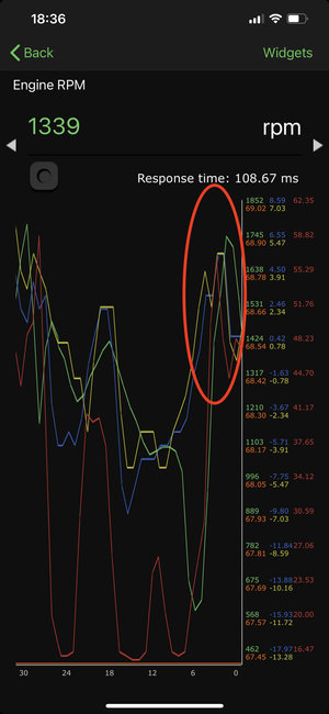

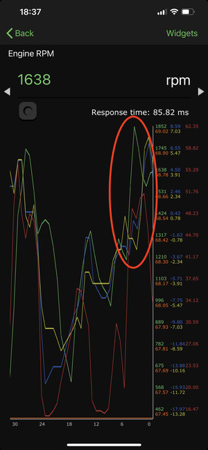

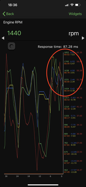

CLASSIC1968
Hi Joe,
I'm sending you the scans, indicating the moment of the hesitation/jerking.
Temp: 81C
Green line: RPM
Orange line: Fuel level Input (%)
Blue line: Short term fuel % trim - Bank 1
Yellow line: Short term fuel % trim - Bank 2
Red line: Engine load (%)
The jerking is more notorious when the AC is on.
I drove the car around the neighborhood for around 7-10 minutes.
Still no DTCs. on the scanner.
I hope this can help a little...
Thank you again!
Guillermo

  • 110,240 POSTS
Is the circled section where you noticed the issue? I ask because I'm not seeing anything standing out.
Let me know. Also, sorry for the delay in responding.
