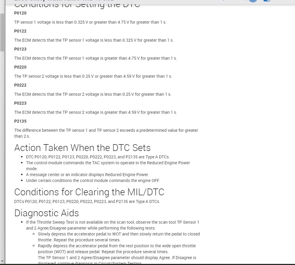

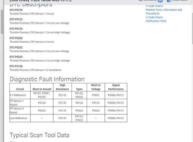

These issues could be related but the first two are for the throttle position and the last is for the EVAP system. So that means we need to start with the throttle codes and if that fixes all three then that is great.
If not, we can move onto that one.

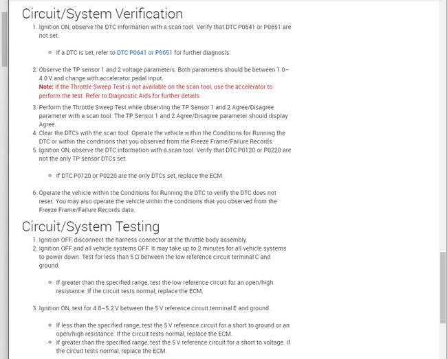

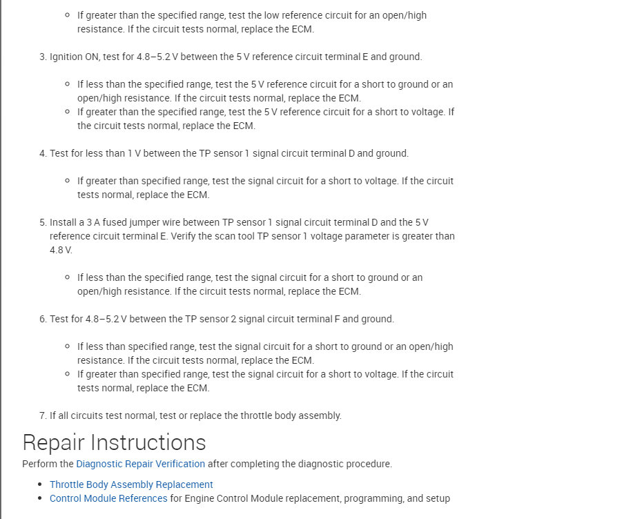

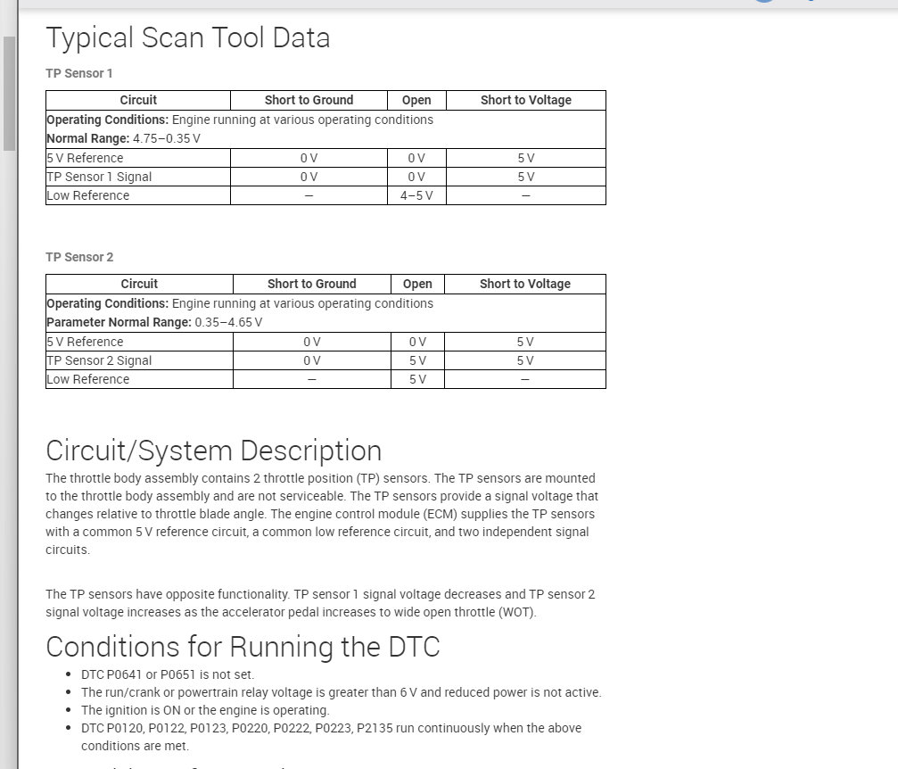

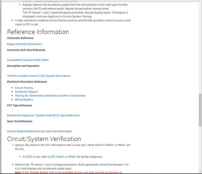

Basically, these could be related if the 5-volt reference circuit, but we need to confirm this first by following the testing below.
I suspect we have a wiring issue or a PCM issue since you have codes for both TP 1 and 2 so let's start with this testing and see what turns up.
Let me know if you have questions on this.
