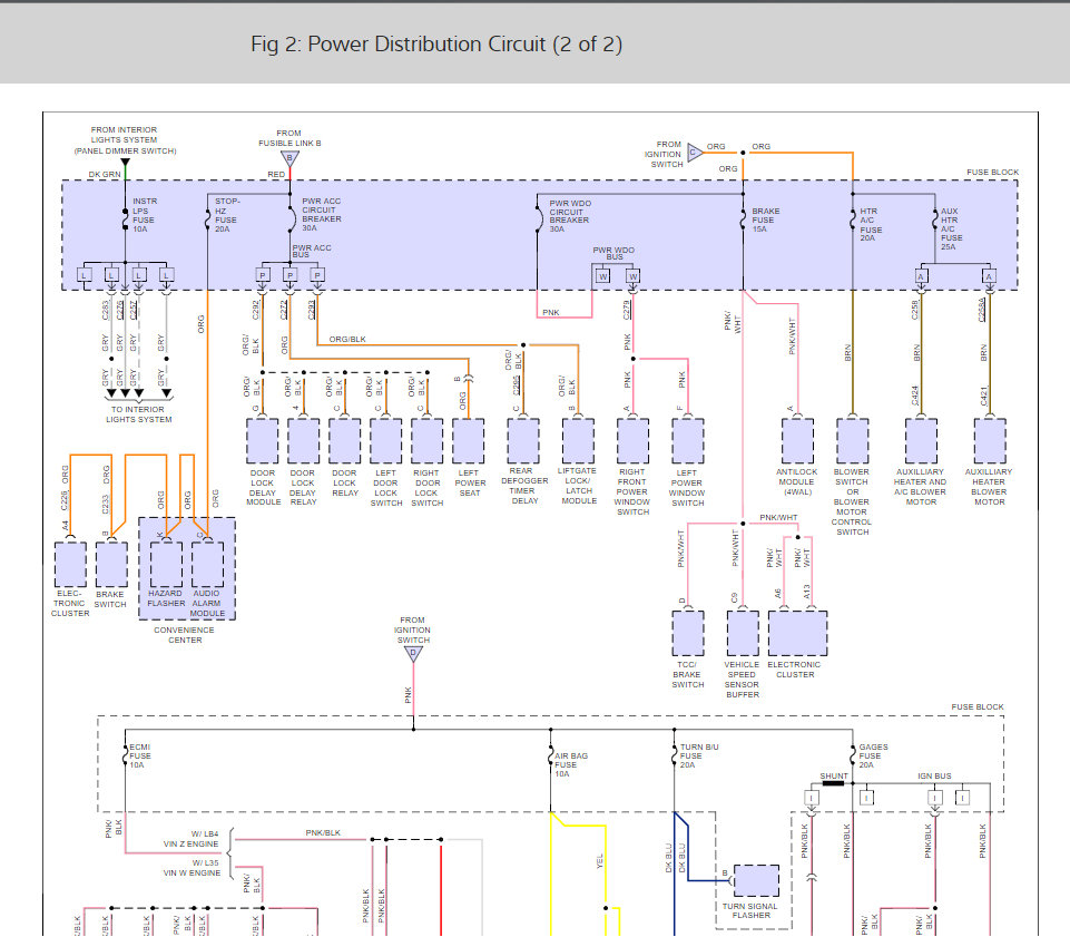

My interior dome light, radio clock and power side view mirror adjusters do not work. All the fuses are not blown. I cannot figure it out.
Dec 24, 2017 at 11:32 AM
  • 54,840 POSTS

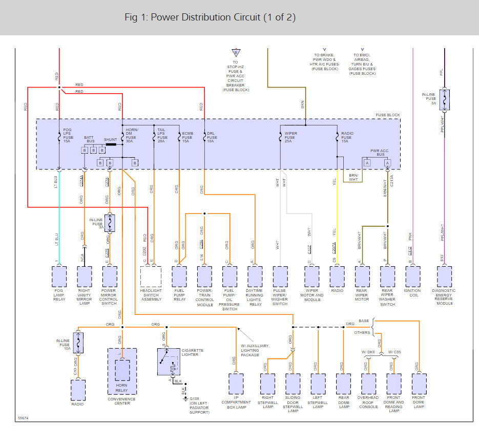

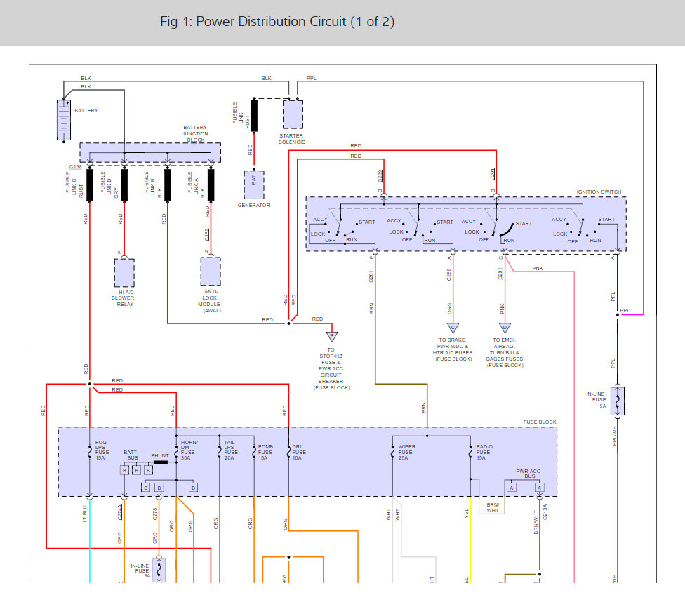

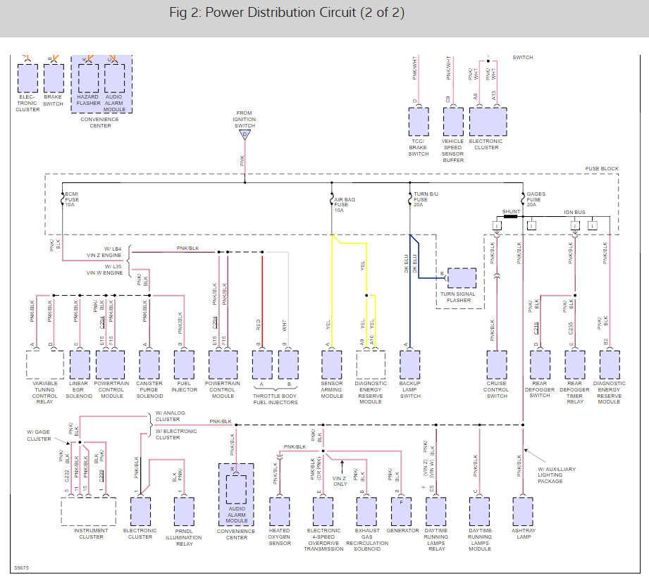

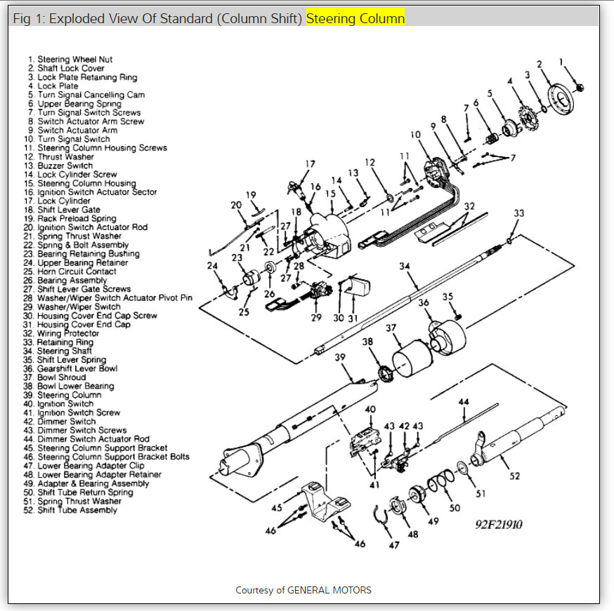

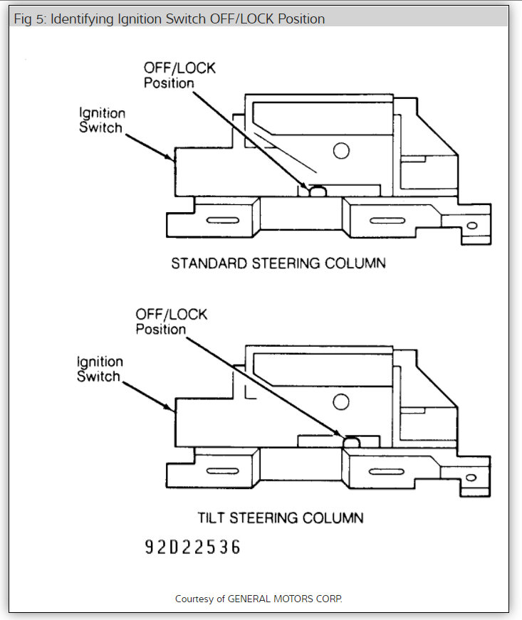

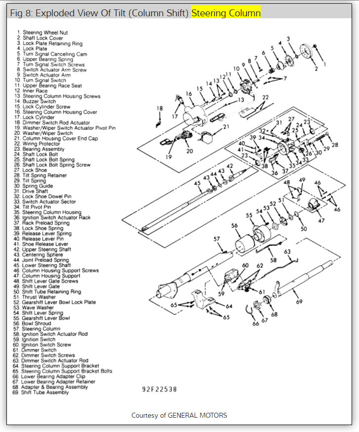

Can I ask if the fuses have power because if they do not it sounds like you have an ignition switch or a fusible link that is out.
Here is a guide to help us do some simple testing and figure out the problem:
Here are the power distribution wiring diagrams so we can see how the power is routed. You can see it running through the switch so test the output.
