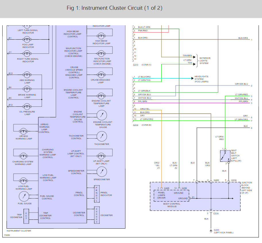

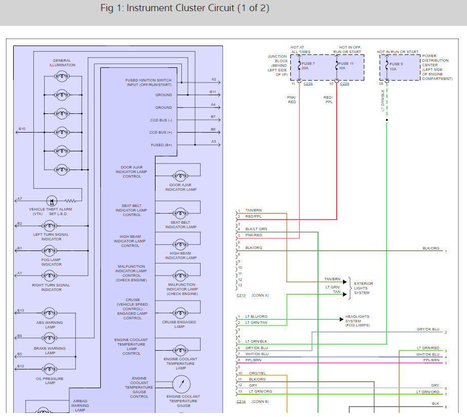

None of my gauges work. The airbag light is the only thing on.
Feb 12, 2018 at 1:02 PM
  • 54,858 POSTS

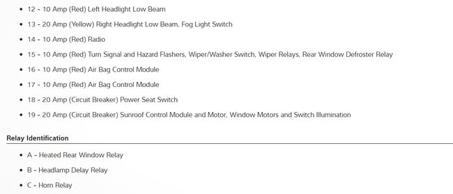

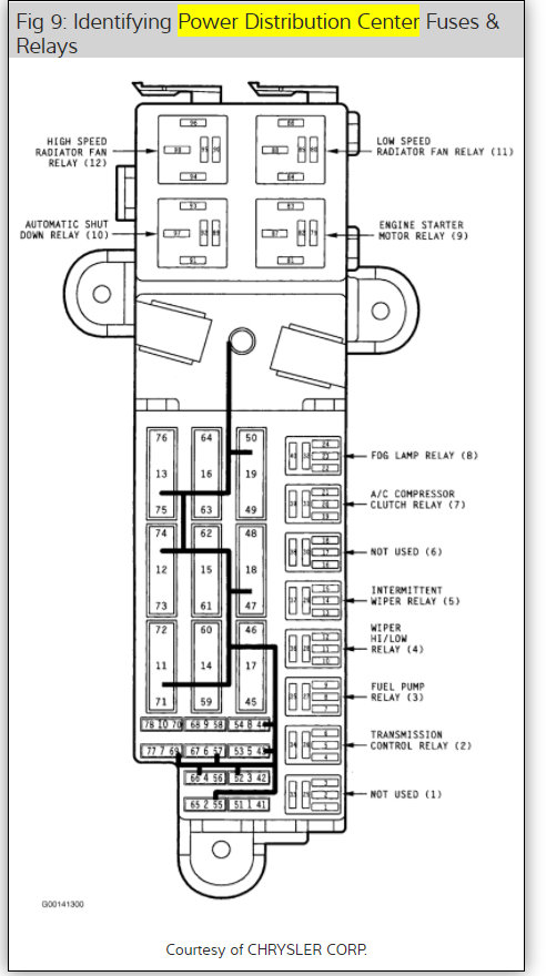

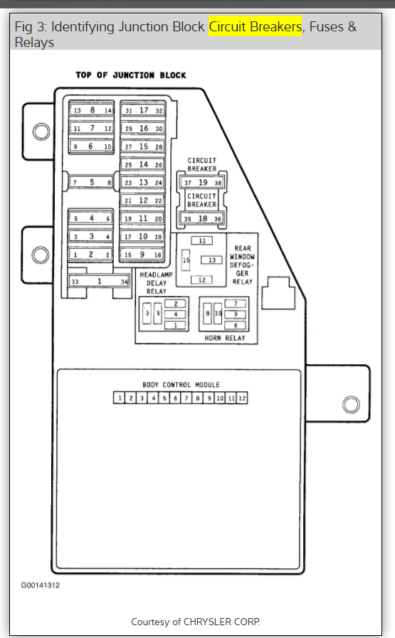

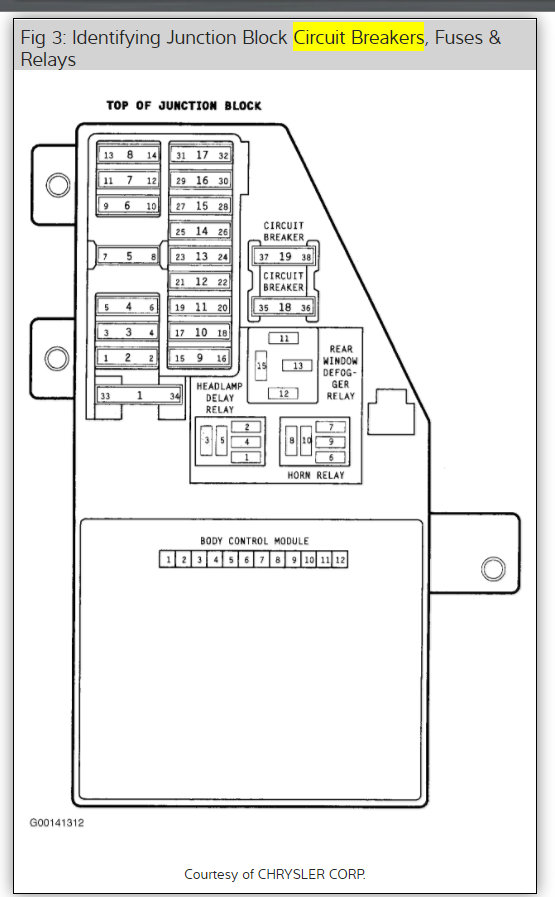

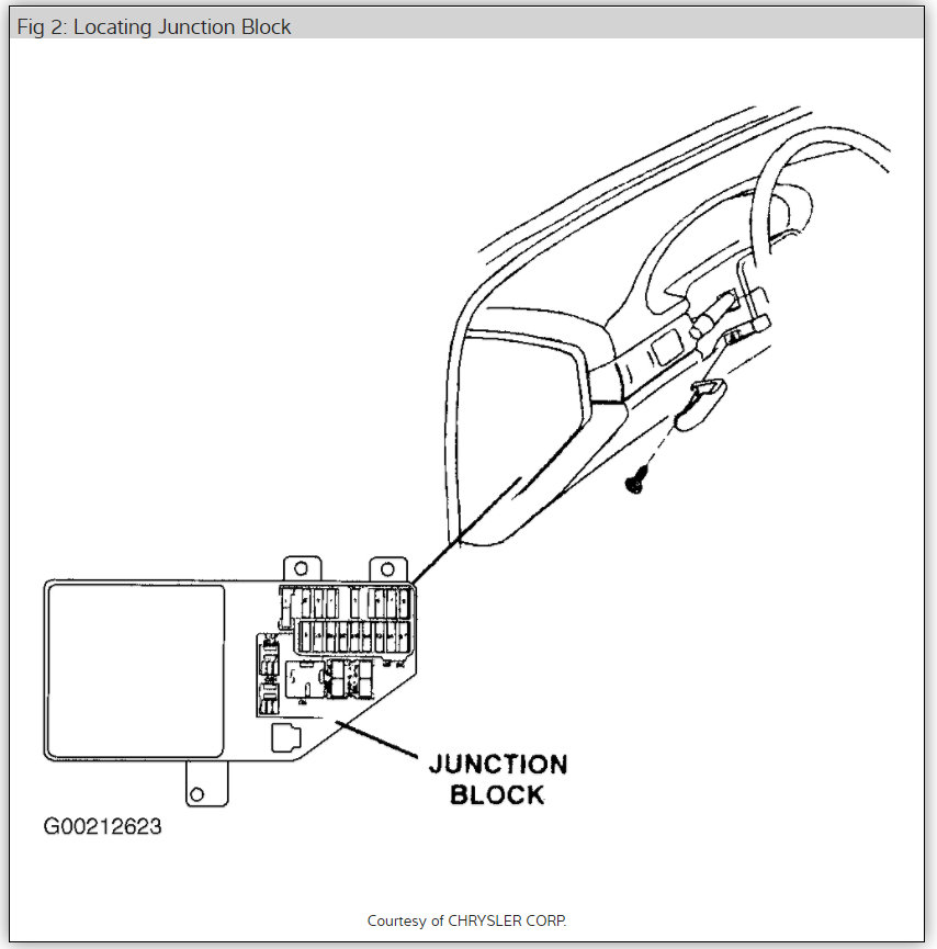

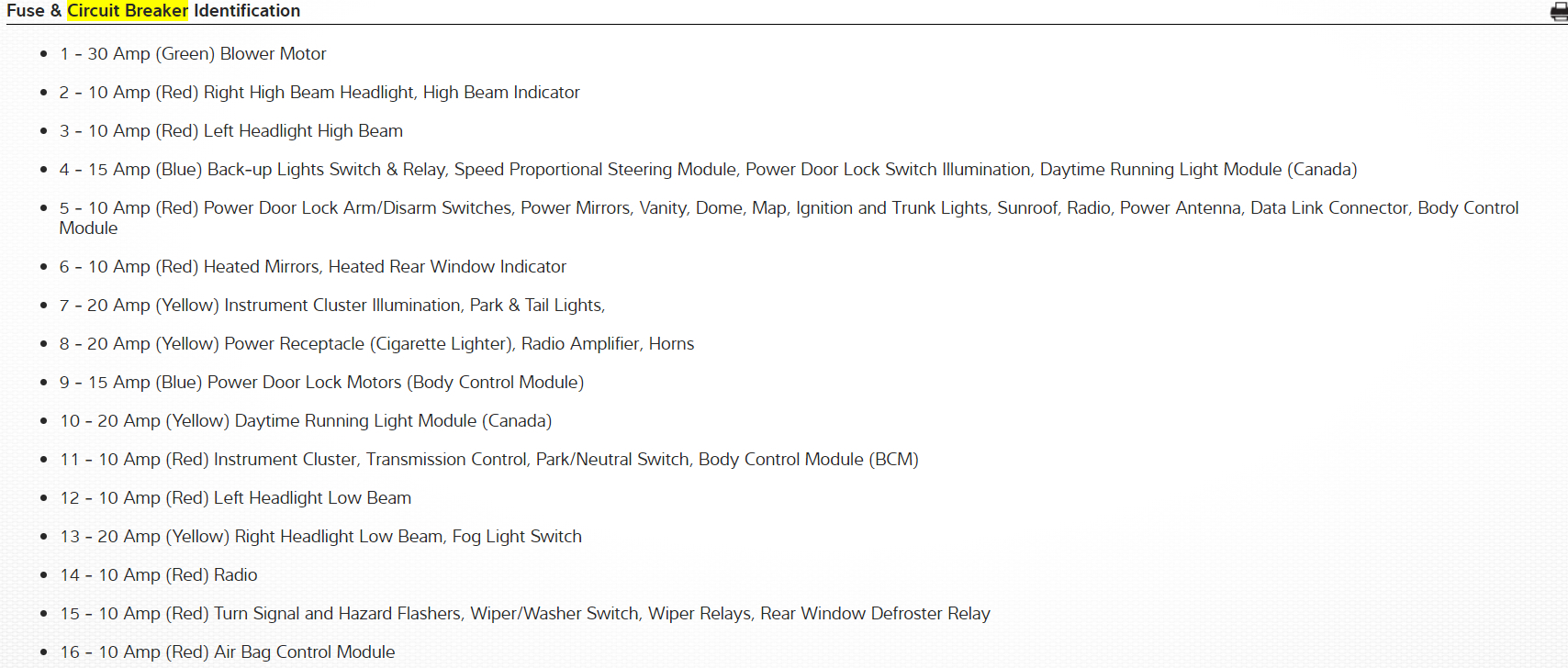

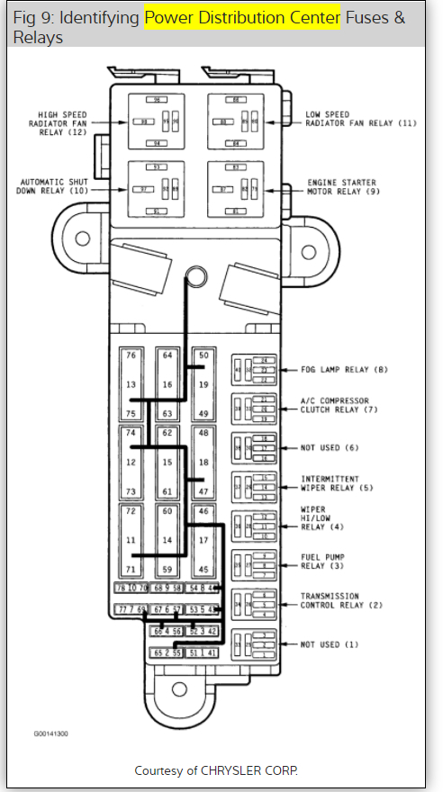

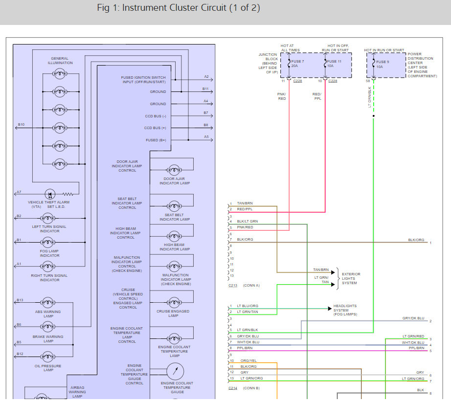

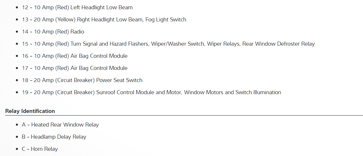

I sounds like you popped a fuse # 7, 11 or 9. Here is a guide to help you test the fuse and the fuse locations so you can find them:
Feb 13, 2018 at 6:19 PM
IRMA MOORE
That didn't work. Was told might be the computer to the car.
Feb 14, 2018 at 12:05 PM
  • 54,858 POSTS
It could be the cluster which is highly possible if all the fuses are good, did you check them?
Feb 14, 2018 at 12:06 PM
IRMA MOORE
Yes.. i think it something else.. on my way home i lost my gears. Had to drive home in 3.
Feb 14, 2018 at 10:19 PM
  • 54,858 POSTS

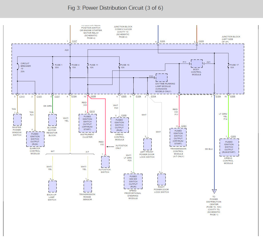

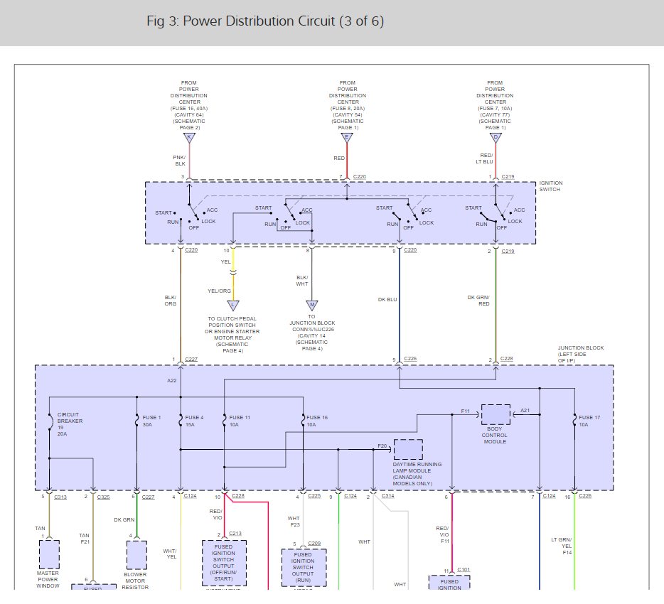

I have heard of this before and it ended up being the ignition switch but to confirm we should test through it. Here is guide and the wiring diagrams to help
