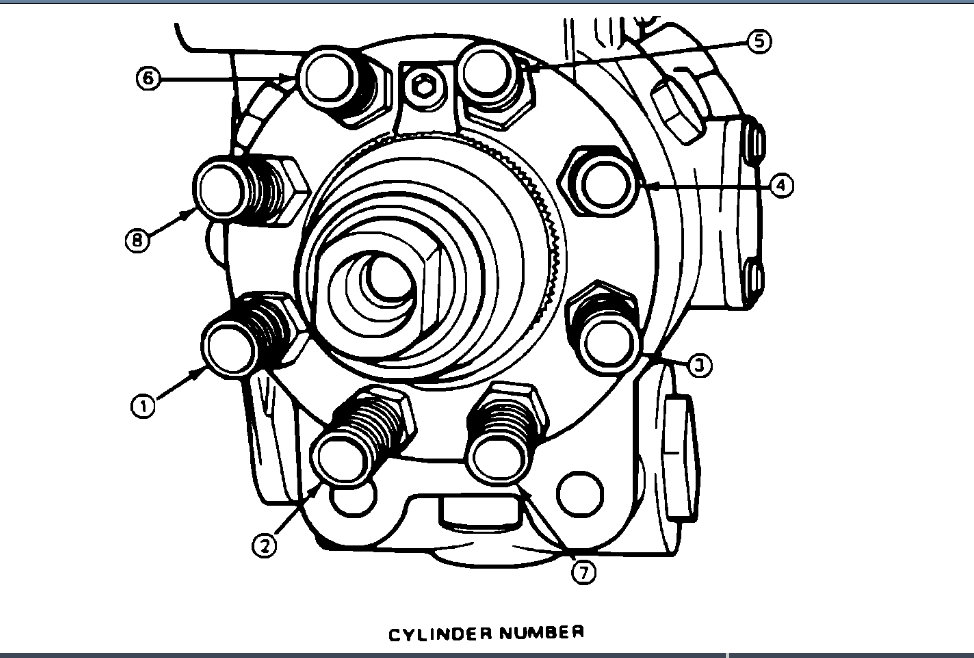

My truck has a non stop fuel leak coming from the front of my engine somewhere dripping down my cross member and it doesn't stop. I can't see where the leak is coming from.
Aug 5, 2019 at 8:26 PM
SCGRANTURISMO
  • 4,897 POSTS

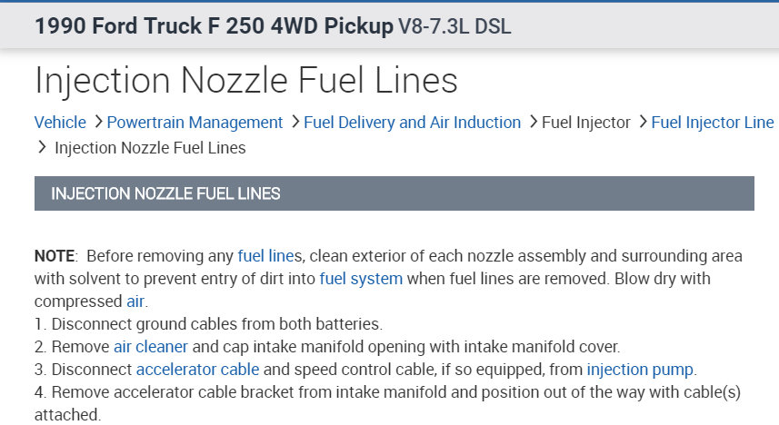

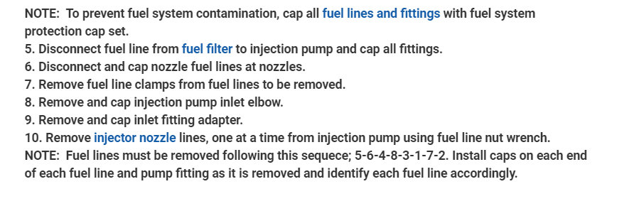

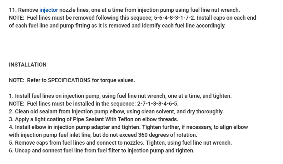

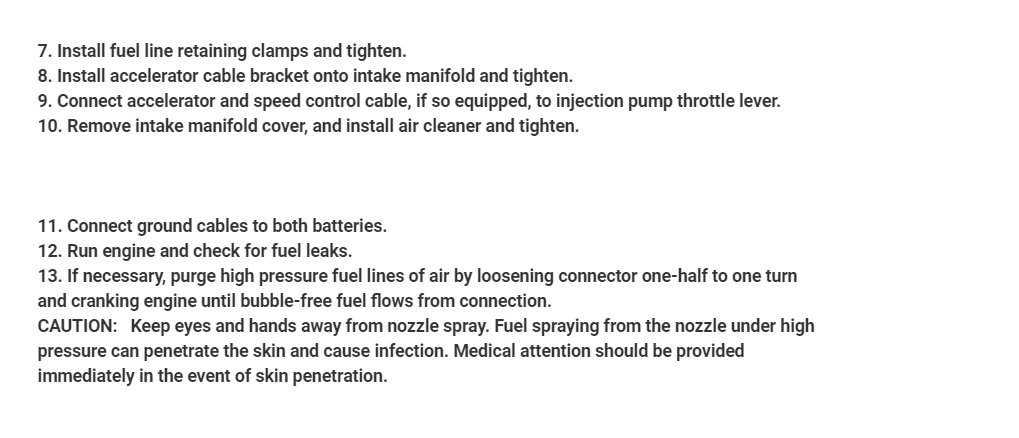

In the diagrams down below I have included the factory troubleshooting guide for your vehicle for the inspection and finding fuel leaks of the injection nozzle fuel lines. Please go through this guide and get back to us with what you are able to find out.
