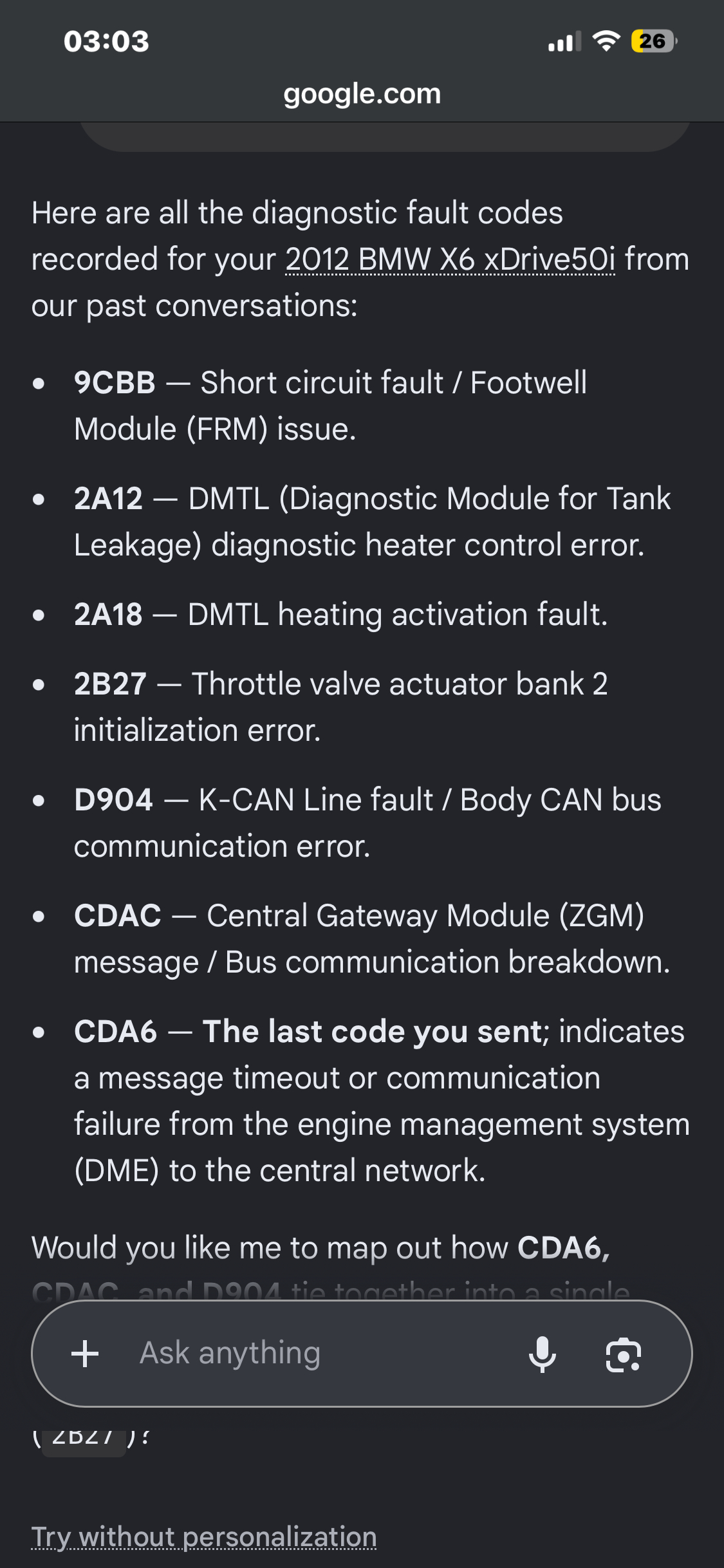

I am currently troubleshooting a series of intermittent communication and powertrain faults on a 2012 BMW X6 xDrive50i. Based on the diagnostic log, I am treating this as a systemic network or module failure rather than isolated component faults.
To proceed with pinout testing, voltage drops, and bus waveform analysis, I require the official factory wiring diagrams for the following fault codes:
1. Network / Bus Faults (Priority 1):
• CDA6 & CDAC: Message timeouts/bus communication breakdown originating from the DME to the Central Gateway Module (ZGM).
• D904: K-CAN line fault / Body CAN bus communication error.
• Required Diagrams: K-CAN and PT-CAN network topologies, including ZGM, JBE, and DME bus interfacing and grounding points.
2. Actuator & Module Faults (Priority 2):
• 2B27: Throttle valve actuator bank 2 initialization error.
• 9CBB: Short circuit fault within the Footwell Module (FRM3).
• Required Diagrams: Throttle valve actuator (Bank 2) circuit to DME, and primary power/ground distribution for the FRM3 module.
Any schematic data regarding shared ground distributions or voltage supply lines common to these specific modules would be highly appreciated.

First of all make sure the battery is in good shape. Did this car have water damage? I would check the floor boards for water. Here is the location for the footwell module, this is where I would start, disconnect the battery and remove the electrical connections to check for corrosion. Also, double check the fuses and look at the wiring grounds under the dash and hood. You can get a rebuilt unit by searching ebay or google. Let me know
