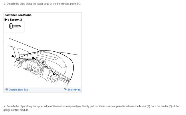

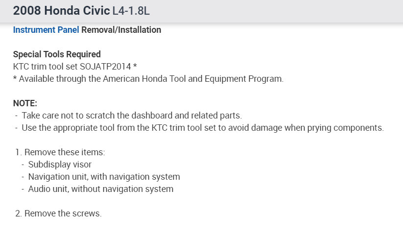

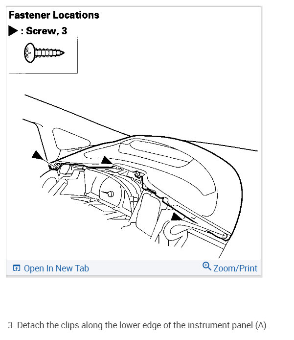

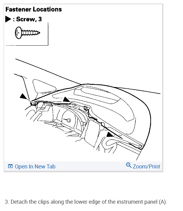

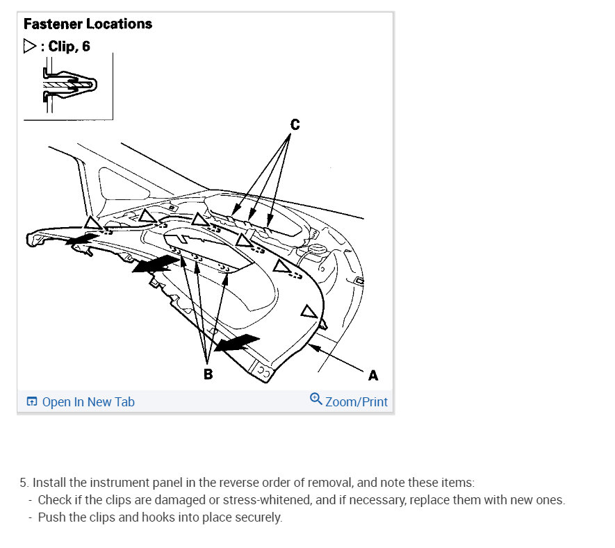

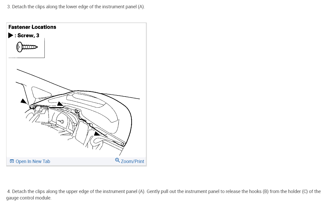

It must be some kind of dielectric gel over the LCD readout, I would get a rebuilt cluster by searching Google or eBay. Here is how to replace the cluster correctly in the images below. Please let us know if you need anything else to get the problem fixed.
