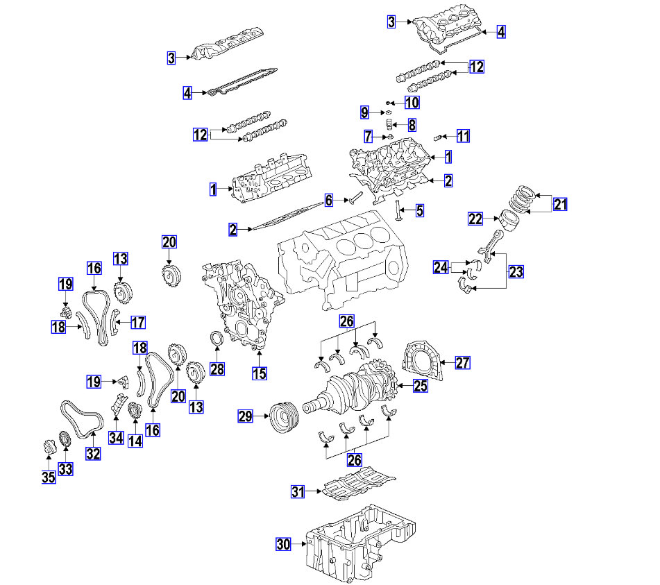

O wow, yes stop driving the car if have not already, it sounds like you lost the timing chain guides or a camshaft actuator is gone, can you tell if the sound is coming from the top or bottom of the engine, front or rear? Here is an exploded view of the engine try to visualize it when you hear the noise to get a location so we can go from there. Check out the diagrams (Below). Please let us know what you think.
Jul 23, 2019 at 6:13 AM
04XTERRAC
  • 11 POSTS
Just now it sounded near the driver. Normally it sounds more mid, almost right in the middle of the engine. I have gone almost 20,000 miles with this noise already, it's only on startup that it makes the click, once it warms up a little, it sounds like a more studdered hum with a steady quick ticking noise near the front of the car.

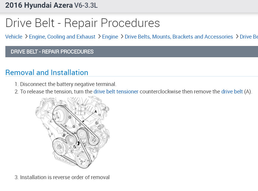

We can try removing the serpentine belt and then start it to see if the noise is still there this will eliminate any accessory that maybe making the noise. Check out the diagrams (Below). Please let us know what happens.
Jul 27, 2019 at 3:44 AM
04XTERRAC
  • 11 POSTS
I am sorry that it took me so long to reply. I took the belt off and the noise still continued. I can recall a while ago accidentally skipping an oil change, I don't think I went too far on it without the change, but the oil was well used and very dark. I'm not sure if that could have caused some damage inside the engine. The thing that gets me the most is that it's very loud on start and while it's cold, then once it's at the optimal temperature, the noise dies down to where it only picks up when I press the gas. It sounds like it's coming from inside the engine, almost the top of the engine. The spark plugs and oil are almost new, just about 3,000 miles each. No change of noise if the AC is running also.
