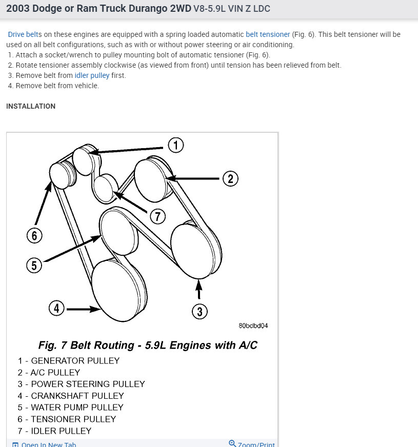

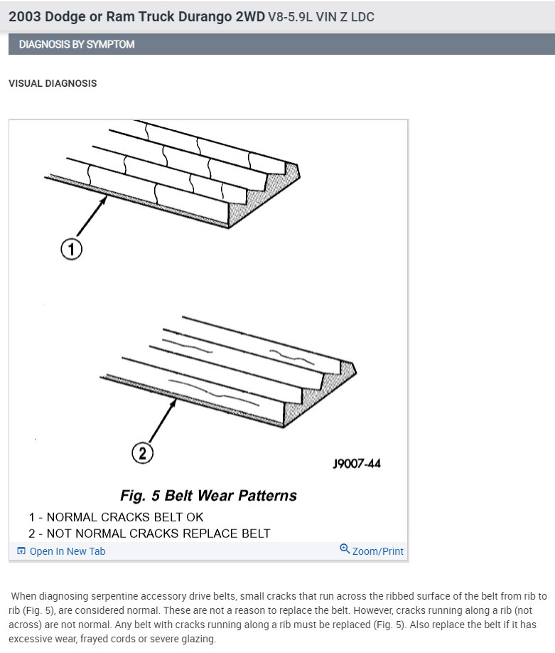

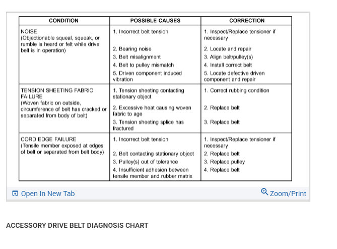

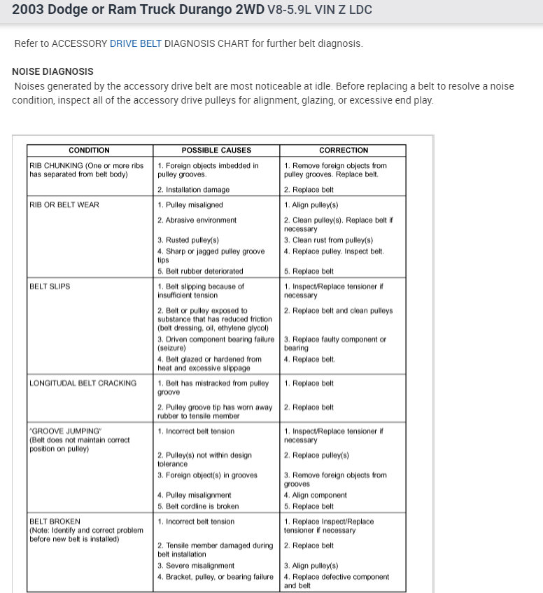

This could be due to a pulley or the serpentine belt.
The belt noise can change frequency with the engine speed.
One thing you can try is to spray belt dressing on the belt while the engine is idling. If the noise changes, then you will know the issue is the belt.
Here is a helpful article:
https://www.2carpros.com/articles/car-squeaking-noise
Can you possibly upload a video, so we can hear the noise? It will be helpful.

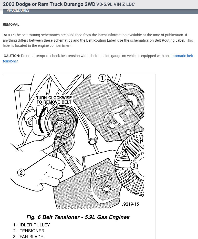

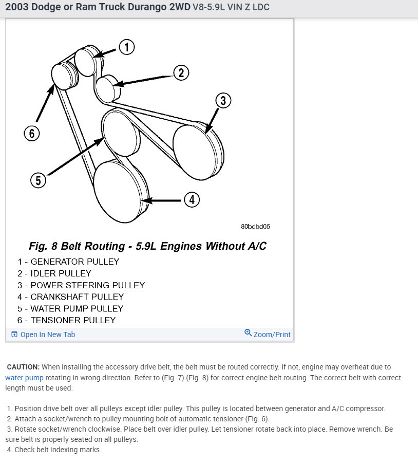

I have attached the belt inspection procedure below.
