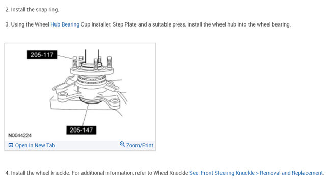

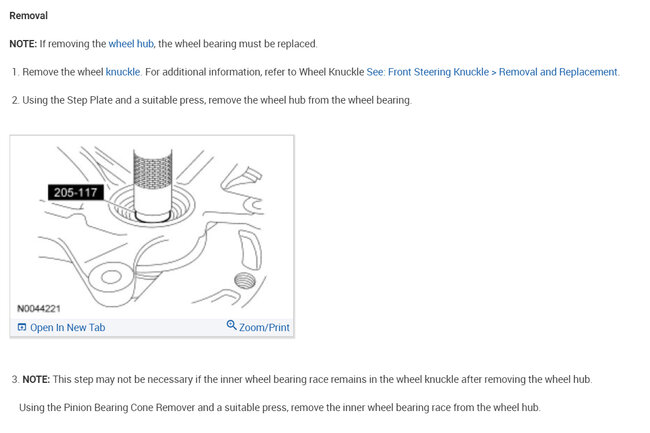

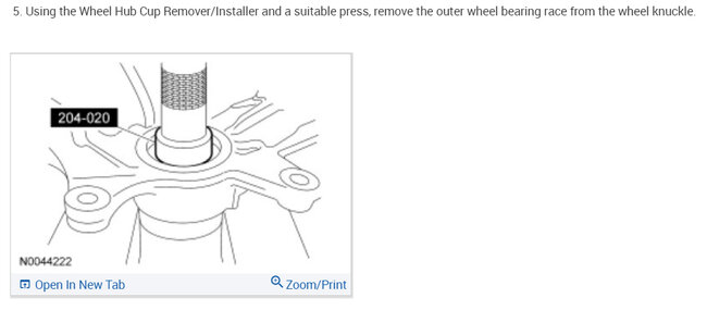

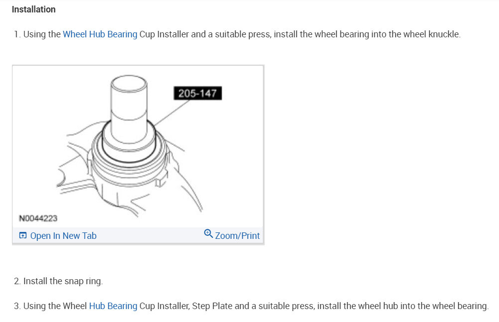

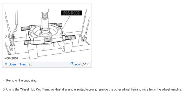

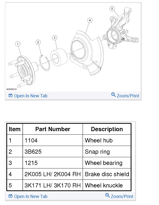

Just had right front wheel bearing replaced but makes grinding noise when turning left. Also, the car has been making roaring noise at speeds over 30 for the last year. Help!!
Sep 11, 2023 at 8:00 PM
  • 55,781 POSTS

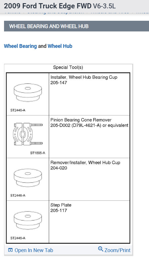

It sounds like the installation of the bearings is not good and needs to be redone. Can you please shoot a quick video with your phone so I can hear the noise? That way I can tell for sure what's going on. You can upload it here with your response. Here is how the job is done correctly. Check out the images (below). Please let us know how it goes.
