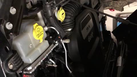

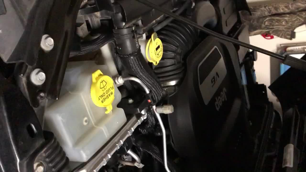

when I start it in the morning it starts fine with no noise. If I turn it off for a few minutes after driving then restart it sounds like a tractor/diesel starting up.
Check engine light comes on.

Can you upload a video of the noise so I can hear it?
Feb 10, 2020 at 5:00 AM
MARCPONDER
Here you go.
Feb 10, 2020 at 6:03 AM
Thanks.
That is an internal engine noise and is not good.
It sounds like a main or rod bearing. They quiet down when the oil pressure builds up.
I would have the oil pressure tested to be sure it is not the oil pump.
Do not wait on this. That noise could get worse and leave you down.
