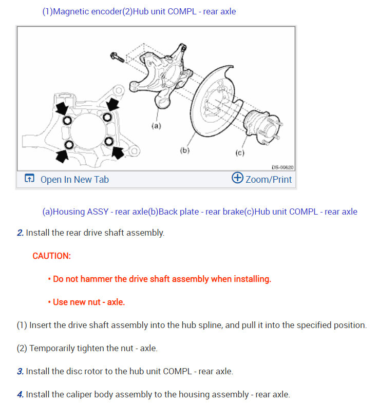

This vehicle about year ago. Makes what sounds like a lot of tire noise. A little grumbling at my feet. This car is known to need wheel bearing replacements, especially in the rear. No accidents alignment is good. Wheel balance is also good. I just can’t pinpoint it.
Jun 24, 2024 at 4:08 AM
  • 55,421 POSTS

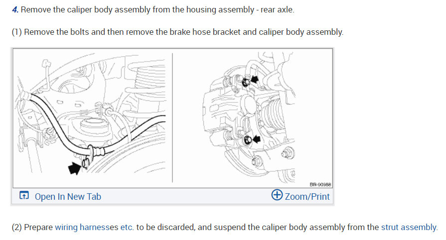

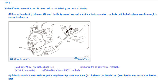

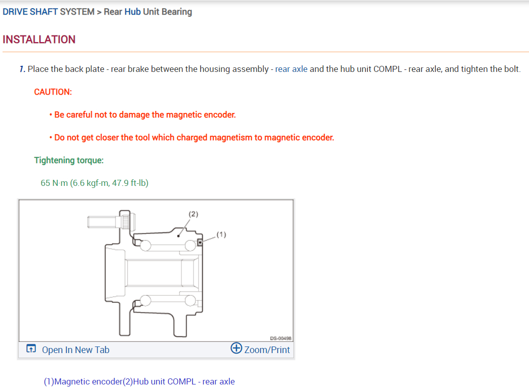

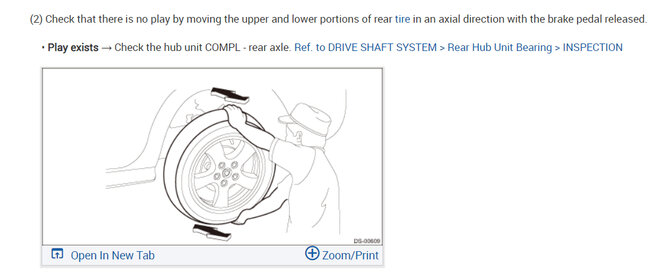

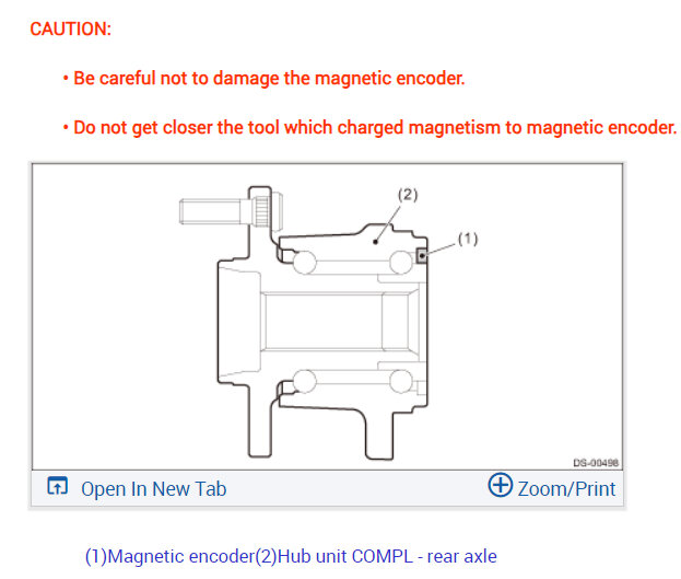

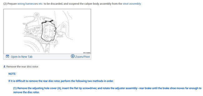

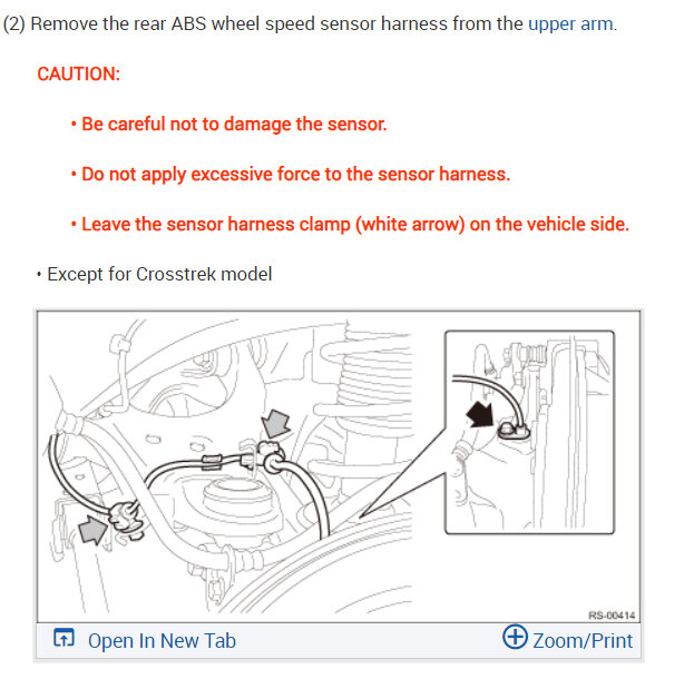

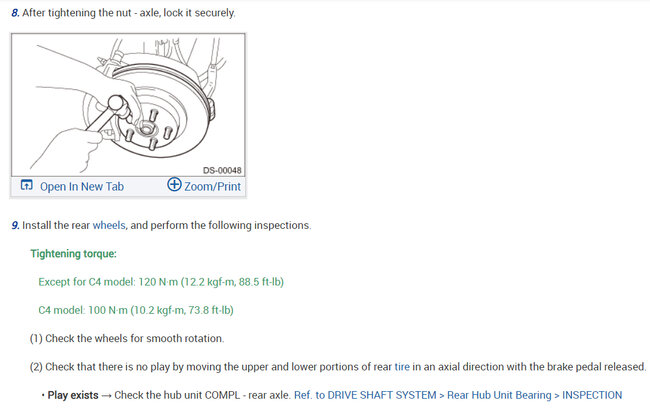

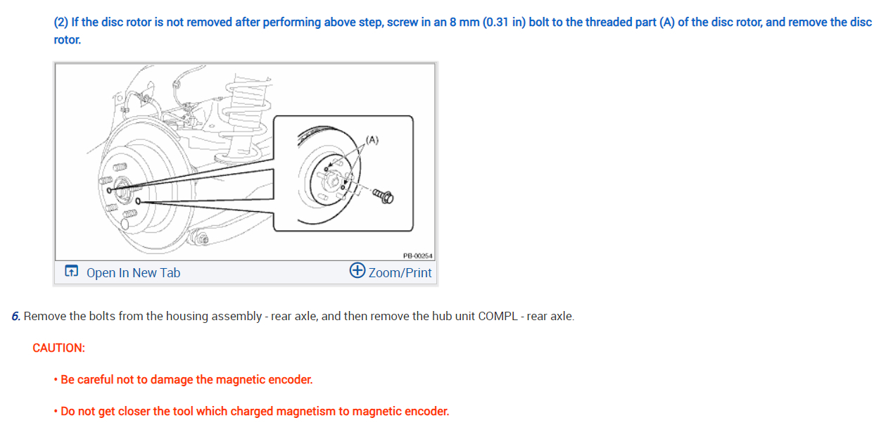

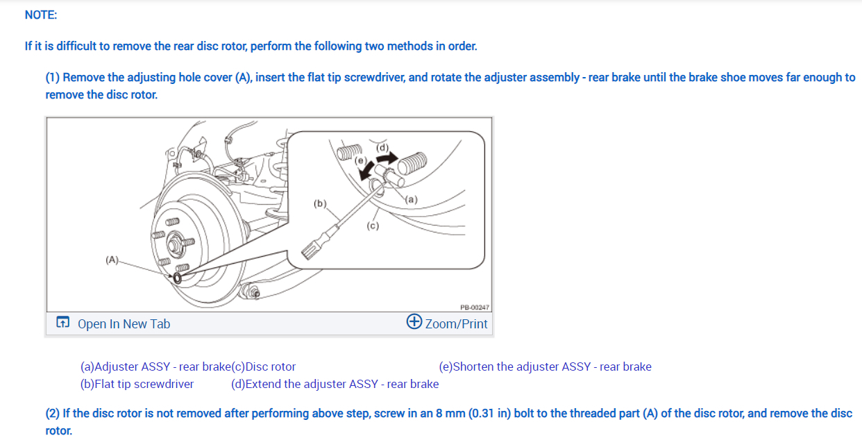

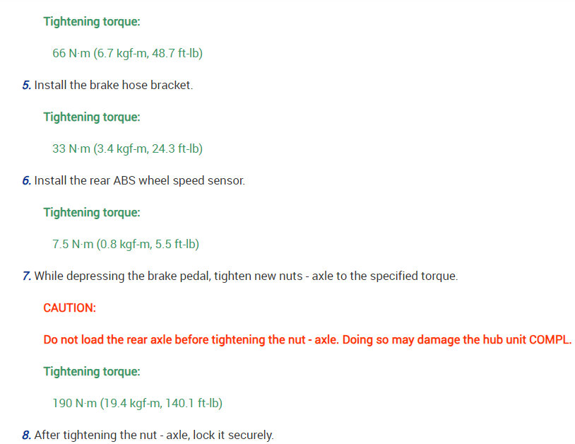

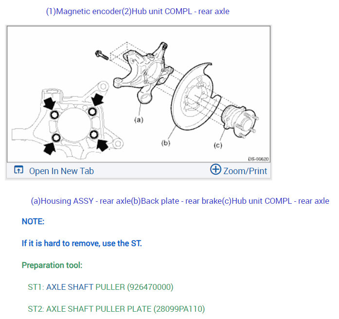

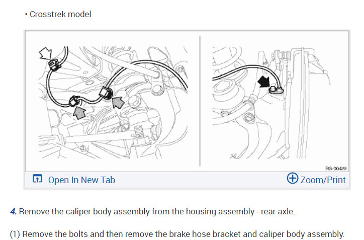

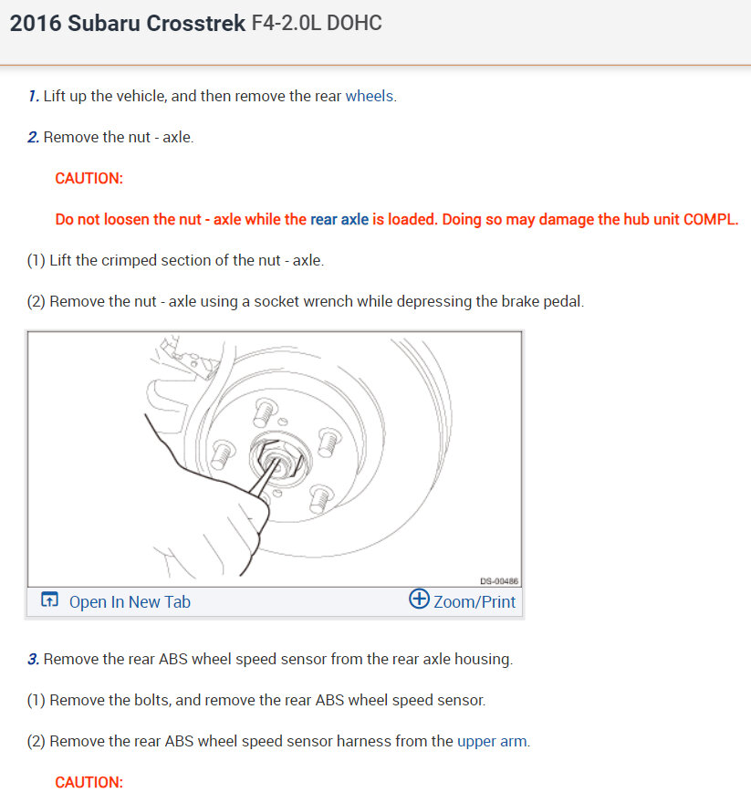

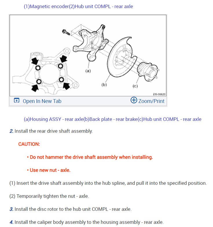

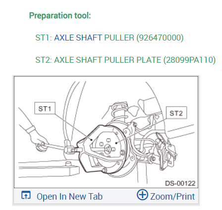

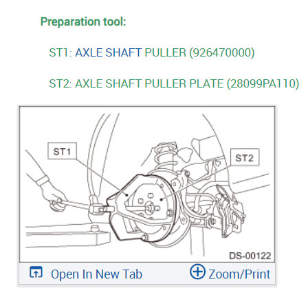

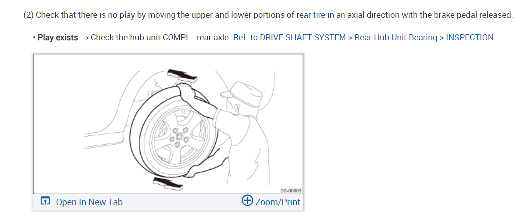

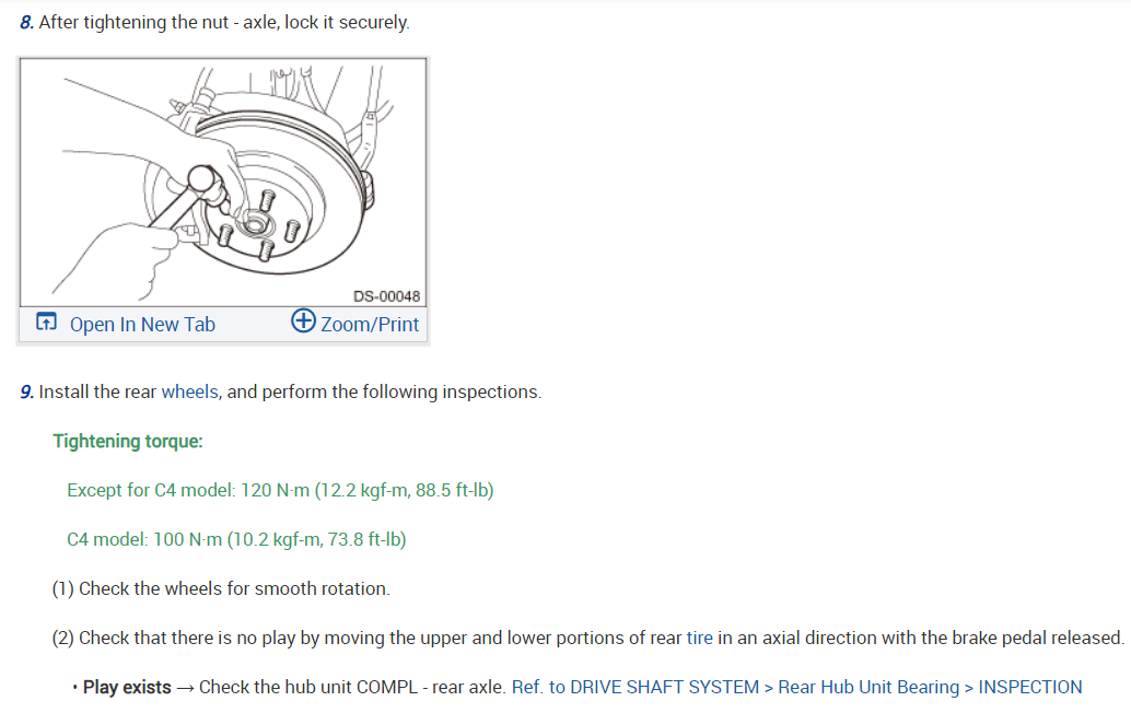

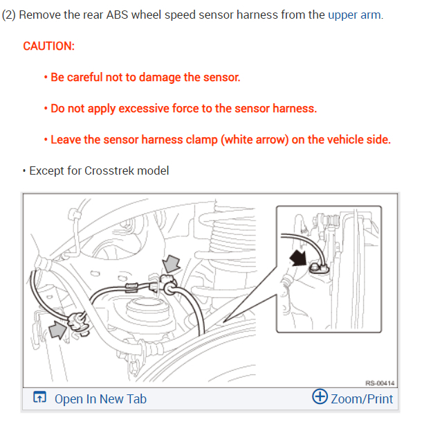

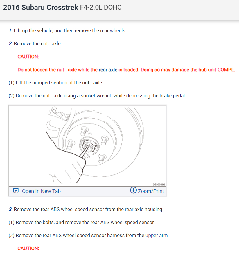

Yep, this is a classic wheel bearing noise, I would replace the wheel bearing hubs as needed to help fix the noise.
Here is a video of the job being done on a similar car with instructions for your car in the images below:
https://youtu.be/_FzmmBoa4Tg?si=tdF1tU1bPvpWEhuB
Here is how to replace the rear axle bearing hubs on your car. Thanks for the video, it helps. Check out the images (below). Please let us know what happens.
