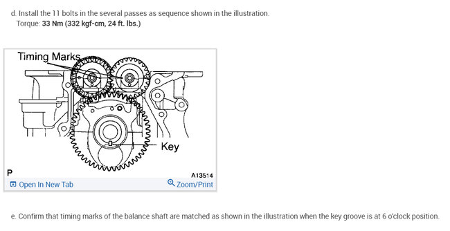

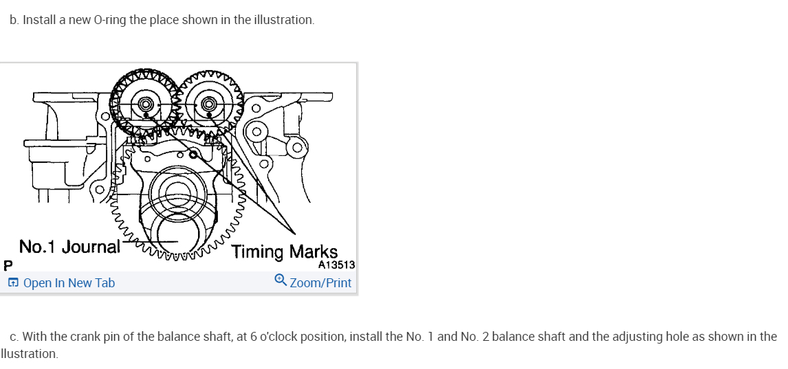

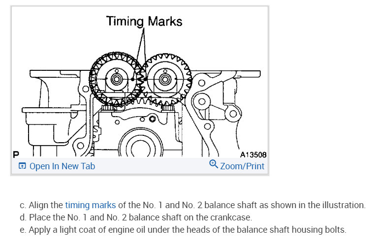

With the motor at top dead center the balance shaft assembly should line up like this, doing the same job right now

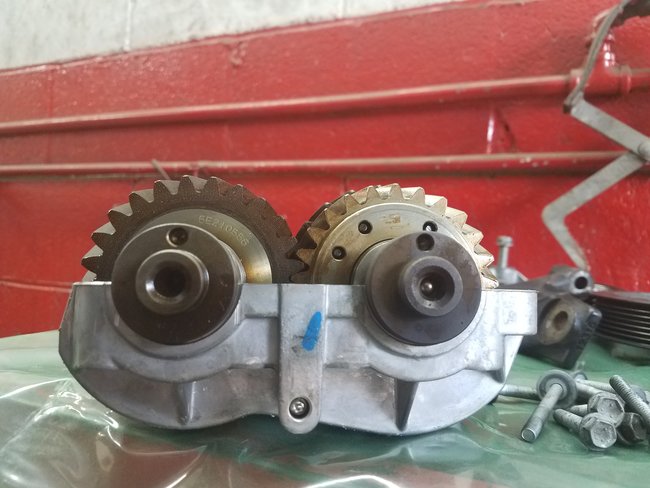

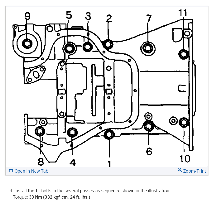

Driving the camry, started to hear a clicking noise, sounded internal engine but was not sure. This went on for about two weeks, as this is my daughters car. Then driving the car on interstate, noise got louder, cruise control caused trans to up shift, higher rpms, then boom. Got it towed, only tried to start once before tow truck arrived, noticed no oil pressure. Finally got around to removing the oil pan, found balance shaft gears broken and bearing spun, damaging the upper oil pan. So, now I have a used upper oil pan assembly with the balance shafts, from a salvage yard. I have heard of some type of timing that needs to be done and other things, I was looking for procedures, and difficulty. I am a mechanic, but with diesel engines, never seen balance shafts before. Should this be a job I should tackle, or get professional help. I can follow instructions, just not real confident on this job. I removed the bad balance shafts but not the upper oil pan, and I know the upper oil pan will have to be replaced because the balance shaft bearings caused damage to casting. Thanks for your help. Martin

The balance shafts are not to bad once you have the instructions which I have found for you int he diagram below. Check out the diagrams (Below). Please let us know if you need anything else to get the problem fixed.

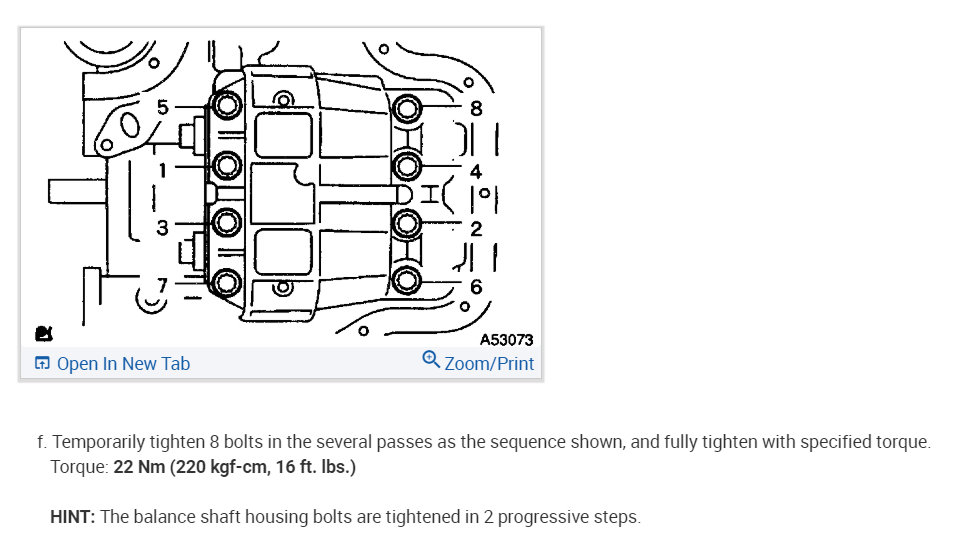

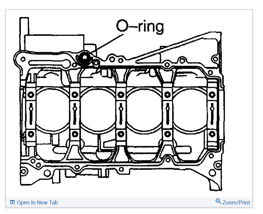

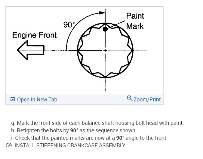

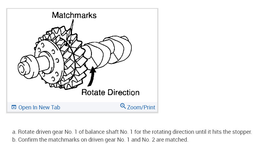

HMAC300
  • 48,601 POSTS

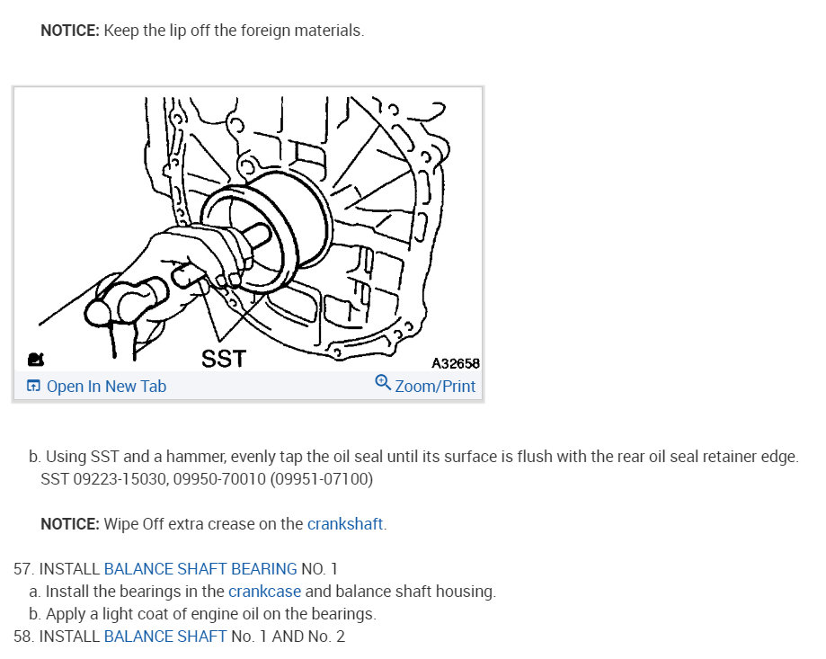

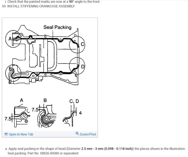

There is no procedure listed for replacement of the upper oil pan.
I had to replace upper oil pan on this 2.4L.
The customer had bottomed out on the street and the aluminum oil pan broke at the
area where the engine mount attaches to the oil pan.
Front of engine by the right axle.
To replace just the upper oil pan.
1) Remove Valve cover.
2) Remove Lower oil pan.
3) Remove Timing Cover.
4) Remove Oil Pump gear and chain, then oil pump.
5) Remove upper oil pan, 11 Bolts, one bolt is hidden in oil filter housing. See attached picture.
If you plan on replacing the rear main seal, you will need to remove engine from car.

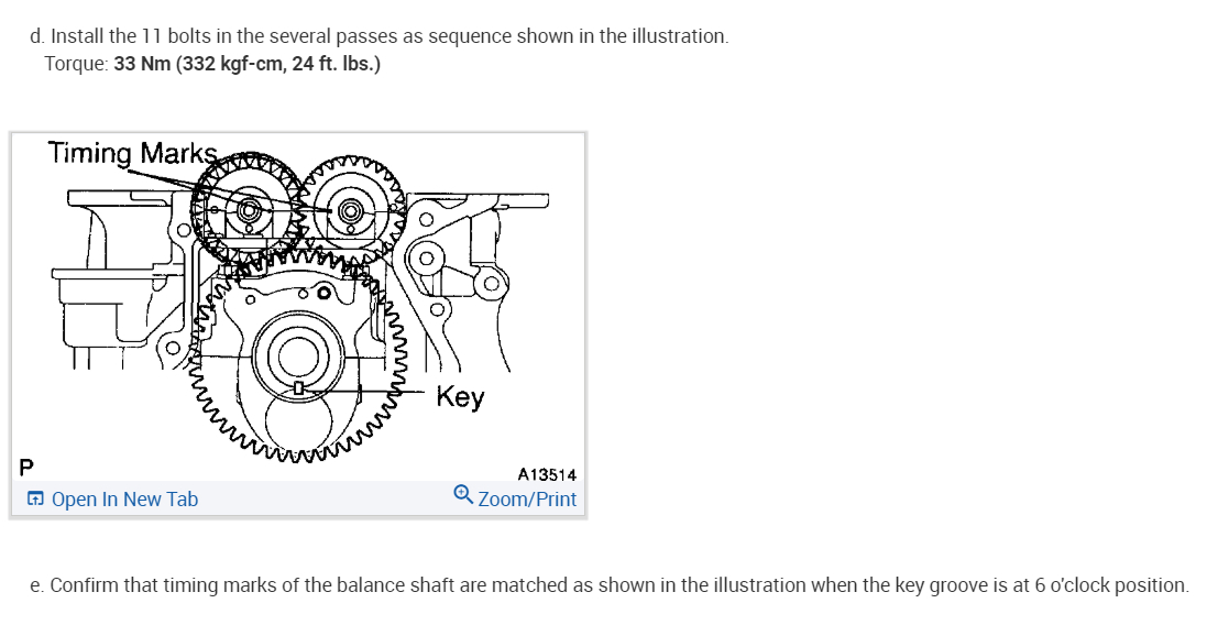

Notes: There is an updated Balance shaft assembly.
The Balance shafts are driven by a gear on the crankshaft.
The drive gear on the crankshaft has 50 teeth and the balance shafts have 25 teeth.
The Toyota dealership near us, estimates this repair at 22 hours including rear main seal.
To set up the balance shafts engine at T.D.C. #1 Compression. See Fig #169. And attached pictures
