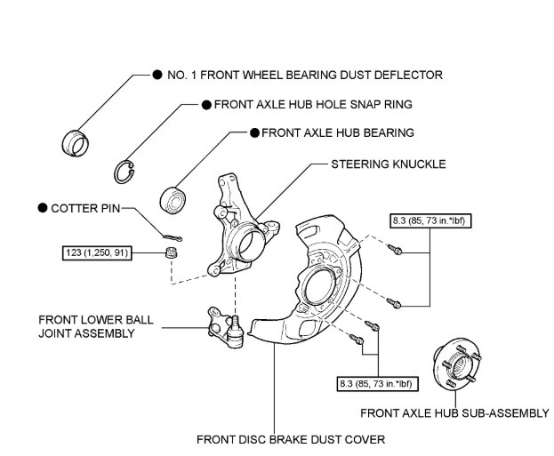

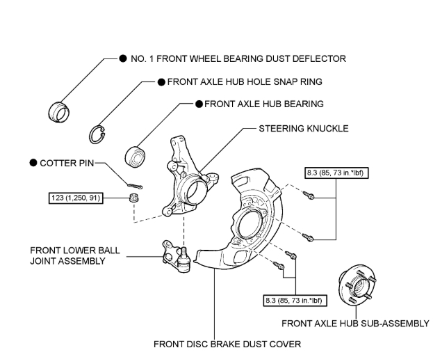

Geeez, you are not kidding, I would remove the front wheels to make sure the brake calipers have both of there mounting bolts on them and that the brake pads are in good shape. Also, make sure the rotor dust shields are not touching the rotor. If they are okay I would replace the bearing hubs. Please upload a video of what you find so I can help confirm the issue, thanks for the video, it helps. Here is a guide to help raise the front of the car and remove the wheels:
https://www.youtube.com/watch?v=xLFn_bMkZc0
and
https://www.2carpros.com/articles/wheel-removal-and-re-installation
Here is how to replace the bearing hubs, they will need to be pressed out. Check out the images (below). Please let us know what happens.
