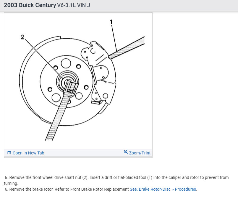

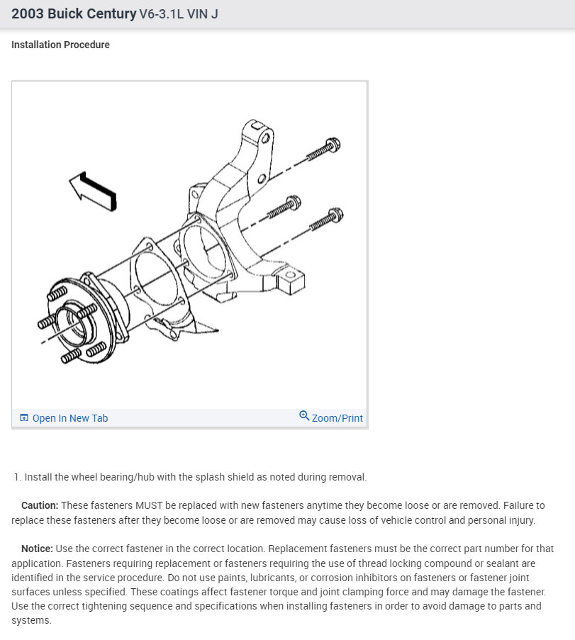

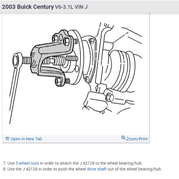

Started hearing a loud noise from the driver's side front wheel. Did some research, jacked up the front end, and discovered a little bit of play when shaking the wheel at 9 and 3 o'clock. No play at 12 and 6 o'clock.
My question is: Do I replace the wheel bearing or hub assembly? I'm really not sure which part would solve my issue. Thank you for any advice on this matter!
Feb 26, 2022 at 3:25 AM
SQM
  • 6,383 POSTS

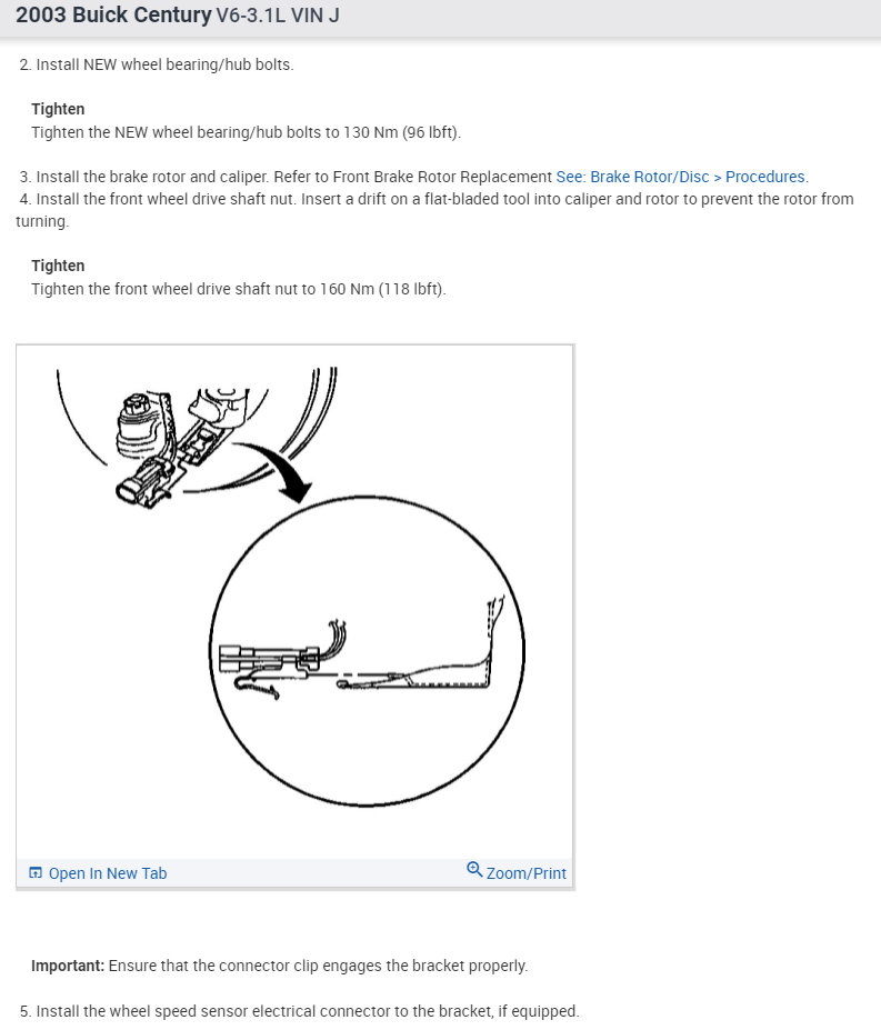

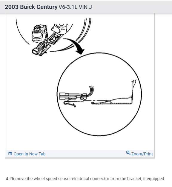

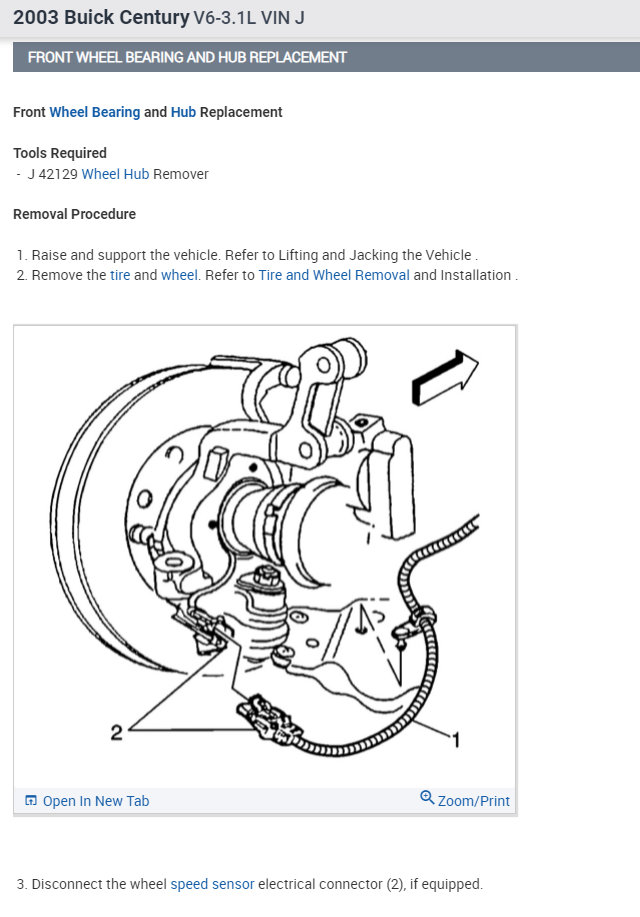

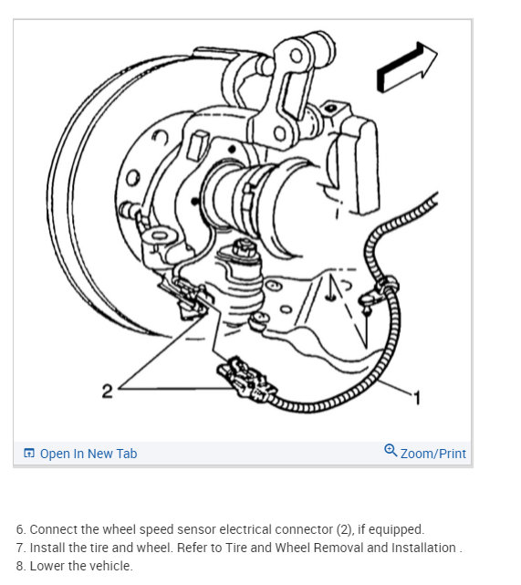

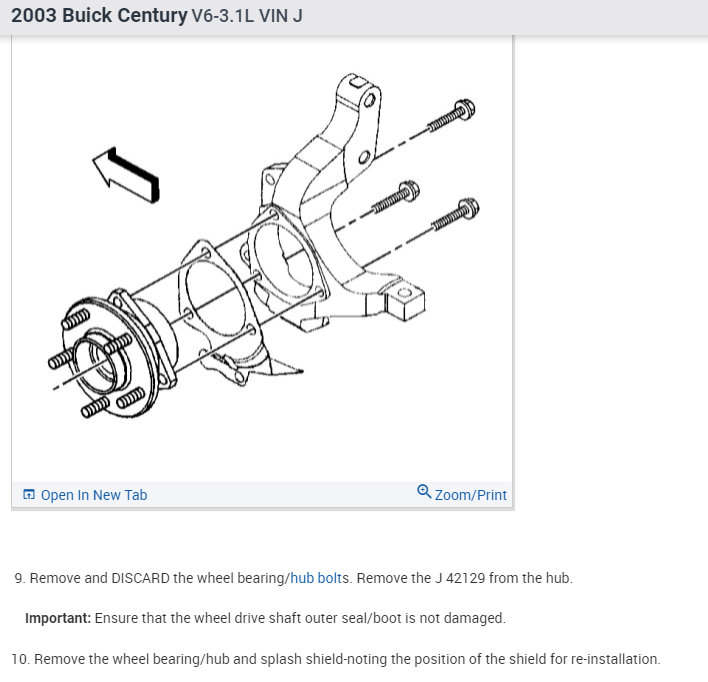

Does it make humming noise while driving? Also does the noise frequency and volume increase with speed.
Typical bad wheel bearing will make a humming noise and it will be speed sensitive.
On this vehicle the wheel bearing, and the hub assembly comes as a single unit and gets replaced as one.
Here is a helpful guide:
https://www.2carpros.com/articles/bearing-hub-replacement
I have attached replacement procedure below.
