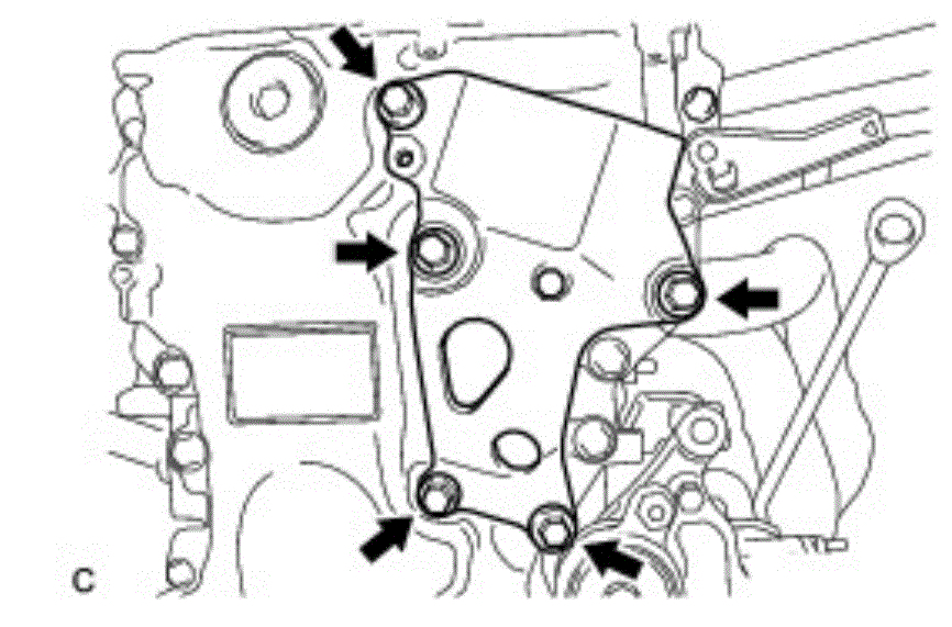

Hello, the vehicle engine do produce noise for some seconds when started in the morning or whenever the vehicle is cooled. I knew that the problem is that the oil pump is not pumping as early as possible cause friction to occur in the moving parts. I have changed the engine oil and filter the problem still persist. How can it be fixed?
Sep 18, 2020 at 4:54 PM
Good morning,
Can you upload a video of the noise so I can hear if it is lifters on the top end or bearings on the lower end of the car.
Good chance it is the pump as the internal check valve may be bleeding off and draining the oil passage of all oil.
Worse case scenario is that the main and rod bearings may have too much play causing the noise.

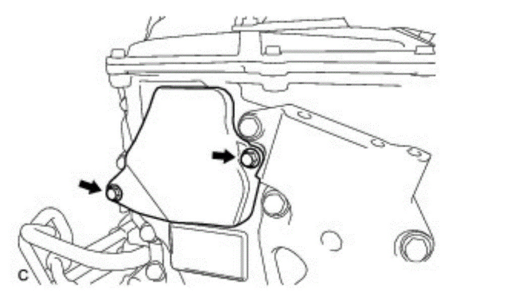

Remove no. 2 timing chain cover
Remove the 2 bolts and no. 2 timing chain cover.

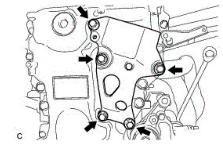

Remove engine mounting bracket rh
Remove the 5 bolts and engine mounting bracket rh.

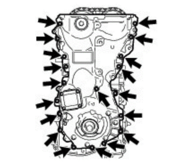

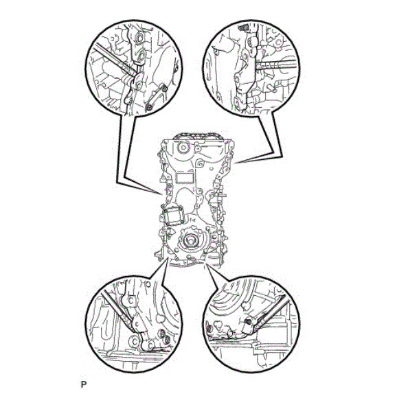

Remove timing chain cover sub-assembly
Remove the 17 bolts and 2 nuts.
Remove the timing chain cover by prying between the timing chain cover and cylinder head, camshaft housing, cylinder block and stiffening crankcase with a screwdriver as shown in the illustration.
NOTICE:
Be careful not to damage the contact surfaces of the cylinder head, camshaft housing, cylinder block, stiffening crankcase or chain cover.
HINT:
Tape the screwdriver tip before use.
Remove the 3 gaskets from the stiffening crankcase.

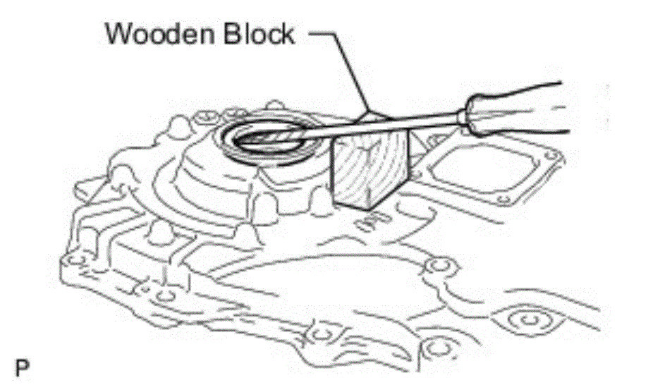

REMOVE TIMING CHAIN COVER OIL SEAL
Using a screwdriver and wooden block, pry out the oil seal.
NOTICE:
Do not damage the surface of the oil seal press fit hole.
HINT:
