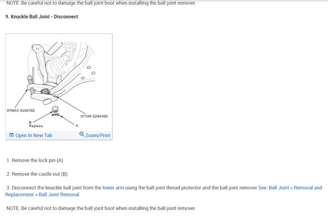

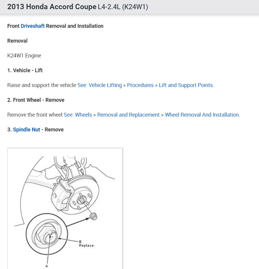

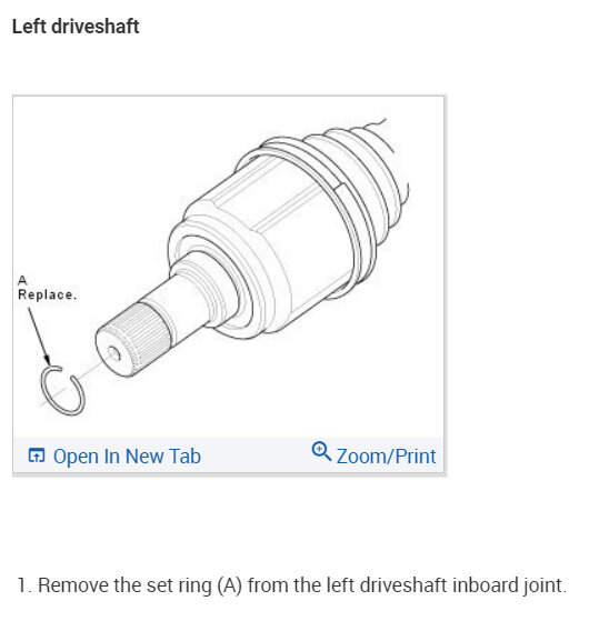

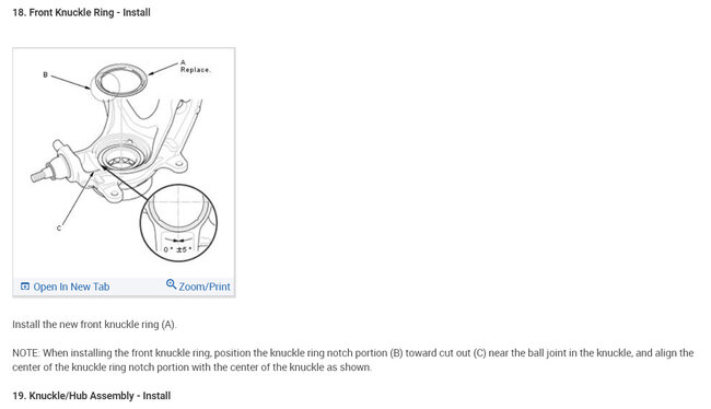

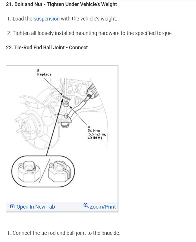

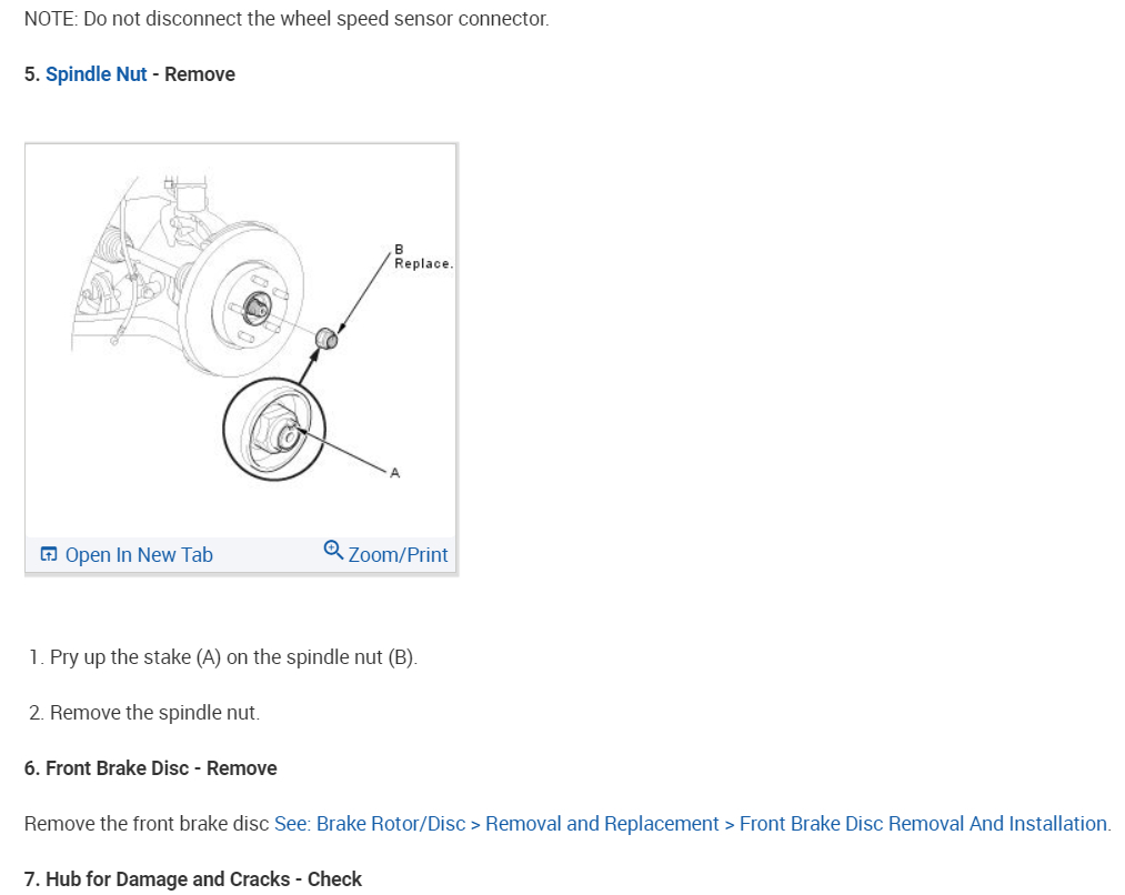

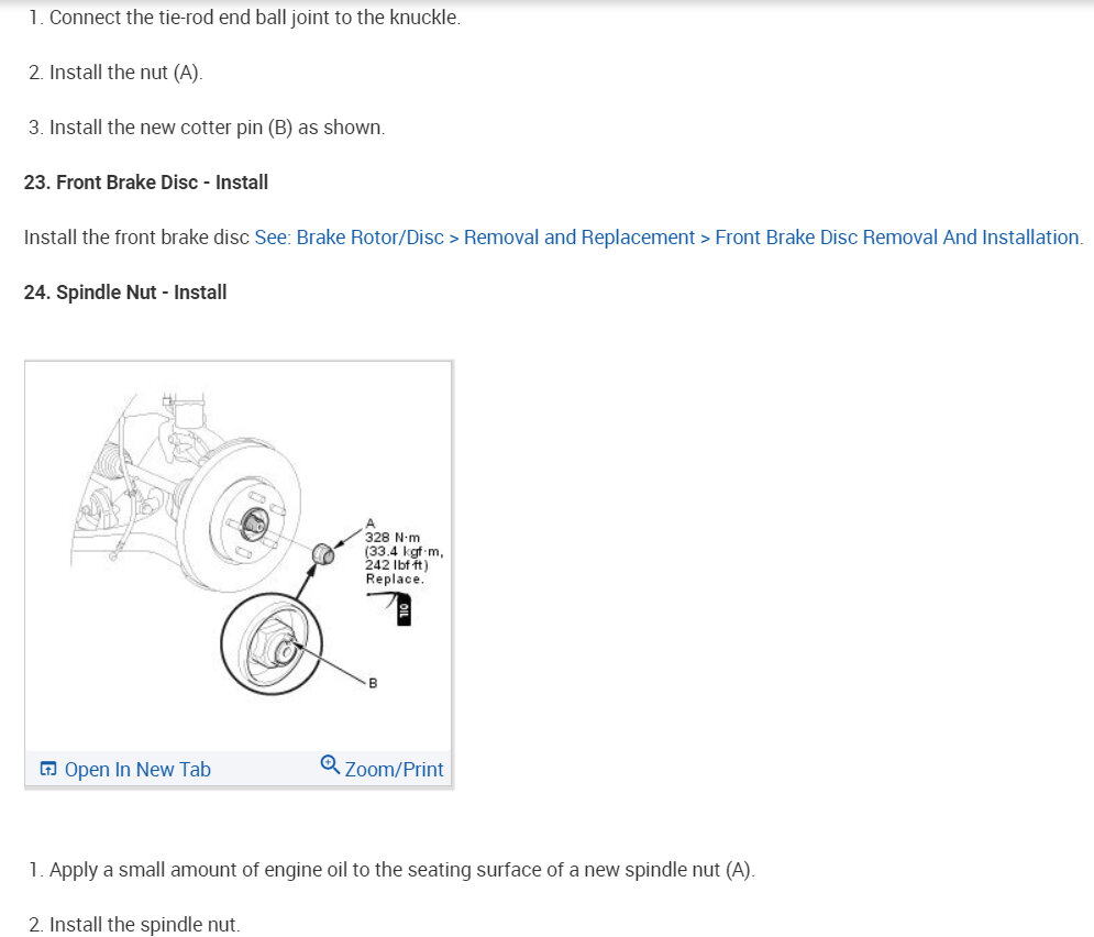

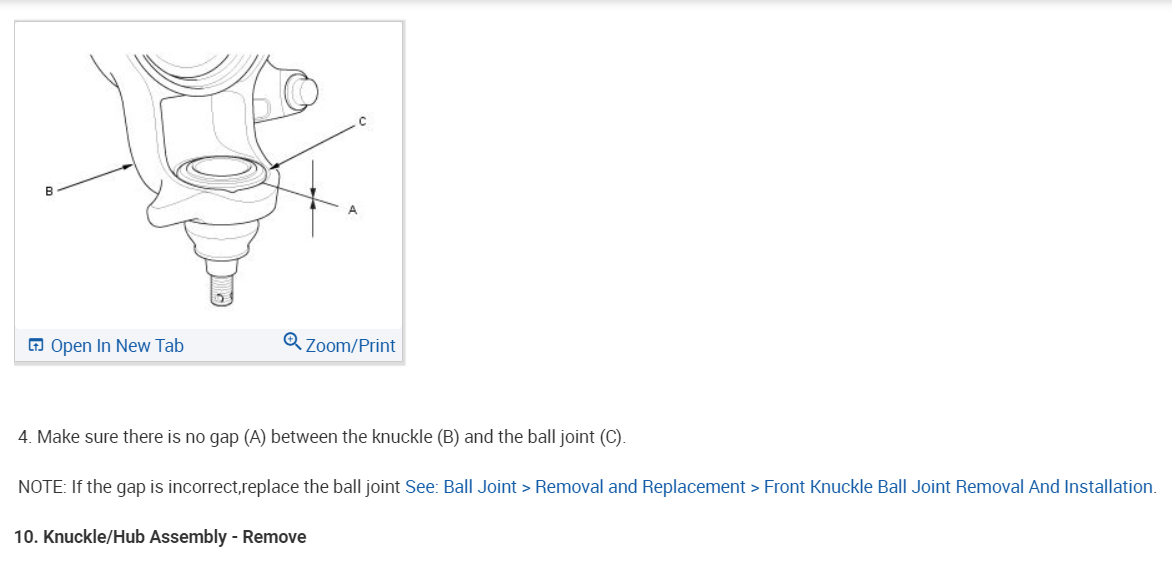

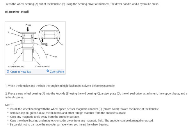

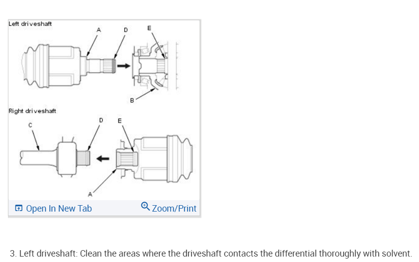

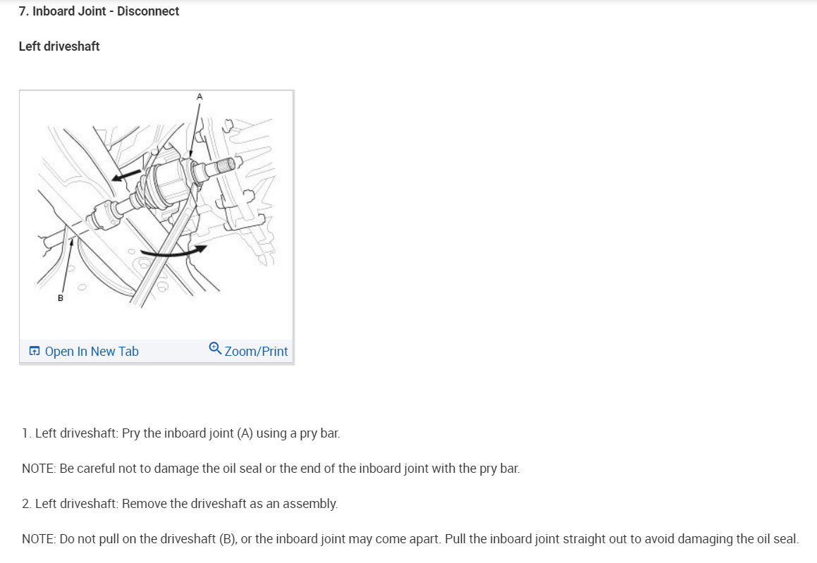

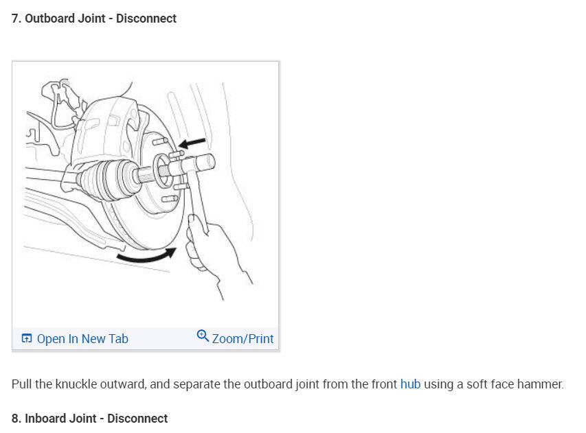

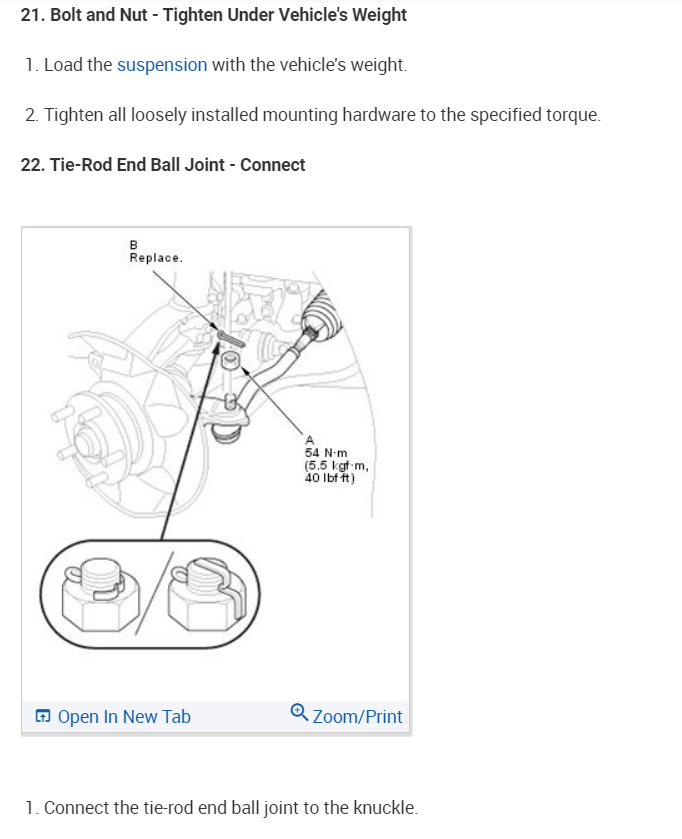

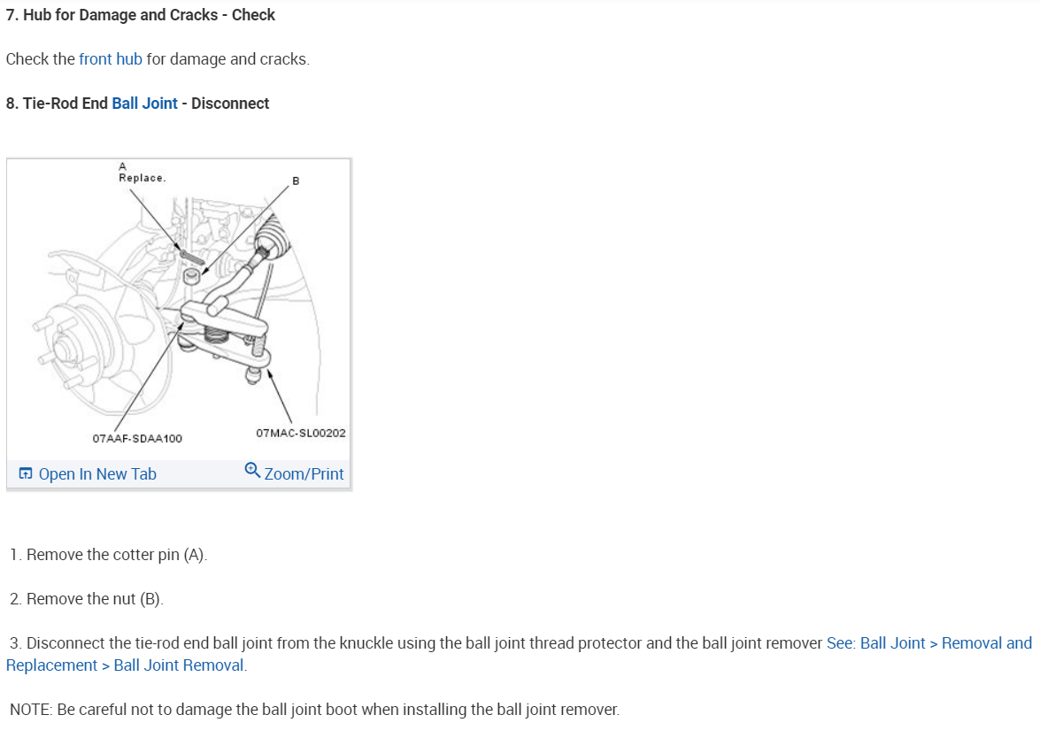

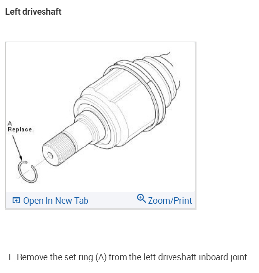

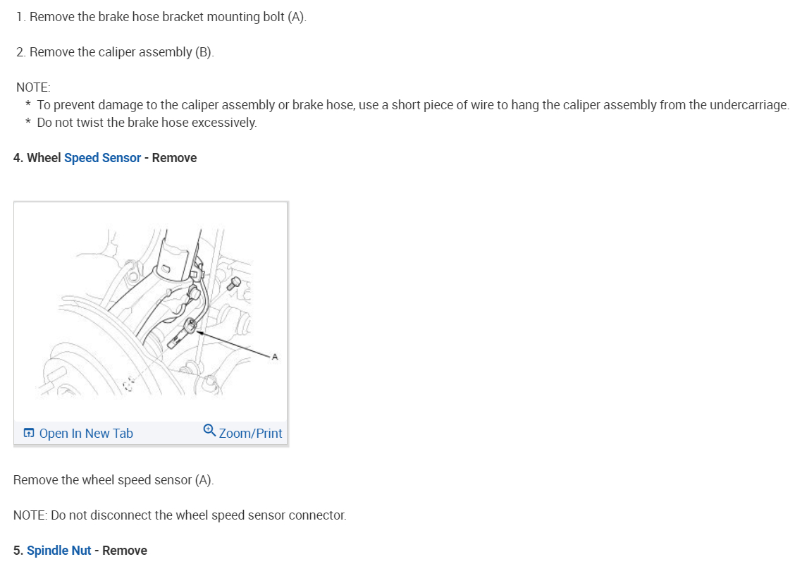

It sounds like to me the CV axle is worn out but can you please shoot a quick video with your phone so I can hear the noise? that way I can tell for sure what's going on. You can upload it here with your response. Here is a generic guide to help you step by step with instructions in the diagrams below to show you how on your car:
https://www.2carpros.com/articles/replace-cv-axle
Aug 16, 2023 at 9:25 AM

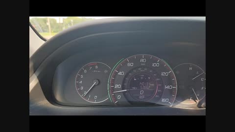

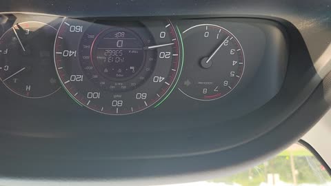

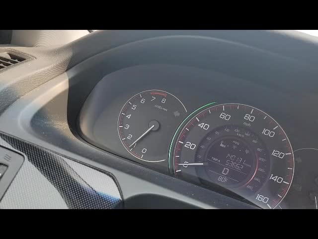

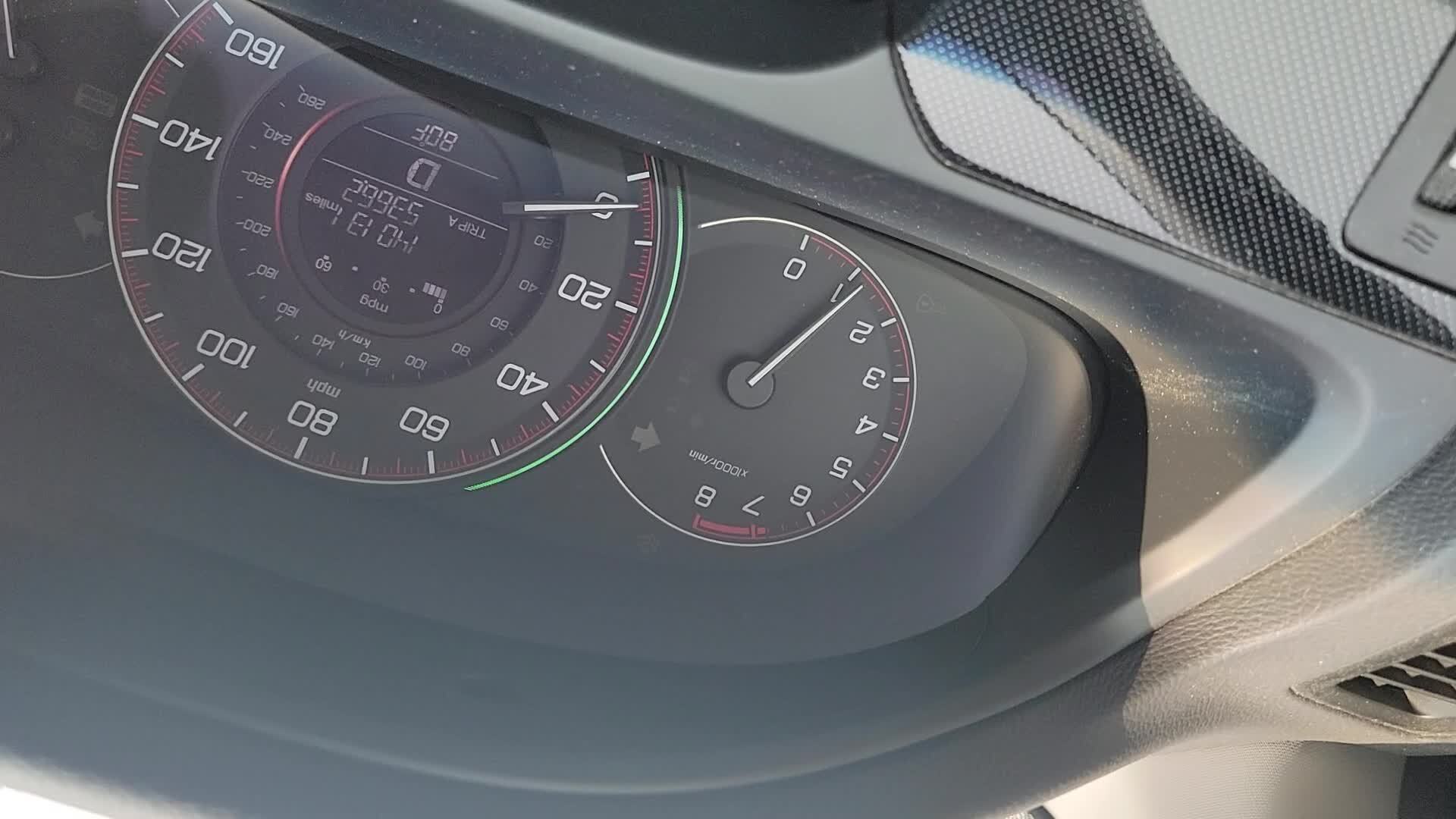

Update. I put a used left cv shaft in changed fluid again and no change in noise, attached is the video and notice on video I downshifted and no change in noise. I think it's something in the transmission because it took out the left bearing and ball joint and right side was fine. The guy on software update was that September of 2023. Looking for any other suggestions before i sell it. Thanks everyone!

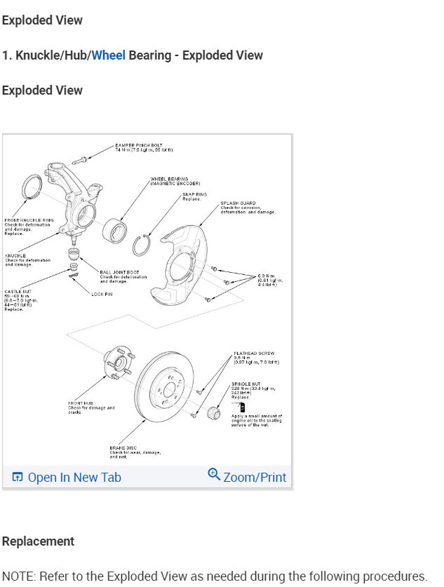

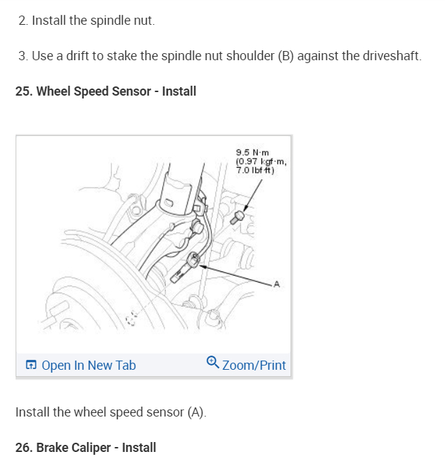

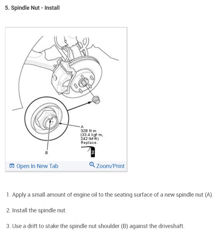

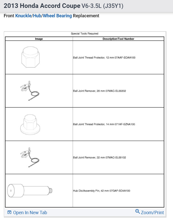

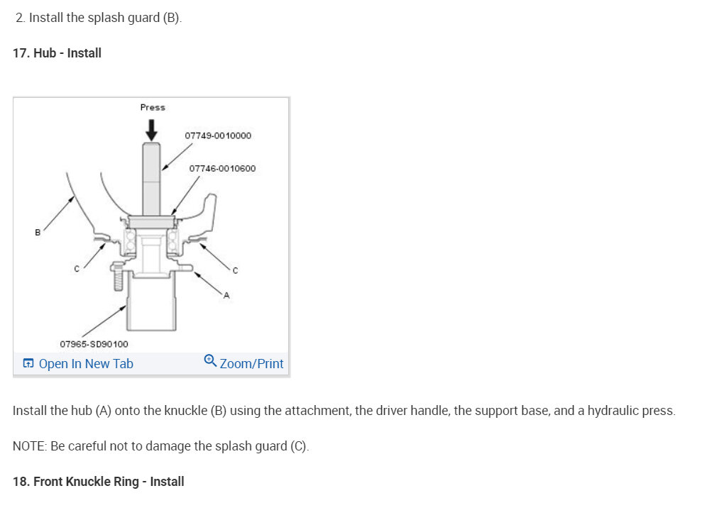

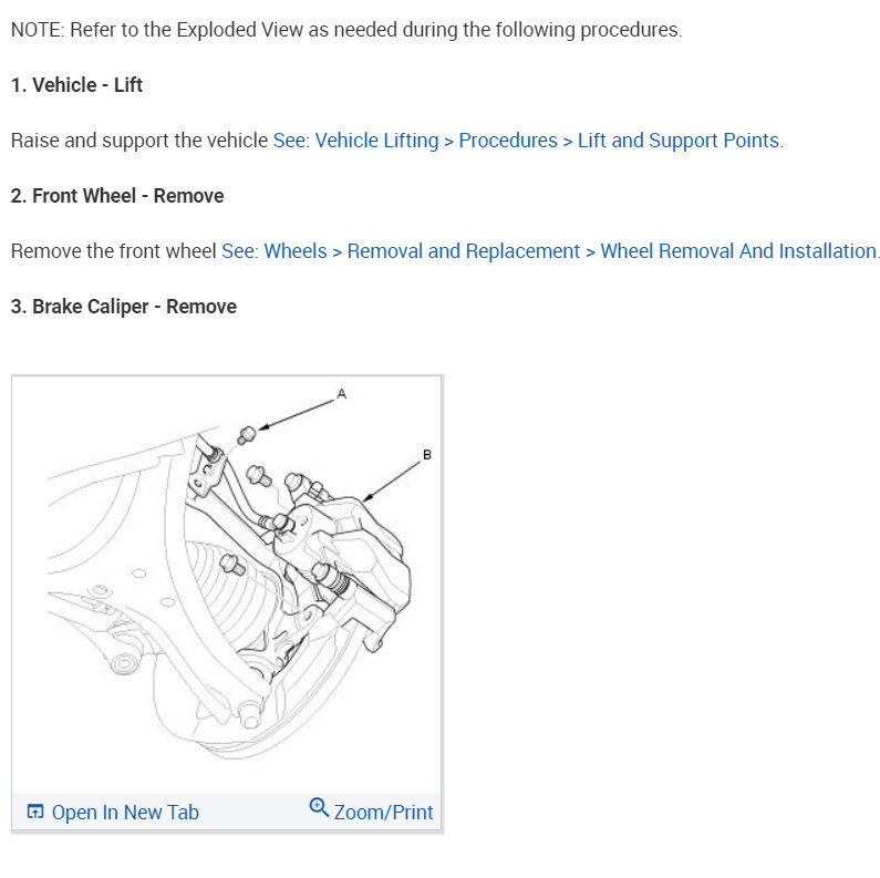

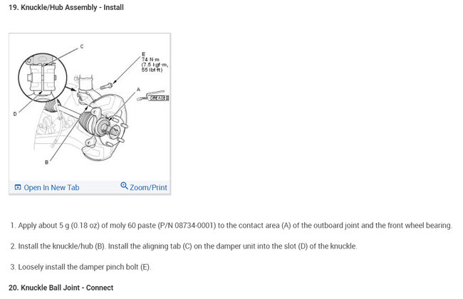

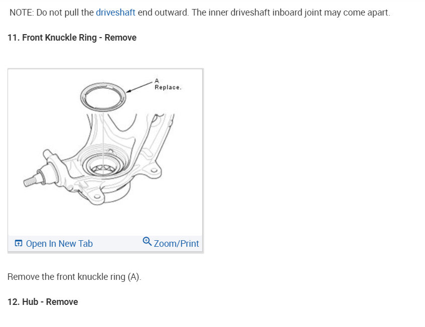

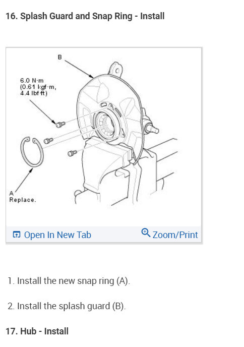

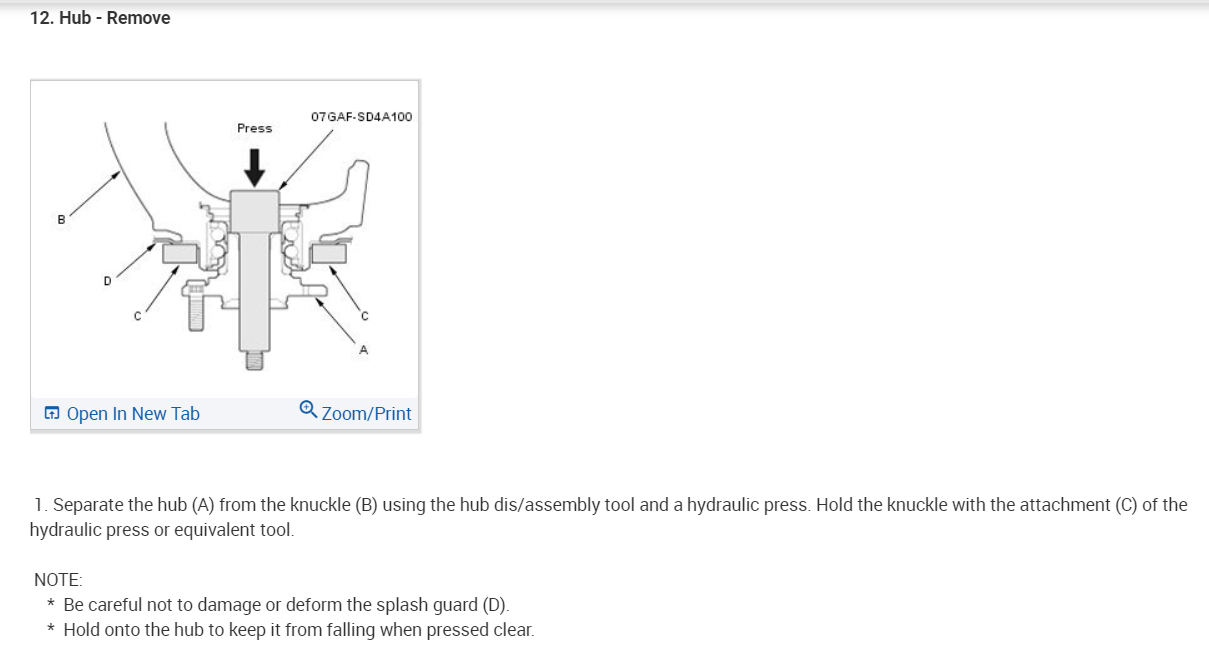

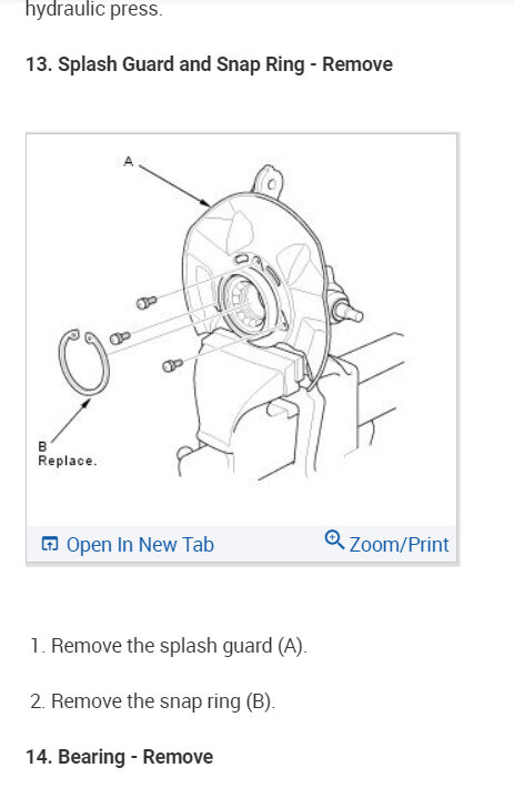

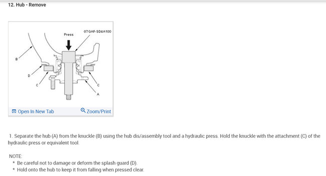

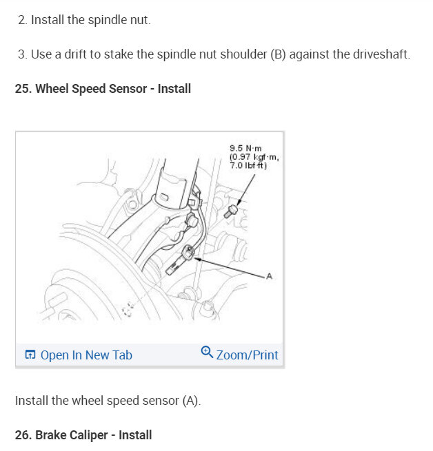

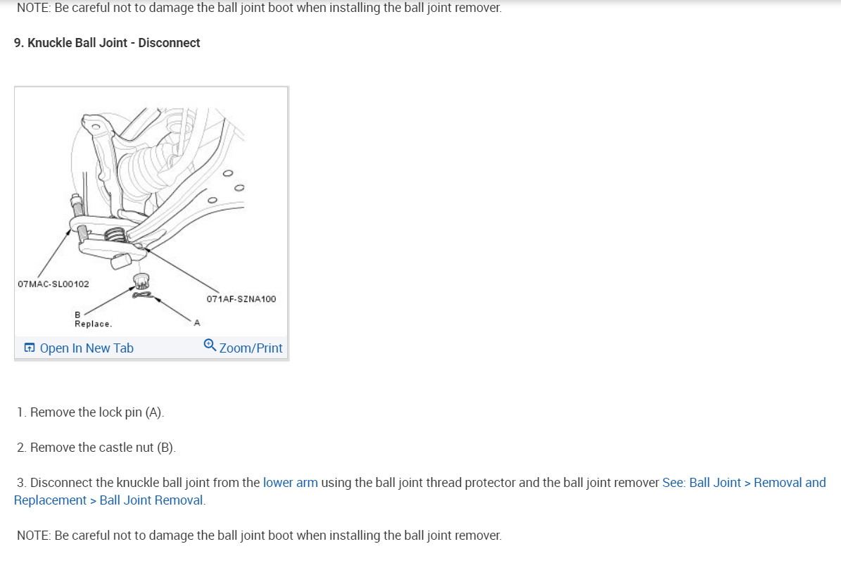

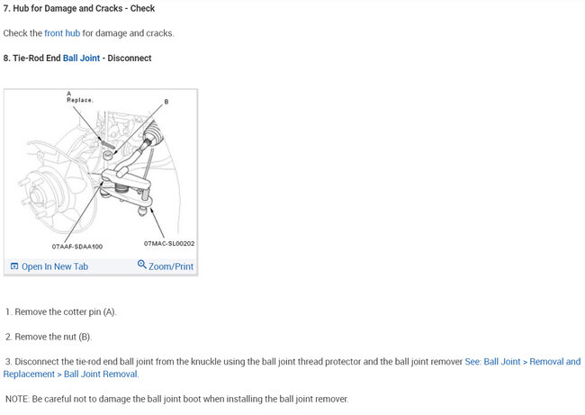

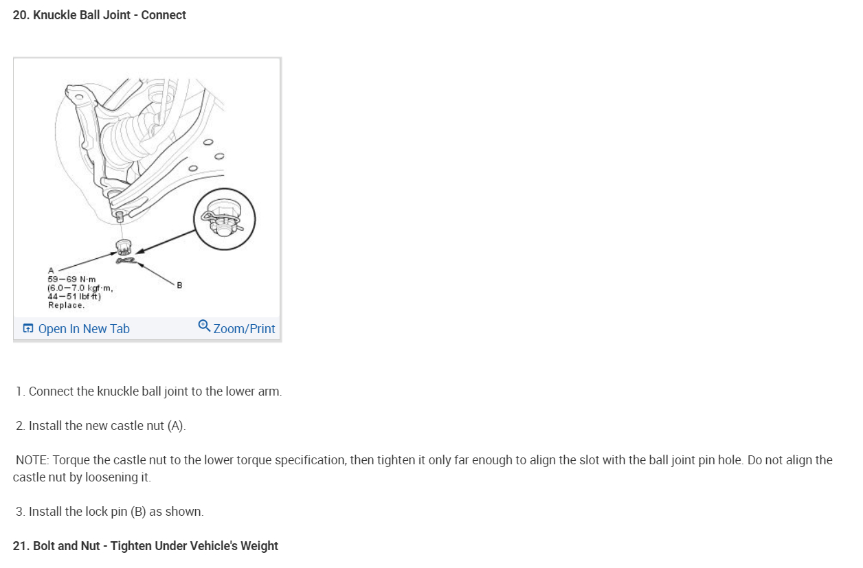

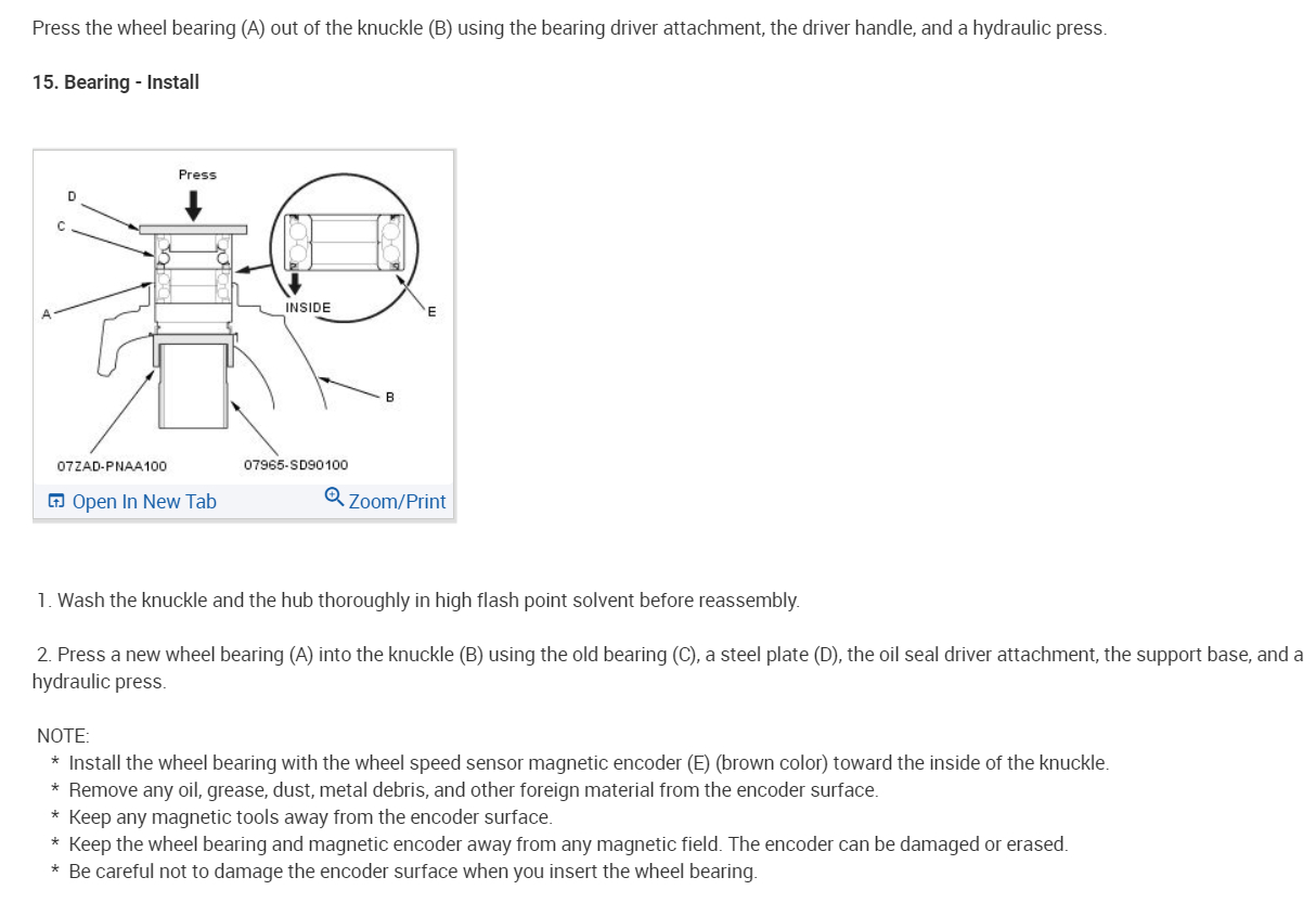

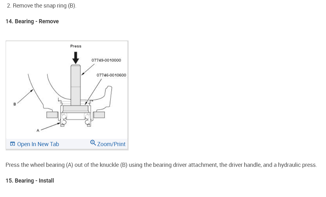

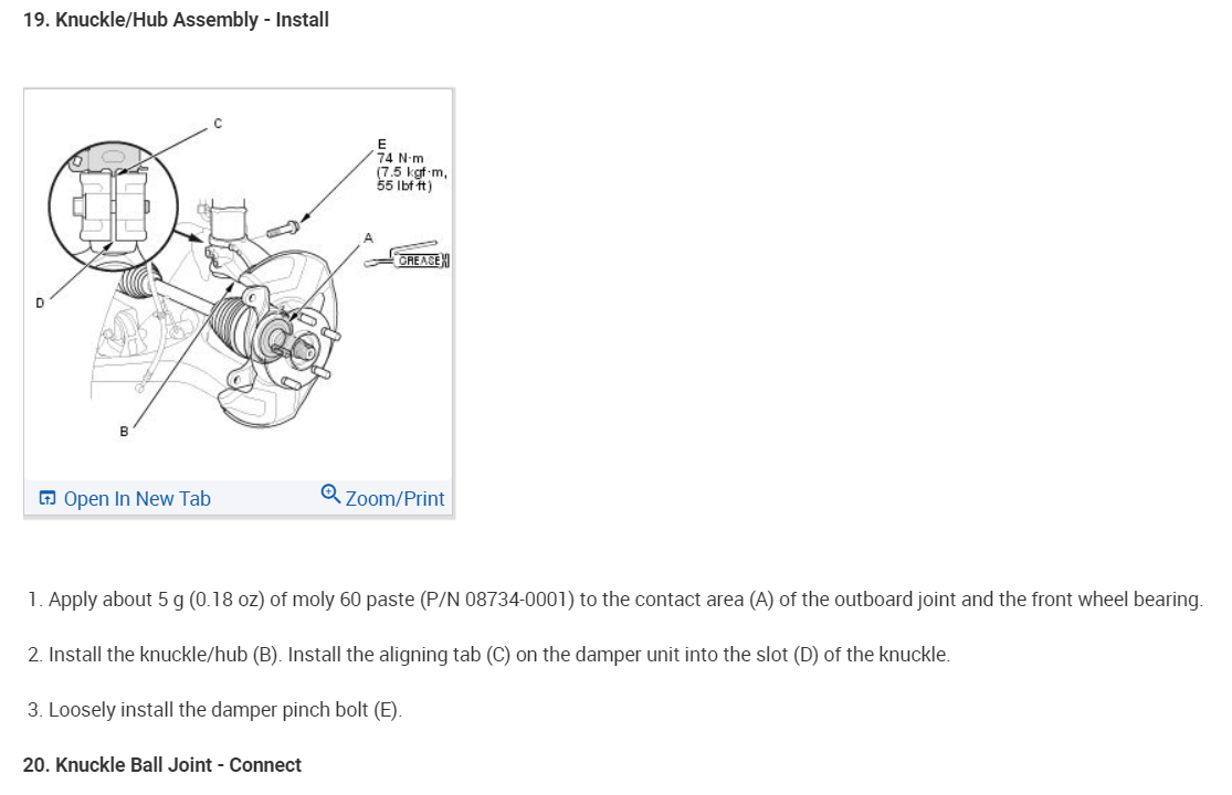

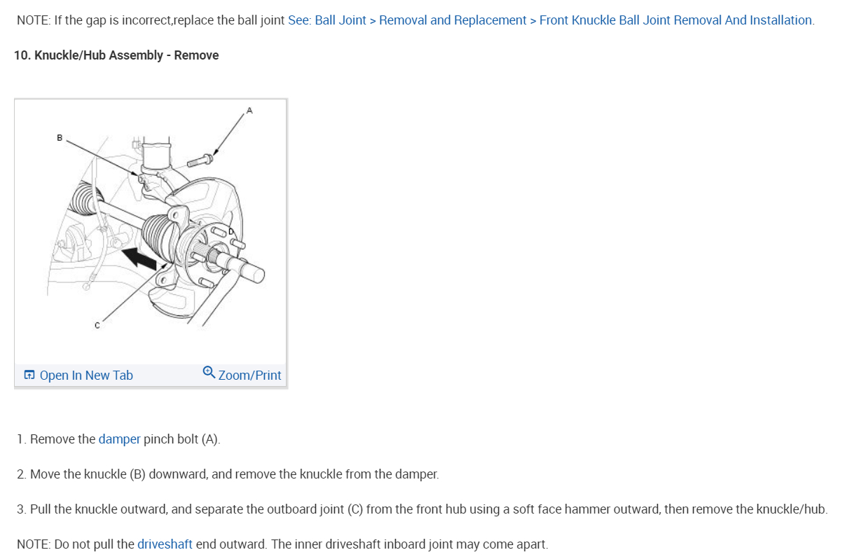

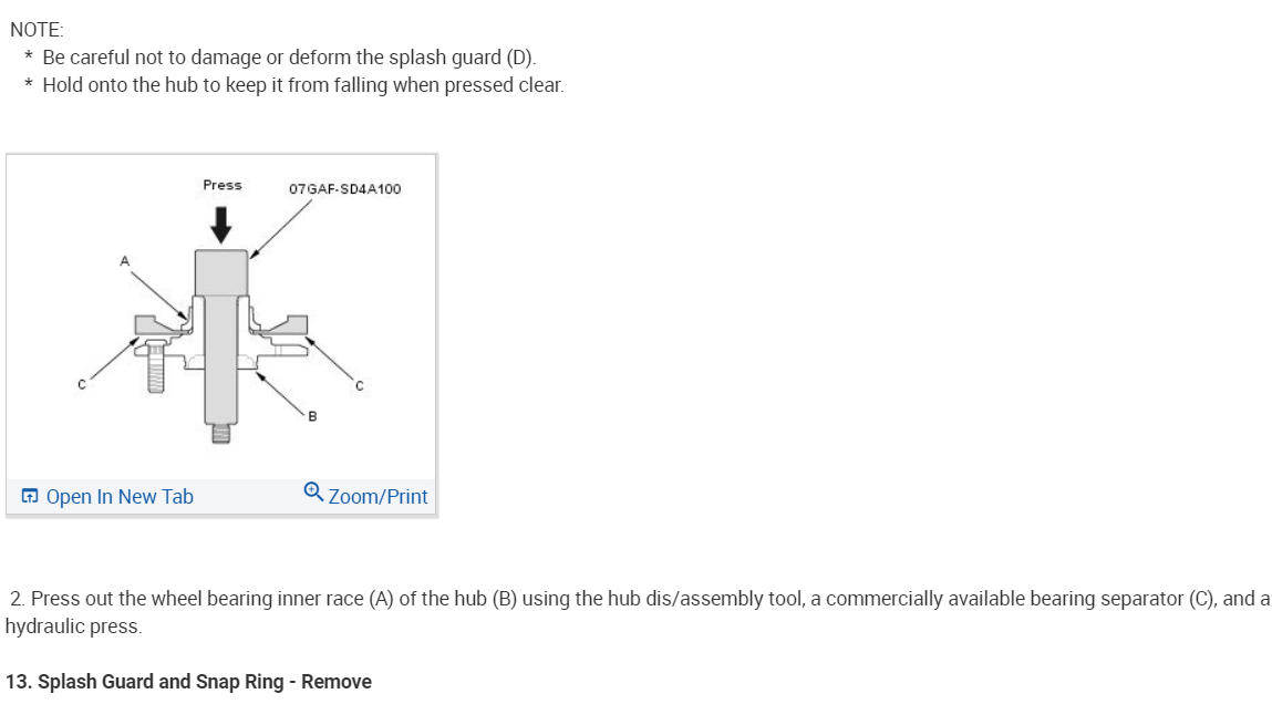

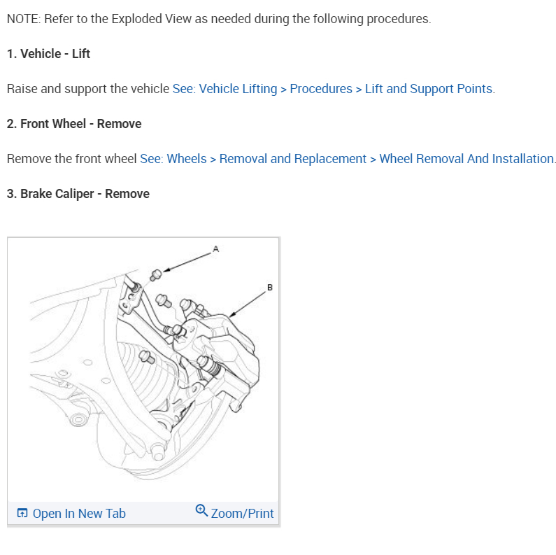

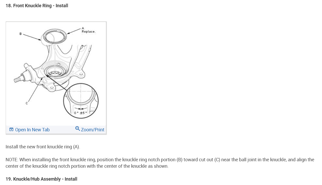

Thanks for the video, this sounds like the bearing hub has gone bad, I would do both here is a how the job is done. This video shows how to use the bearing press, but you can drop the spindle off at an automotive machine shop and they can do it for you.
https://youtu.be/_FzmmBoa4Tg?si=fDj5jAbhM-1xZWA3
Sep 9, 2023 at 2:47 AM

Hi, Update. I put a used left CV shaft in changed fluid again and no change. attached is the video and notice on video I downshifted and no change in noise. I think it's something in the transmission because it took out the left bearing and ball joint and the right side was fine.
Looking for any other suggestions before i give up. So far, I've replaced both, Front strut assembly, Steering Knuckles used, Front Stabilizer links new, left and right axles used and center axle bearing new. Changed CV fluid twice this month with the correct fluid. None of this has improved the noise.
I'm going to hook my Steelman Chassis Ears every place I can think of for a noise. I'm 70 now and this will be my first car I haven't been able to fix since I was 16 except tires and frontend alignments.

Don't worry about the scanner, it sounds like a bearing hub is bad. I would lift the front of the car and grasp the front wheels and try to move them side to side to see if there is any play, this should tell you if the bearing is bad. Thanks for the video.
