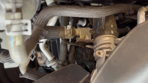

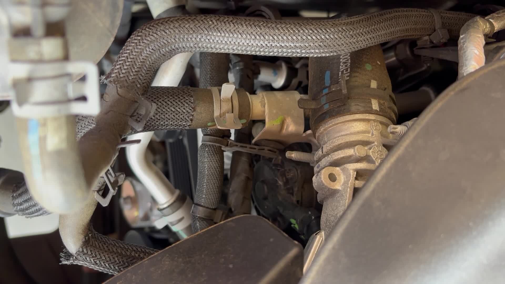

SKOOTER28
  • 98 POSTS
Looking for hot spots.
Apr 22, 2025 at 3:29 AM
  • 55,214 POSTS
If there are hot spots that is a good sign that the compression is bad. please go over this guide to help walk you through the steps:
