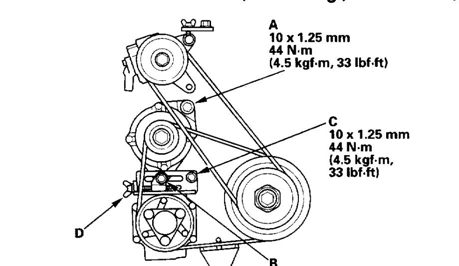

It sounds like a belt issue. Is it possible for you to record and upload it for me to hear?
There are two belts on this vehicle, so one may be loose. See pic below.
Let me know which one was replaced and if you have checked for tension.
See pic below.

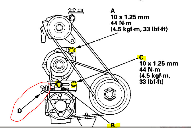

  • 110,248 POSTS
Is the belt in good condition? If it is, chances are it needs tightened. I attached a pic below. I highlighted 3 bolts that you will need to loosen (not remove). One they are loose, the nut that I circled in red needs to be tightened.
When you tighten it, there should be approximately 1/2-inch movement up and down at the belt.
Try this and let me know if it resolves the problem.
See pic below.
