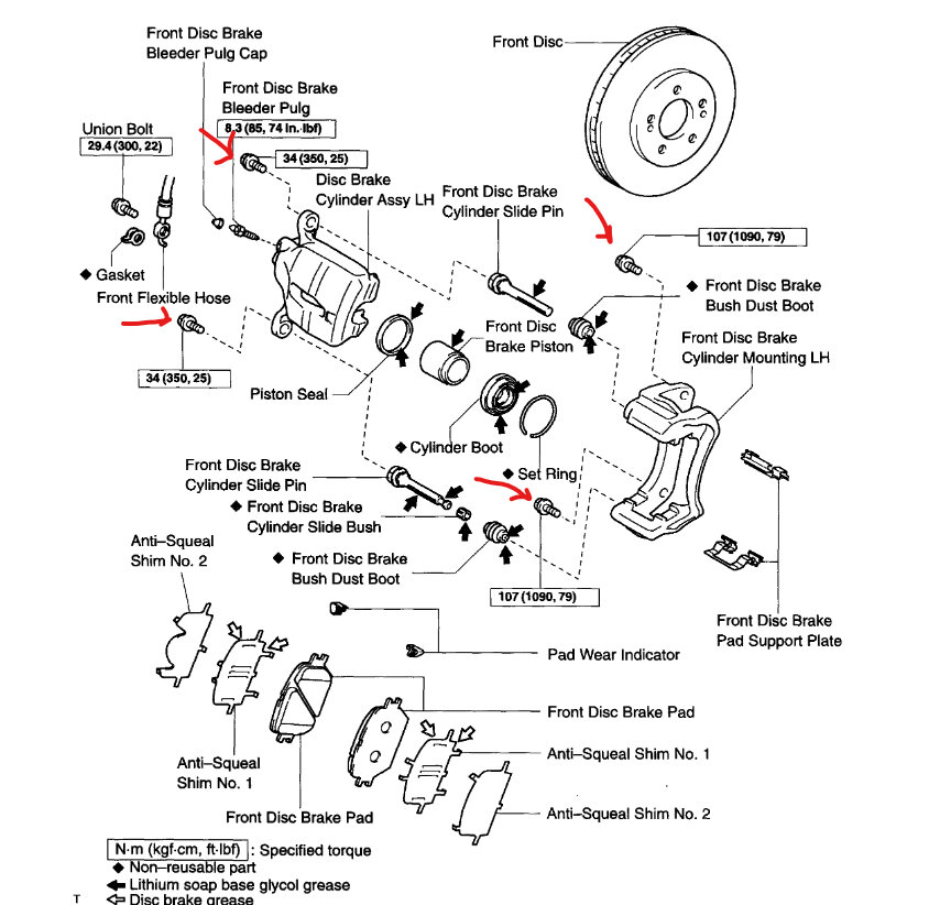

Hi, I have the car listed above le 2.4 liter. I had my passenger side CV axle and wheel bearing replaced a few months ago. Well, yesterday once I was driving for about a half hour or so and I got into a town I started hearing a weird clunking noise. It stops when I press the brakes. And it only happens when I'm driving in town not on the freeway. But it gets louder as I'm slowing down.

Please stop driving the car, it sounds like one of the front brake calipers mounting bolts has fallen out. I would remove the front wheels for inspection, here is what I am talking about in the images below and these guides can help you raise the front of the car and remove the wheels to see what's going on:
and
https://www.2carpros.com/articles/wheel-removal-and-re-installation
Check out the images (below). Please upload pictures or videos in your response of any problems so we can see what to help you with.
