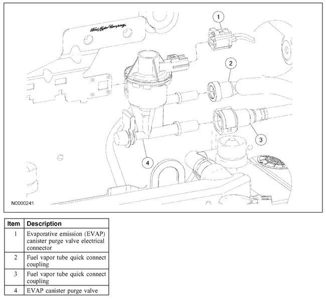

There is a gargling noise and tapping noise coming from the back on the same side as the gas cap any ideas?

Is this sound there while driving or sitting still?
Feb 11, 2020 at 11:56 PM
ZELLYBEAR1990
while sitting still.
Feb 12, 2020 at 4:37 AM
BMDOUBLE
  • 1,139 POSTS
I've had issues with the purge valve on these trucks. The purge valve is responsible for pulling vapors out of the fuel tank and introducing them to the engine for combustion and evaporative emissions purposes. The valve will get stuck open and cause a continued vacuum on the fuel tank and on certain vehicle can actually cause the fuel tank to collapse like a soda can. Very very common and very very easy to replace!
