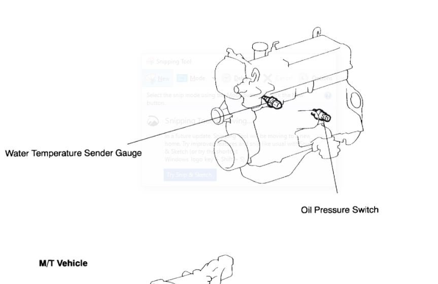

You have an issue here that concerns me. What I believe is happening in the oil pressure is going too low when it warms up and the timing belt tensioner runs on oil pressure. If it does not have enough pressure, the belt will slack up and it will slap the timing cover.
https://www.2carpros.com/articles/how-a-timing-belt-works
What you need to do is have the oil pressure tested manually to be sure it is correct. You need 20 pounds at a hot idle and 40 pounds at 1,200 RPMs. The oil pressure sensor needs to be removed and a manual gauge installed for this test.

Hmm, good point, but wouldn't i have issues with the lifters and they would tick if the pressure is low? Have not looked at the tensioner as it is buried in, don't know if it's old or new or whether it has been replaced too. Is the oil pressure tested the same as fuel pressure tester gauge? Or vacuum gauge? Can either be used?

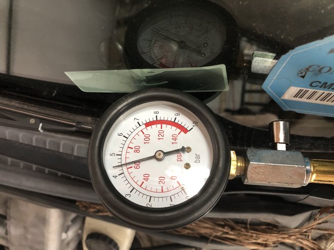

NASER NASER
  • 836 POSTS
So when you first start it pressure is at 60.
Jan 30, 2021 at 1:32 AM
NASER NASER
  • 836 POSTS
At 3,000 RPMs it's 70.
NASER NASER
  • 836 POSTS
After she has gotten warm its also around 55 if i pit it in gear so at its lowest RPM the pressure is 42.
Jan 30, 2021 at 1:37 AM

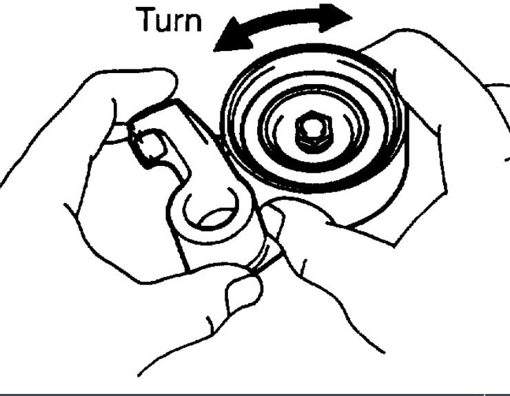

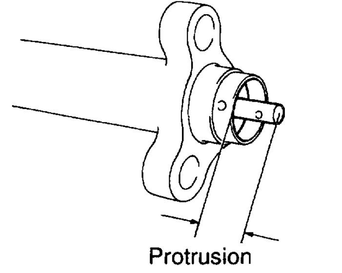

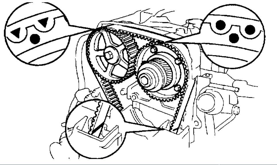

I would check the timing belt tension to be sure it is not too slack.

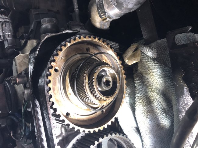

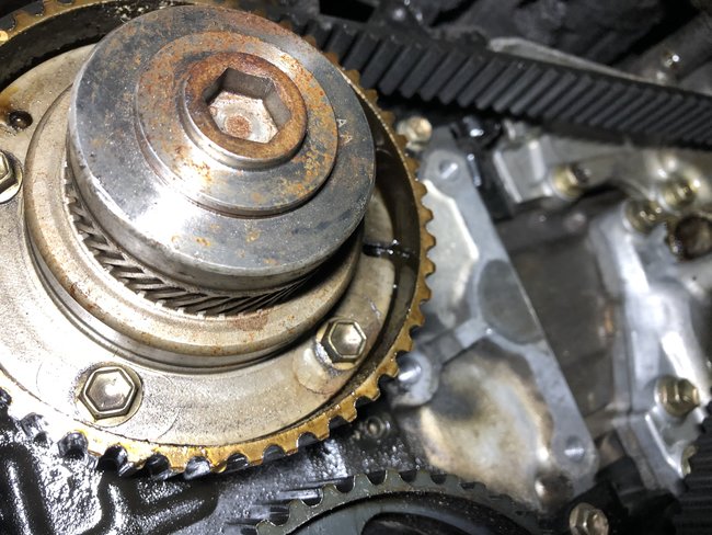

1/2 need your opinion.
Feb 1, 2021 at 1:39 AM
NASER NASER
  • 836 POSTS
2/2
Feb 1, 2021 at 1:41 AM
NASER NASER
  • 836 POSTS

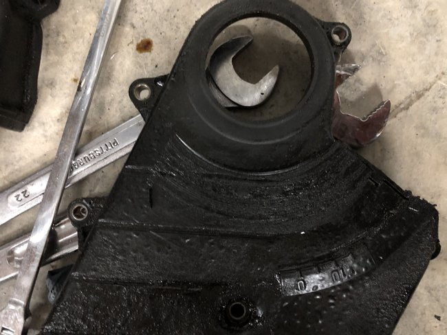

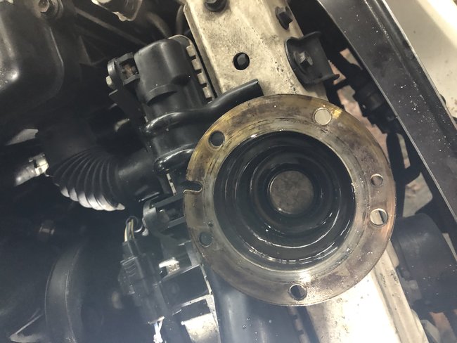

Removed the pulley and cover and ran it, no noise, am almost leaning toward the plastic cover rubbing, also there was a lot of oil in the area, cleaned it out and and ran it and saw oil on the right side pulley, must be coming from behind the pulley, the seal. how easy is it to replace it?

Bad harmonic balancer, rubbing against cover.
Feb 1, 2021 at 4:12 AM
Good find.
Remove the gear and the seal is right there.

You ever replaced the seal behind this VVT gear? Ordered one off of eBay which is OEM but it is so difficult to install, even if i stretch it and hold it in place it slides off of the grove because it isn't deep.
Feb 24, 2021 at 7:29 AM
I used a socket that was the exact size of the seal and lightly tapped it in.
They do make a tool for it but only the dealer sells it.

Yes, i tried things similar in size before but none was same size, if the can pulley was out would have been easy. Cut the ring and installed it then added a film of thick silicone and let it dry overnight then put it together. all good. Thanks for your help.
