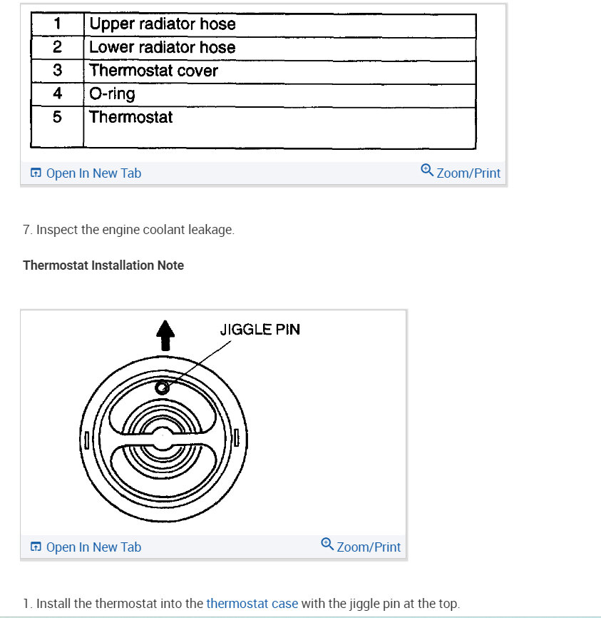

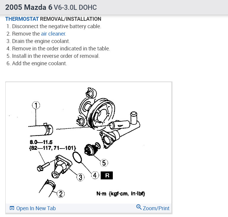

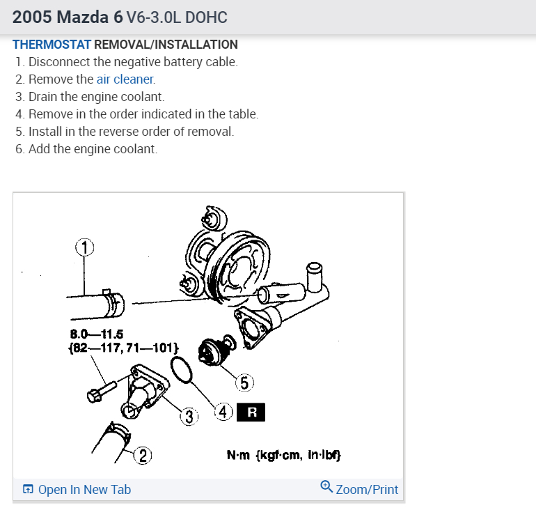

I replaced water pump started the car and it seemed fine, about ten minutes later a boiling sound started coming from the water reservoir.

This can happen when the thermostat sticks closed. Also, double check the coolant level to make sure it is full. This video will show you how and I have included a guide and instructions for your car in the images below on how to change out the thermostat.
https://youtu.be/GSE9skKnOgY
and
Check out the images (below). Let us know what happens and please upload pictures or videos of the problem.
