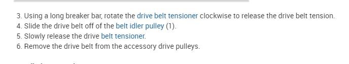

I'm not really quite sure how to get the belt off of there.
Mar 29, 2020 at 4:17 AM
You will need a long handle 3/8 rachet to attach to the tensioner and pry on it and release the belt.
You may want to have someone help you with this if you have never done this before.

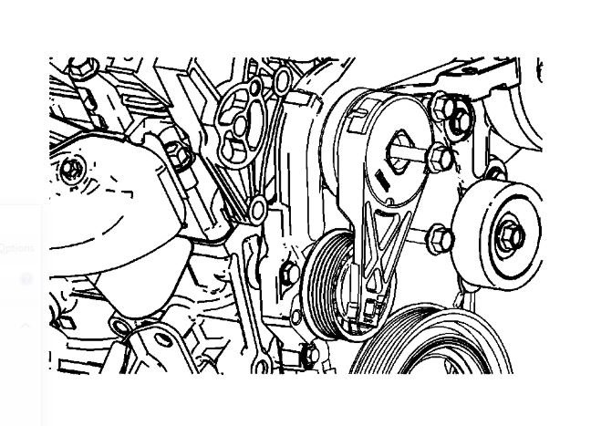

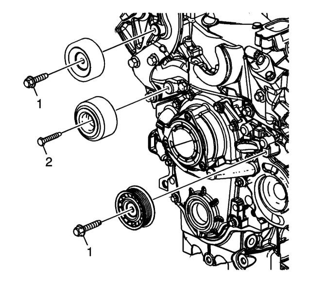

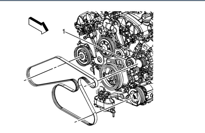

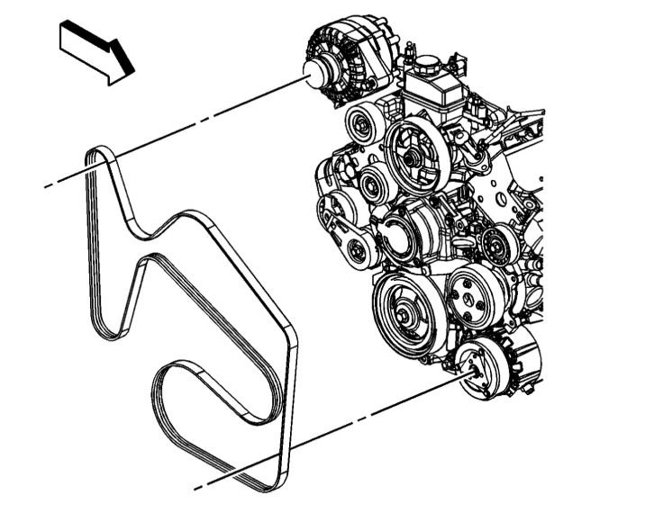

Is this a pulley that needs replaced and how do you know which one?
Mar 30, 2020 at 7:33 AM (Merged)
Good afternoon,
I would remove the belt and spin each pulley to see what one makes noise.
Also, I would start it without the belt as well to verify the noise is gone. That will tell you it is external.
I attached pictures of the belt routing as well as the pulleys.
