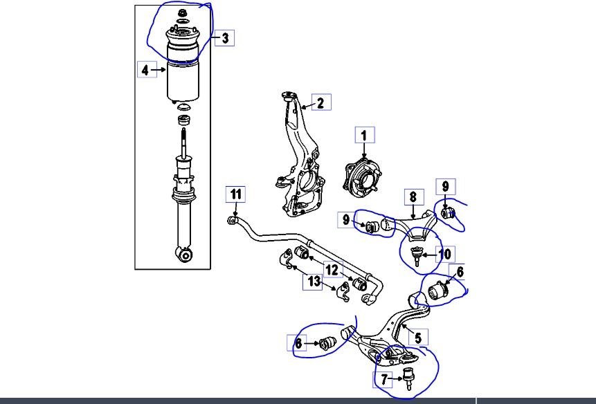

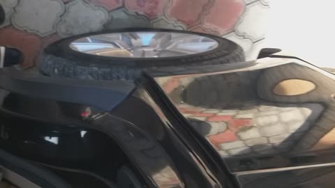

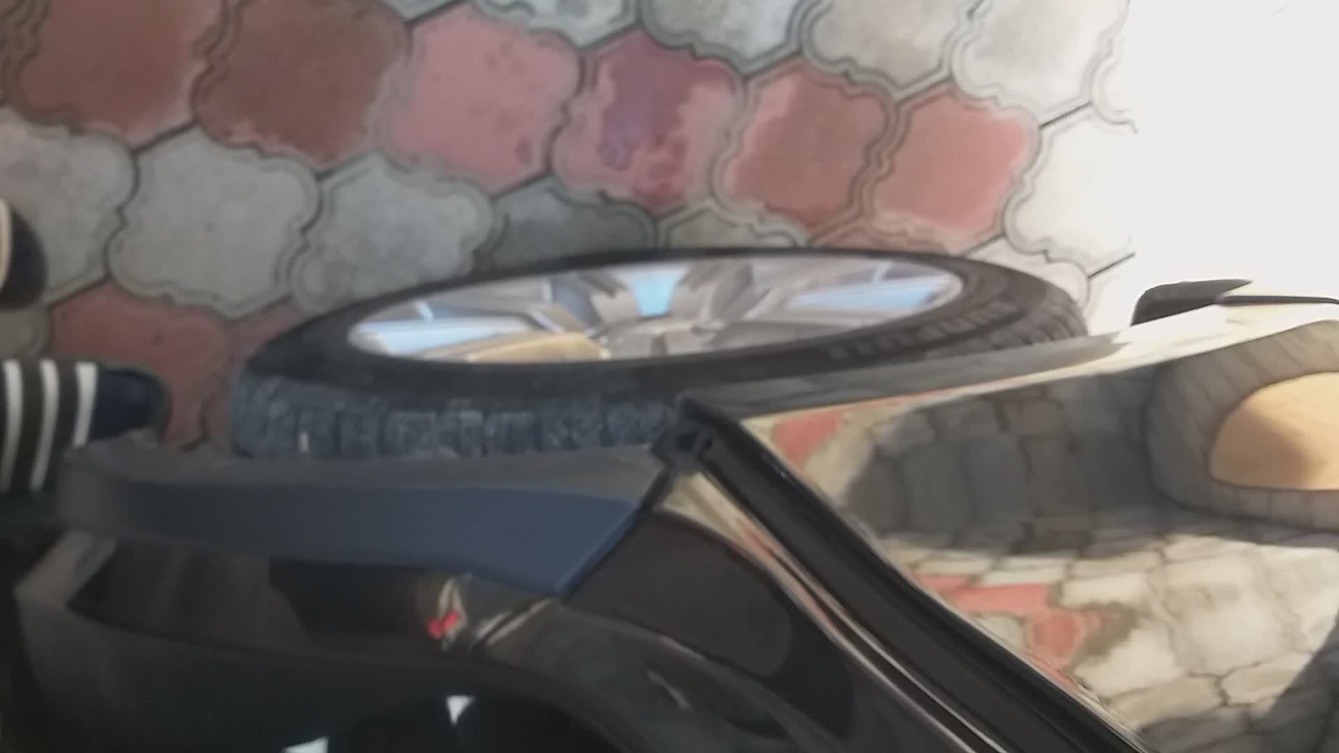

I have a problem in one of my tires; it looks like it's a suspension problem. When the car is moving it makes a noise like iron is burnish. What should i do?

GERIGER
This is the noise.
Jun 16, 2020 at 1:15 AM
Good morning,
Were you bouncing it up and down during the video?
This could be a bushing or a ball joint.
I attached a picture for the front suspension for you. I circled the possible areas that could cause the issue.
You need a second person to bounce the truck and you should put your hand on each of the items and see if you feel the noise.

Yes I am bouncing it up and down. It's the right back tire. What should I do?
Jun 16, 2020 at 1:33 AM
You need to feel for the noise to determine the part that is making noise.
If you cannot find it, take it to a shop and have them check it for you and tell you the failure. then we can discuss options.
