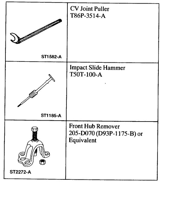

Special Tools
pic 1

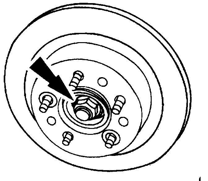

2. Remove the wheel and tire assembly.
pic 2

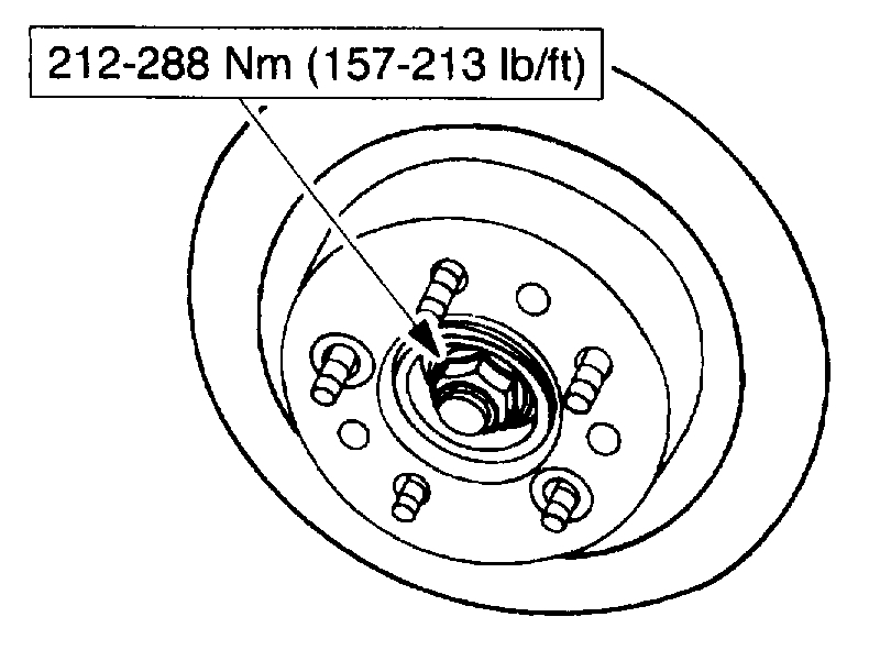

3. CAUTION: Discard the wheel hub retainer nut and washer assembly. It is a torque prevailing design and cannot be reused.
Remove the wheel hub retainer nut and washer assembly.

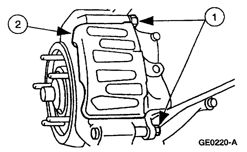

pic 3

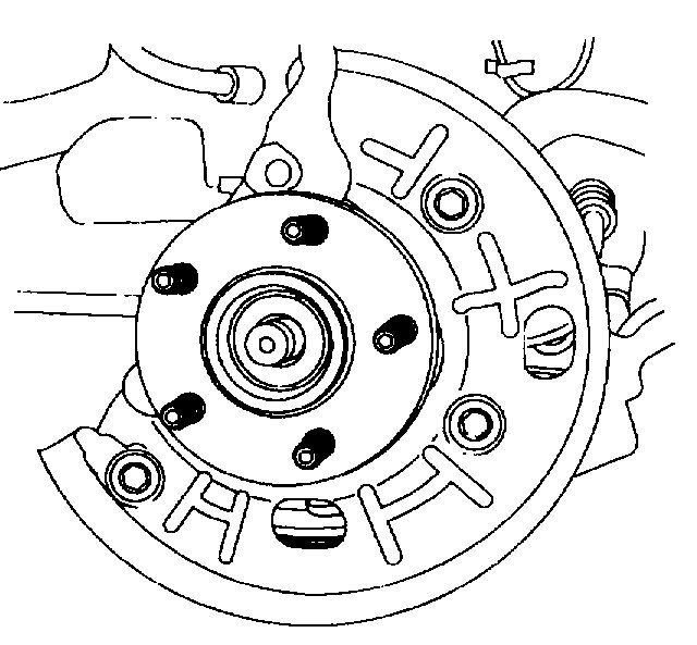

4. Position the disc brake caliper aside.
1. Remove the two front disc brake caliper bolts.
2. Lift the front disc brake caliper off the front disc brake caliper anchor plate and position aside.
pic 4

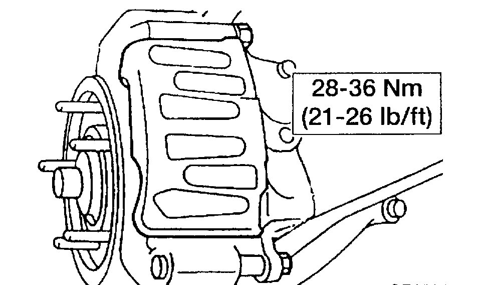

5. Remove the brake discs.
pic 5

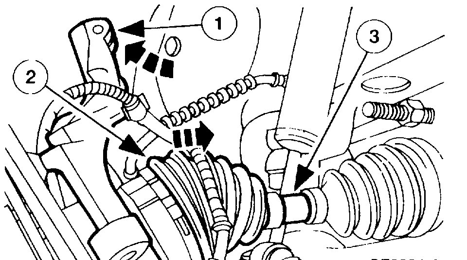

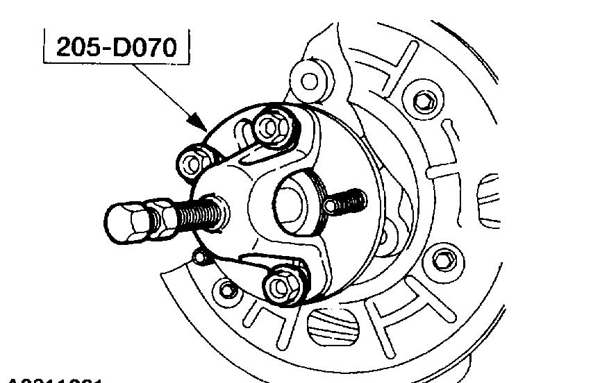

6. CAUTION: Do not use a hammer to separate the outboard front wheel halfshaft joint from the hub. Damage to the outboard CV joint stub shaft housing threads and internal components may result.
Install the special tool and separate the halfshaft from the hub. Remove the special tool.

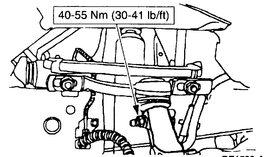

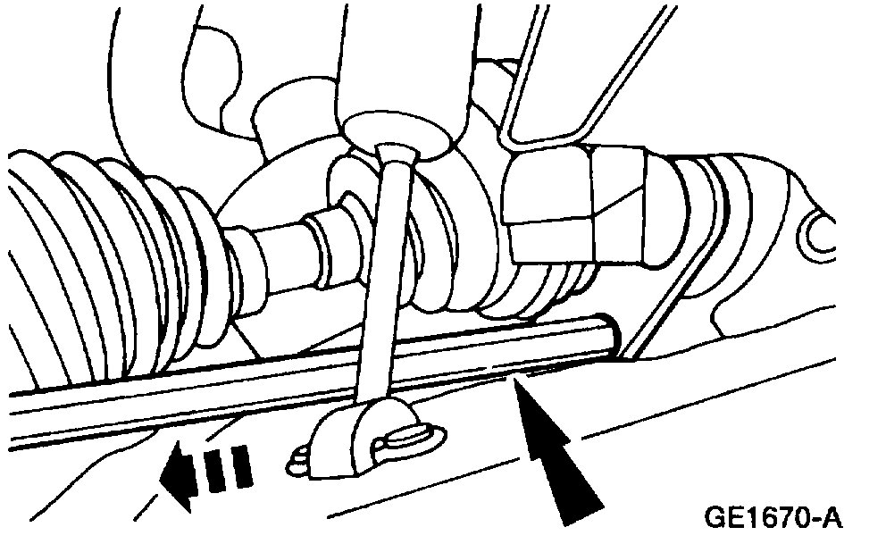

7. Support the front suspension lower arm.
pic 6

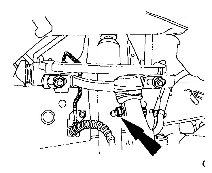

8. Remove the upper ball joint to front wheel knuckle nut and bolt.
pic 7

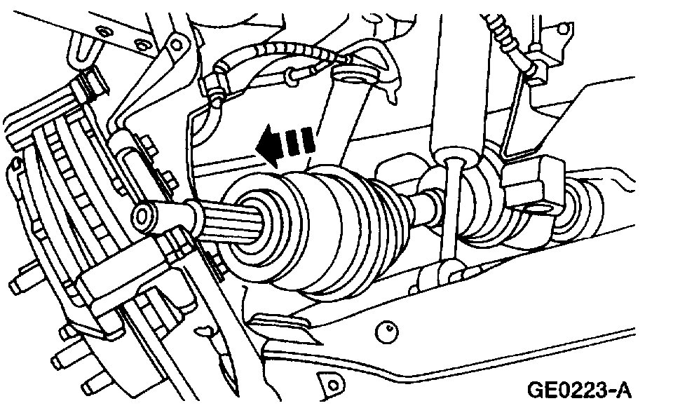

9. Remove the outboard front wheel driveshaft and joint from the hub.
1. Rotate the front wheel knuckle.
2. Compress the outboard front wheel driveshaft and joint.
3. Remove the outboard front wheel driveshaft and joint from the wheel hub.
pic 8
10. Using the CV Joint Puller and Impact Slide Hammer, separate the front wheel driveshaft and joint from the front axle housing.
