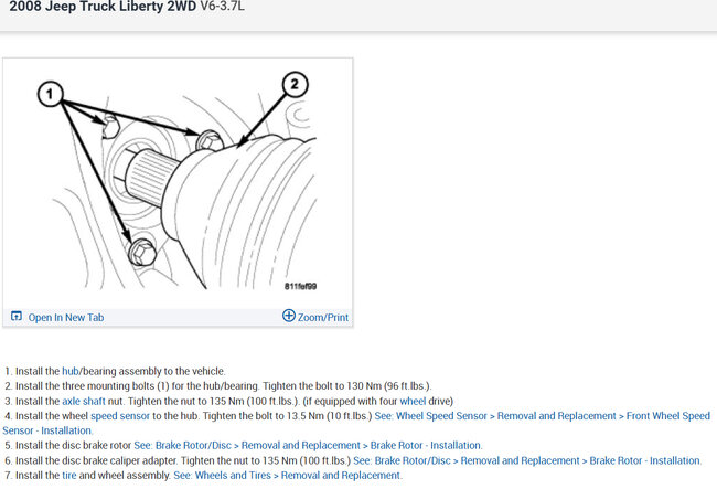

Yep, this is common when the wheel bearing hub goes out, can I ask if you have aftermarket rims and tires on it? If so, this will make the bearing go out much sooner than normal. Here is how to change the bearing hub out. Please upload videos in your response of the noise so I can be sure. Check out the images (below). Let us know how it goes.
