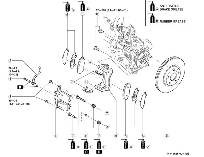

Grinding noise from front passenger side tire when driving over bumps or rough roads.
May 15, 2024 at 8:58 PM
  • 55,423 POSTS
Front or rear? I would start with the brake pads which will grind like you have mentioned.
Here is a guide to help understand grinding noises:
https://www.2carpros.com/articles/vehicle-grinding-noise
Here is how to change out the front brake pads and rotors and a guide to help you raise the car up and remove the tires for inspection.
https://www.2carpros.com/articles/wheel-removal-and-re-installation
and

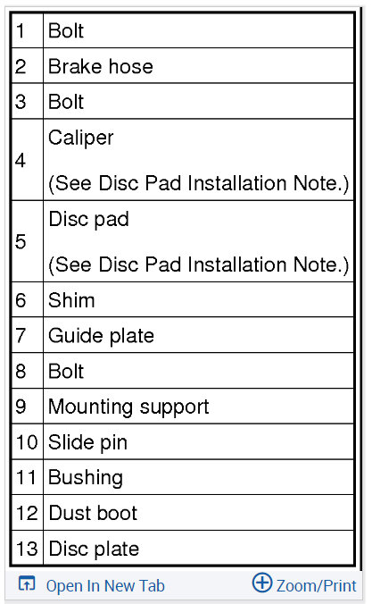

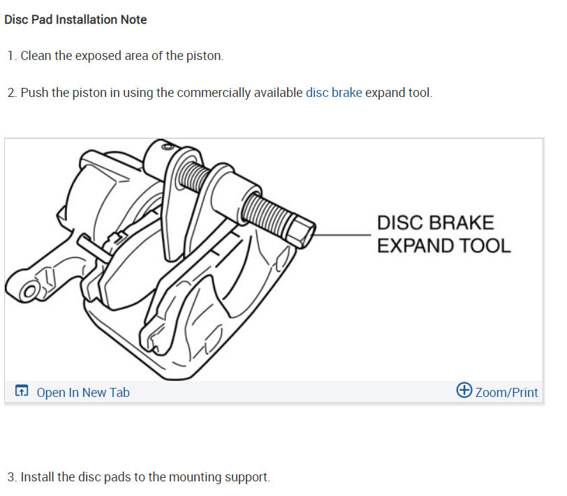

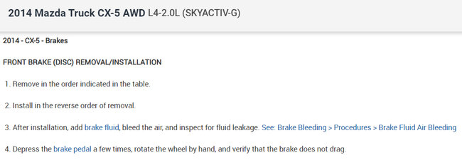

Read these guides completely before beginning. Here is how the front brakes are done. Check out the images (below). Please upload a video in your response to the noise so I can tell for sure what's going on, it takes time to upload so please be patient.
