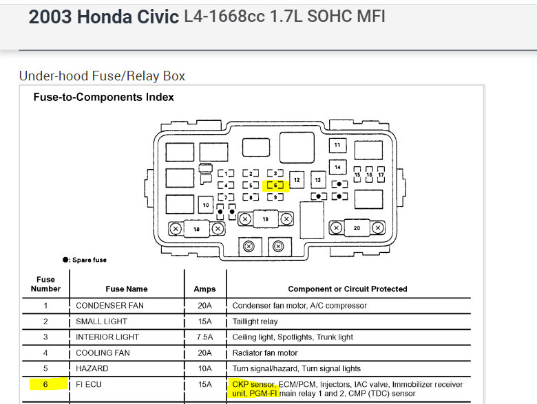

Number 6 fuse blows immediately at accessory on (ll)?
156,000 MILES • 1.7L • 4 CYL • 2WD • AUTOMATIC
HUGODG951

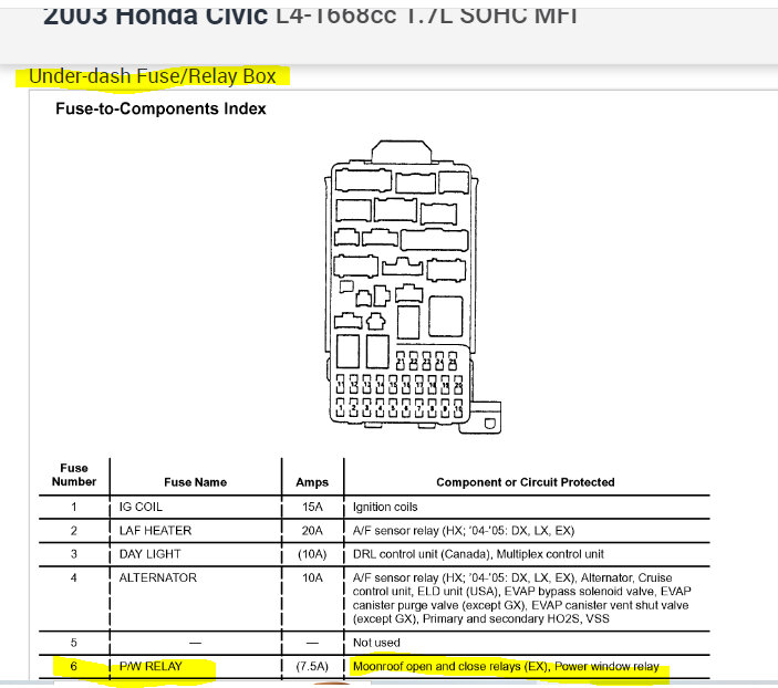

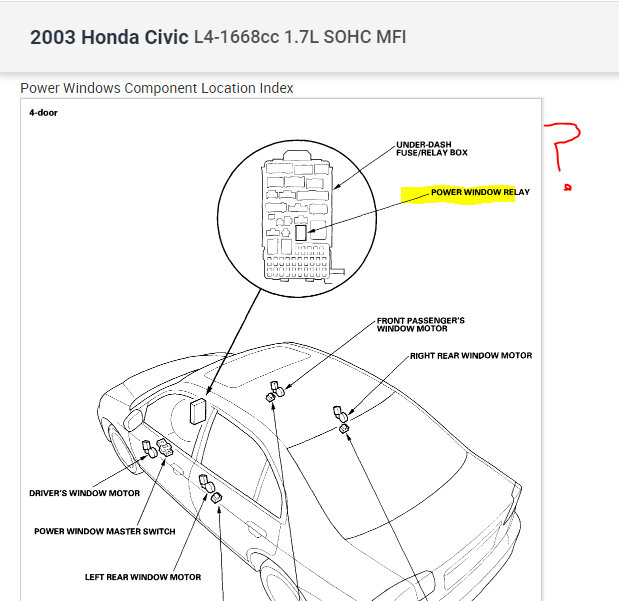

no crank no start, all I hear is the fuse blow if I have a good fuse in. if I remove the 4 pin brownish? Relay under passenger dash the fuse doesn't blow.

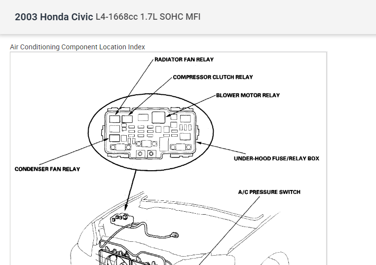

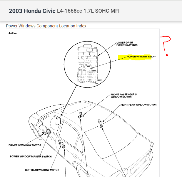

I need some info. Is fuse 6 in the interior fuse box or is it in the under-hood fuse box? Also, I need to determine what relay you are referring to. I attached pics below. Take a look at them and let me know which ones you are dealing with.
One other thing, if you switch the relay you have with a different one having the same part number, does the fuse still fail?
