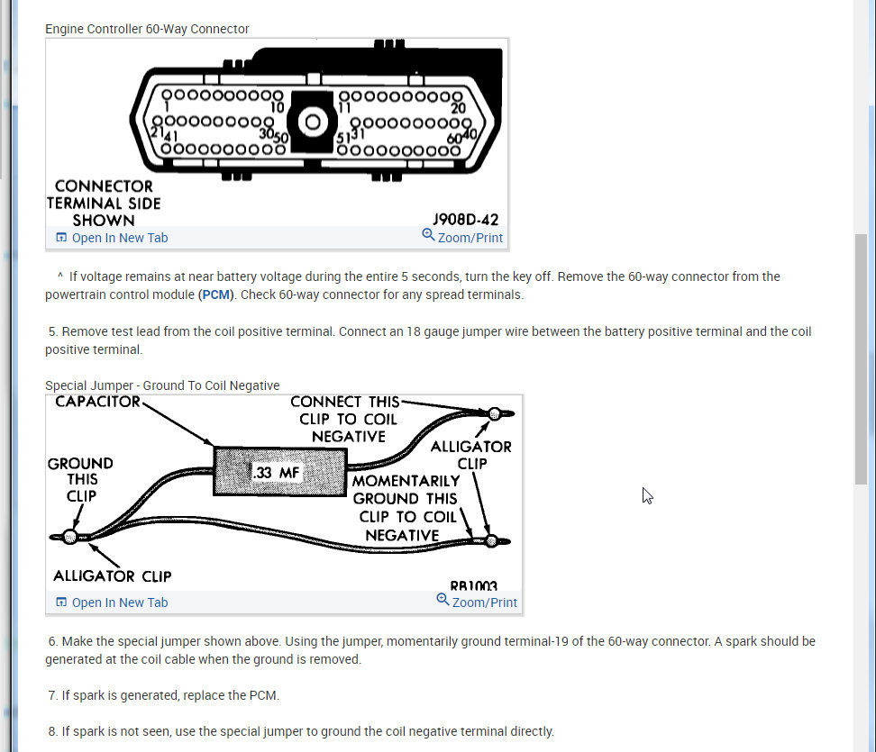

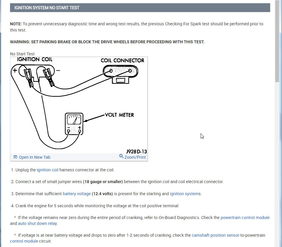

I changed the ECM as recommended because of possible no grounding. Now, I still don't get a spark on primary side. The oil gauge doesn't show any oil pressure at all. What could be causing this? no start, no oil pressure?
Jun 7, 2021 at 9:01 AM
It is hard to say what component is causing this based on this info so we are going to have to run through the testing that I attached below to find out what the possible issue is.
Here are a couple guides that will help with this testing:
Let me know if you have questions but this should help narrow down what is causing the no start issue. Then we can tackle the oil pressure issue.
