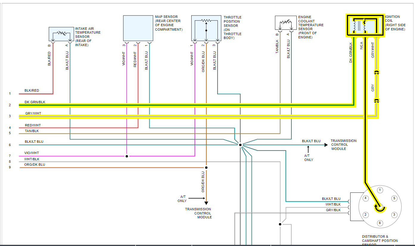

I get no spark from coil. no power to coil. Everything else works fine, except when I turn the ignition key to start my oil gauge meter doesn't register.
May 31, 2021 at 8:36 AM
Good evening,

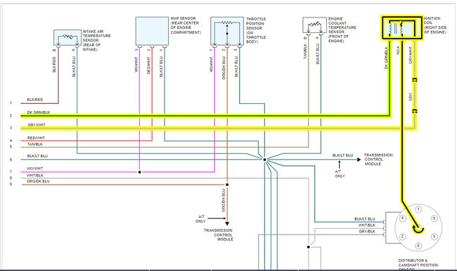

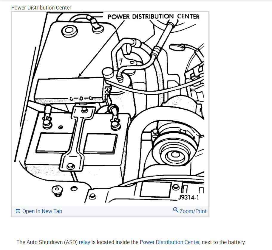

The power for the ignition coil comes from the auto shutdown relay.
I attached a wiring diagram for you to view and also the location of the relay for testing.
With the key on, there should be 2 powers to the relay. You need a voltmeter to do this check and verify. The relay is a common failure.

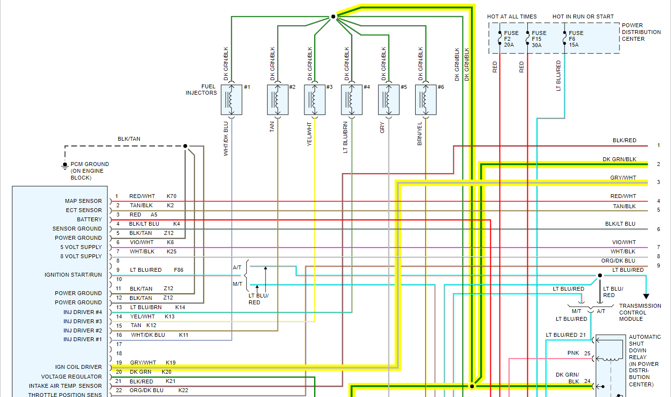

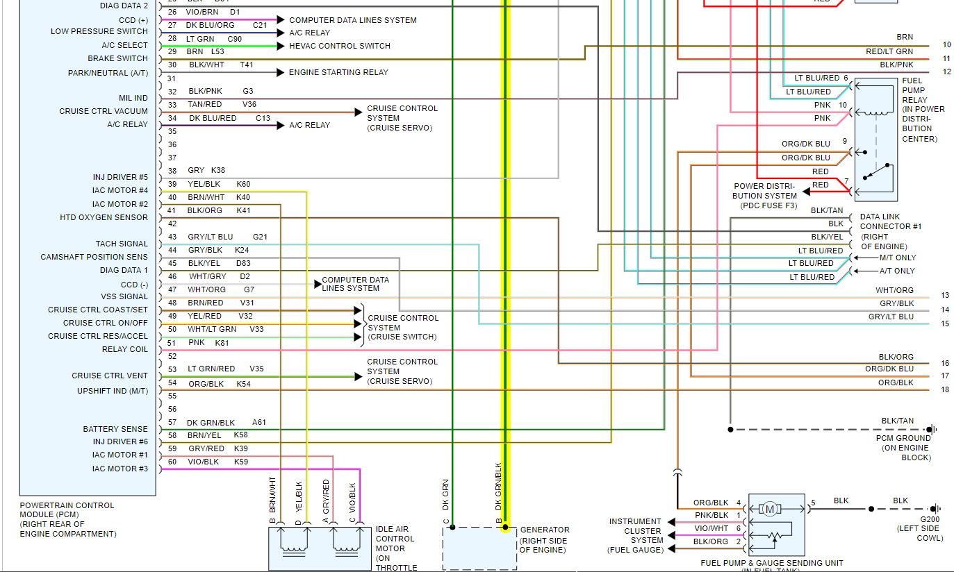

The ECM is what grounds the relay for it to provide power to all the components.

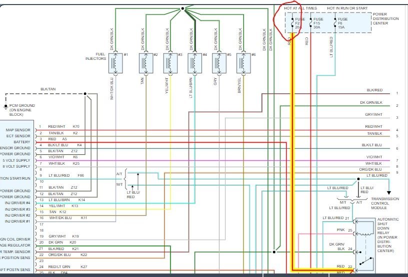

Pin 30 needs power all the time. I attached a diagram with the fuse that controls the power for that pin. Check that fuse for power on both sides.
Pin 87 will only have power when the relay is energized.

There is power at the pin 30. The fuse had power on both sides.

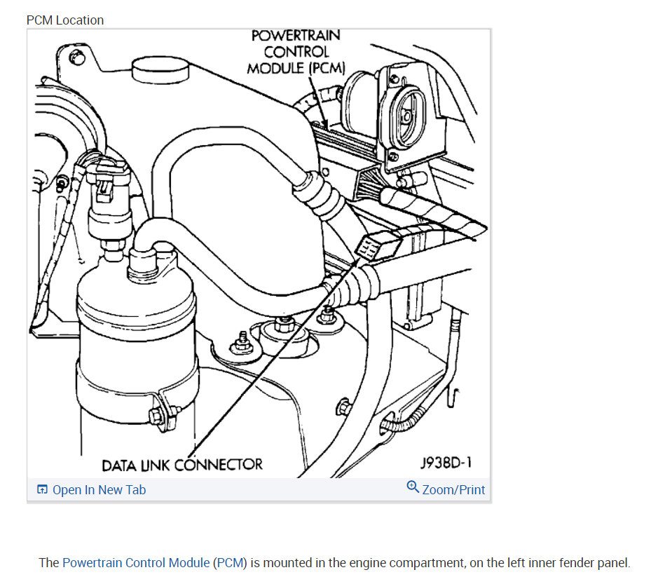

Okay, the ECM is not grounding the relay.
Looks like you need the ECM.
Jun 1, 2021 at 9:03 AM
