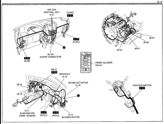

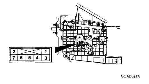

Cannot switch between defrost or floor stays on middle vent . Can this be heater door actuator and if so where is it located?
Oct 19, 2017 at 11:32 AM
STEVE W.
  • 15,410 POSTS
Sounds like a mode door actuator located on the HVAC case behind the case in line with the center console area.
However, other than these pictures there is no repair/replacement information showing up. Checked Alldata, Mitchell, and a paper copy of the 2004 service manual.
Oct 19, 2017 at 2:48 PM
SLICK1080
Thanks for the help and that is what is was.
