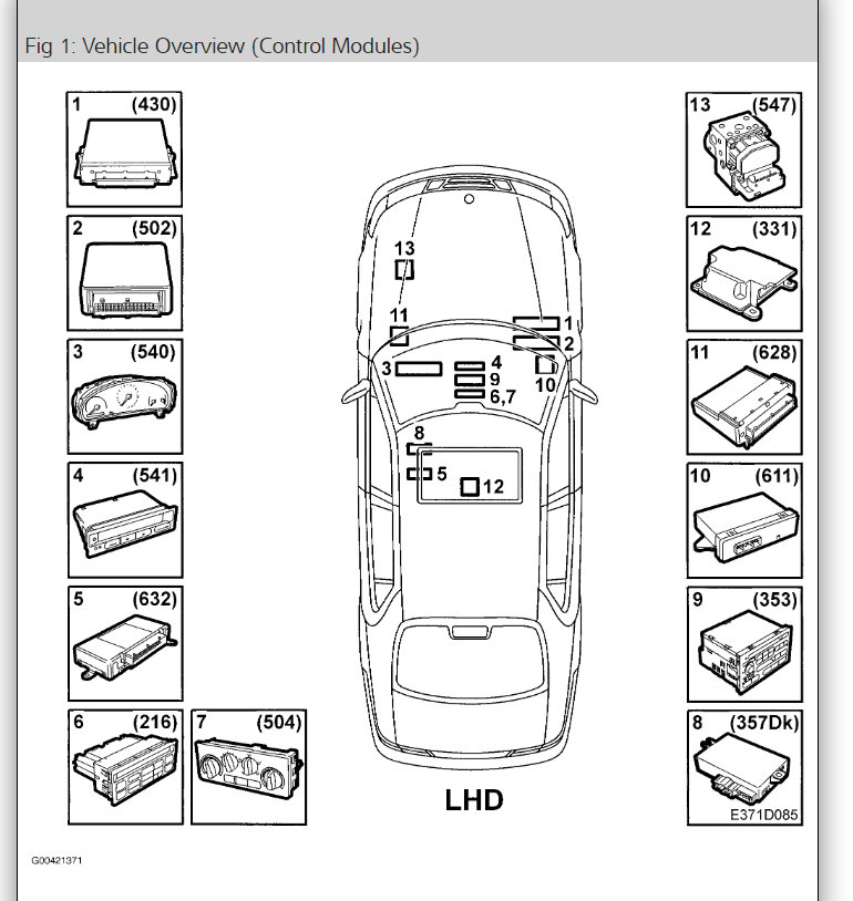

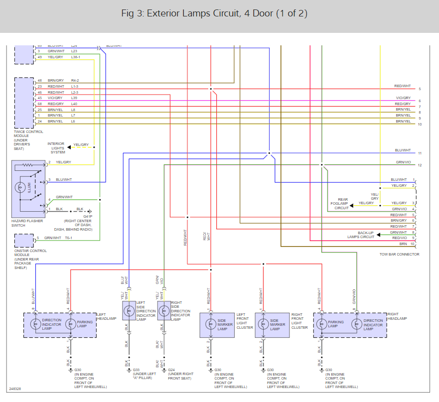

Hello, i have got no turning click signal since a while.
Along with that the radio (maybe not related) is running on itself when i stop the car even with keys out. Have to shut it down manually to avoid battery draining.
Any clue?
May 16, 2019 at 10:28 PM
  • 55,845 POSTS

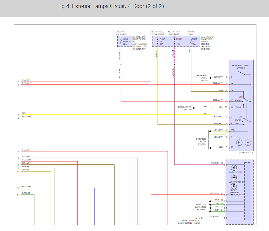

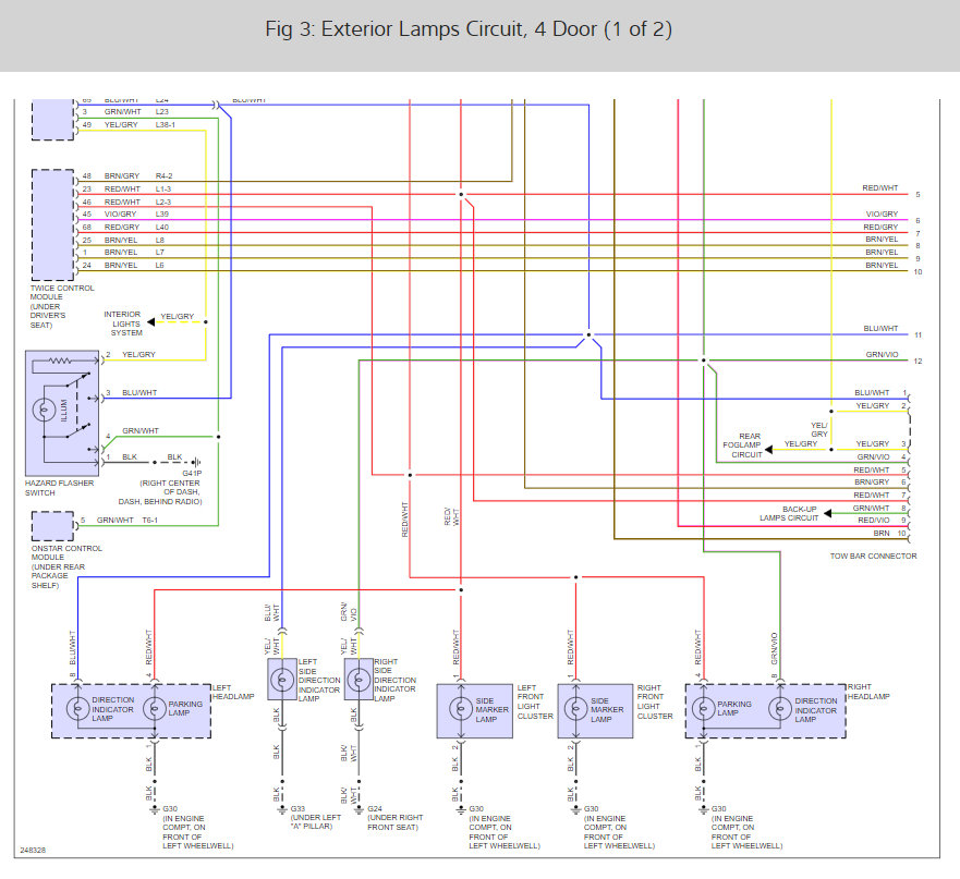

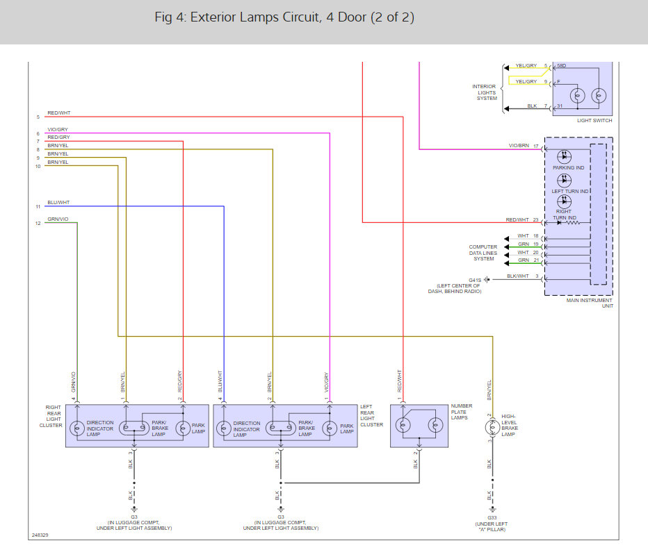

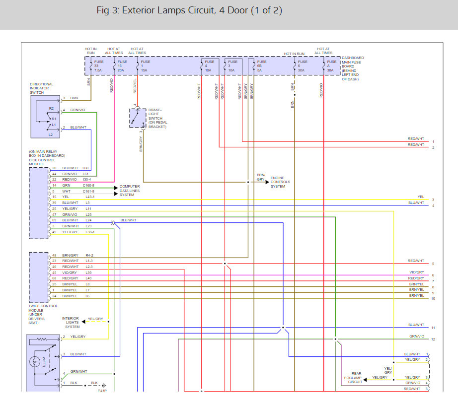

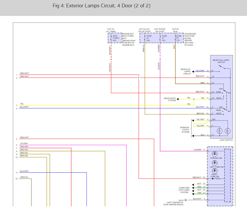

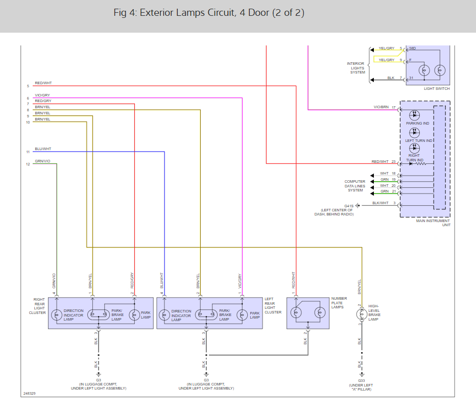

These can be related you have a DICE module (11) that sounds like it is going out here are the wiring diagrams so you can see how the system works and the module location I would check it for water damage. Check out the diagrams (below). Please let us know what you find. We are interested to see what it is.
