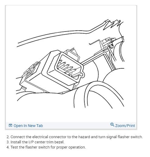

It sounds like the hazard switch is not plugged in. I would double check that first, the is also a park lamp relay that needs to work for the system to light up. Here is some wiring diagrams and a guide to help you get the problem fixed.
and
Please run some tests and get back to us so we can continue helping you.
Best, Ken

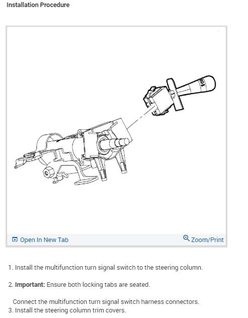

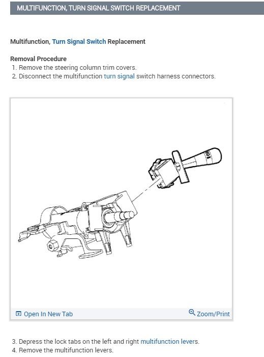

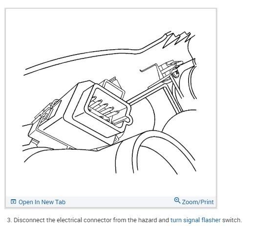

The combination flasher is located behind the center of the dash. Check out the diagrams (Below). Please let us know if you need anything else to get the problem fixed.

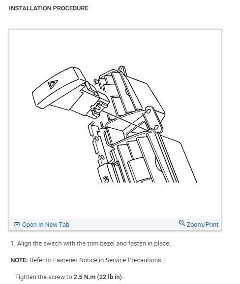

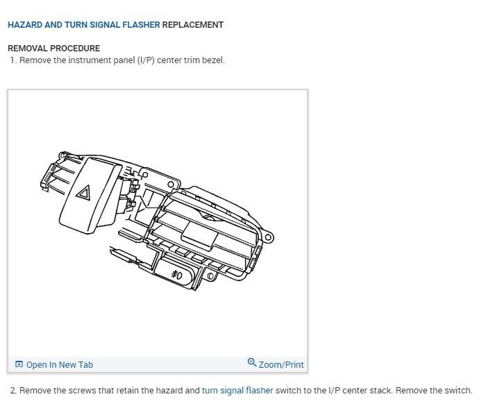

the switch is the stick for your turn signals. the flasher is the 4 way flasher button. See diagrams below for multi function switch and hazard switch/flasher replacement

Where is hazard or flasher relay located
Oct 8, 2018 at 5:48 AM (Merged)
part of the 4 way flasher switch and that is in the multifunction switch
