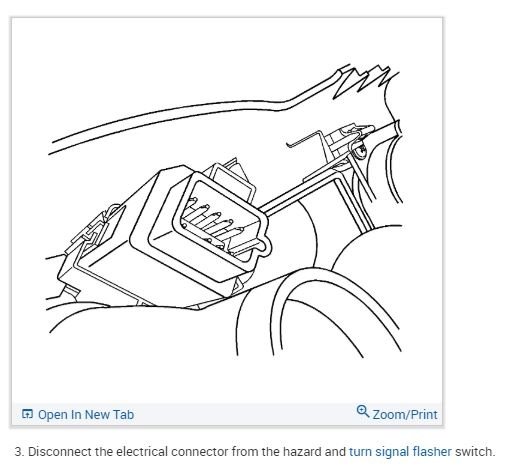

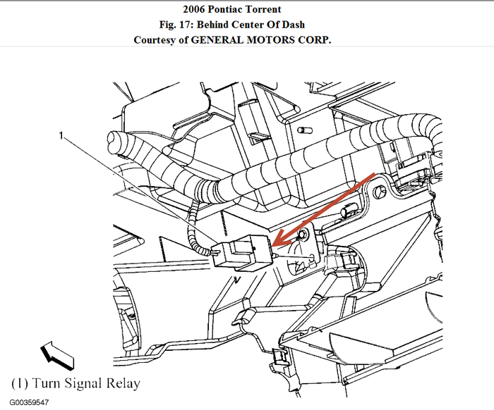

After repairing the heater blend door and having the dashboard disassembled, I reassembled the dashboard, and found there was absolutely no power to the signal lights or hazard lights, no clicking noise and no power to bulbs for signals.
I checked the dashboard ground, the turn signal fuse (at box) and for broken or pinched wires, the multi-function switch on column works for everything else, (high beam, low beam, headlights, park lights) but no signals, also the hazard light switch does not work.
Would you have any idea what it might be? I could not find the four way flasher fuse or the blinker light fuse.
Apparently Gm does not list a flasher fuse or even a hazard fuse, (i"m talking the one inch square or round plastic fuse that fits up under the dash as i"ve already checked the small fuses) for a 2006 Pontiac Torrent, if anyone knows if there is one and where it is located please, please, let me know, I also bought a brand new Multi switch and that didn"t fix the problem, also a new Hazard switch, I've had the dash apart three times looking for shorts or loose grounds or connections and I am at the end of my rope, please.
Nov 25, 2013 at 3:51 PM
  • 55,112 POSTS

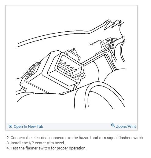

It sounds like the hazard switch is not plugged in. I would double check that first, the is also a park lamp relay that needs to work for the system to light up. Here is some wiring diagrams and a guide to help you get the problem fixed.
and
Please run some tests and get back to us so we can continue helping you.
Best, Ken

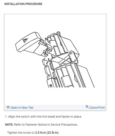

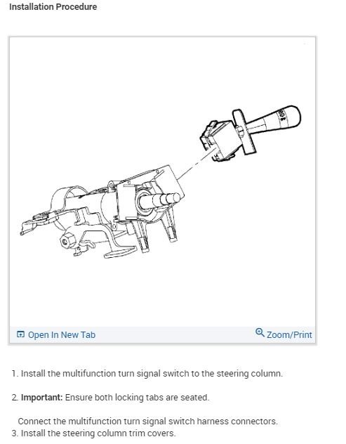

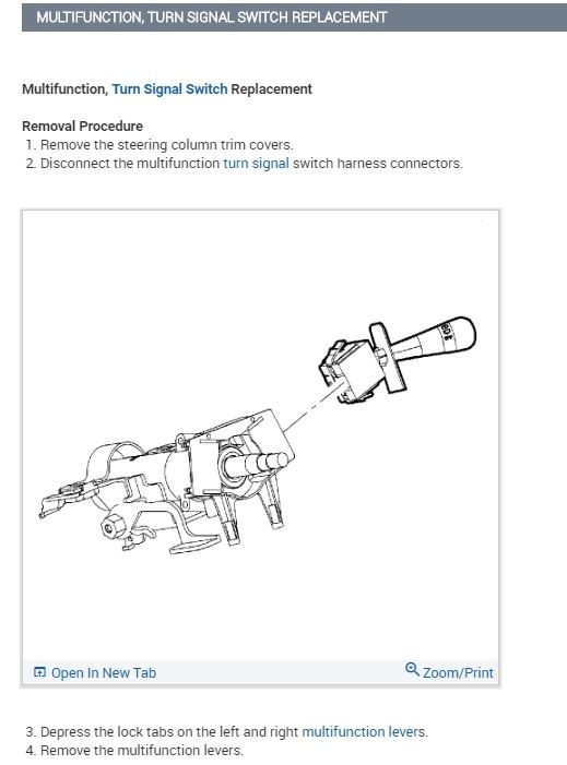

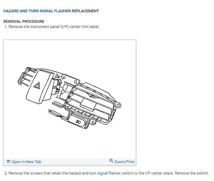

The combination flasher is located behind the center of the dash. Check out the diagrams (Below). Please let us know if you need anything else to get the problem fixed.
Oct 8, 2018 at 5:48 AM (Merged)
SHANE32
Where is multi function switch and hazard relay located on 2006 torrent
the switch is the stick for your turn signals. the flasher is the 4 way flasher button. See diagrams below for multi function switch and hazard switch/flasher replacement
SHANE32
Where is hazard or flasher relay located
part of the 4 way flasher switch and that is in the multifunction switch
