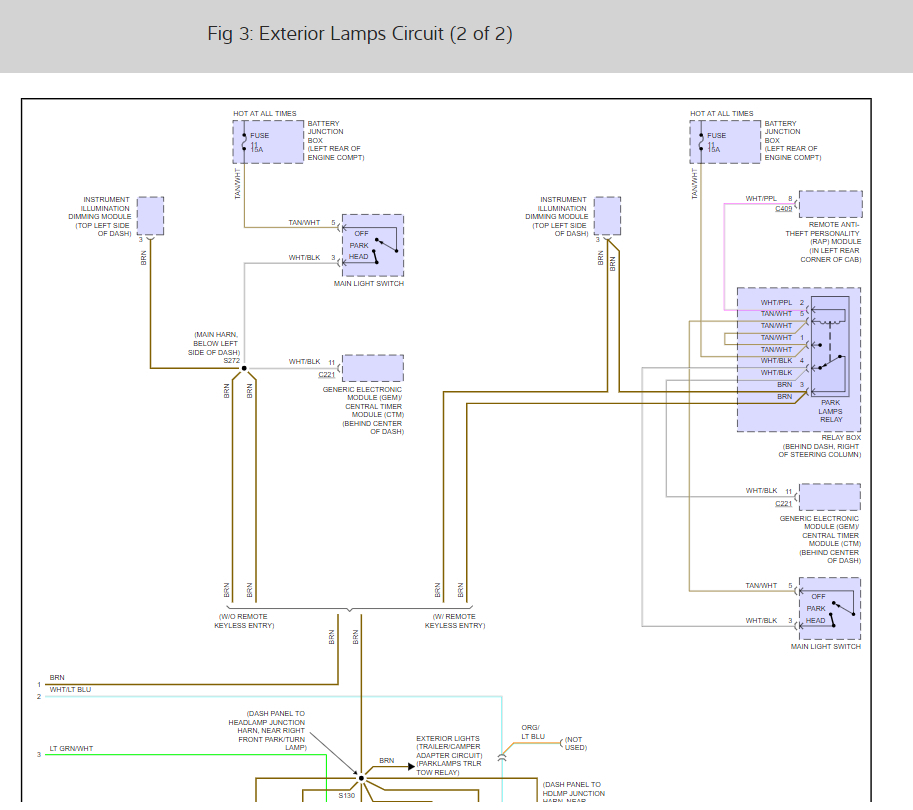

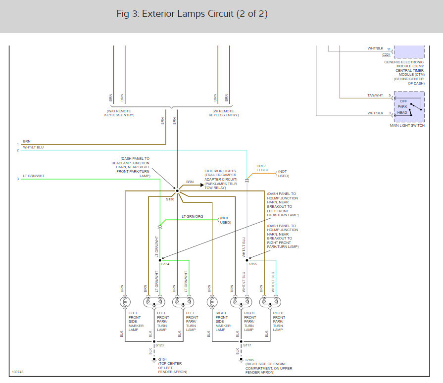

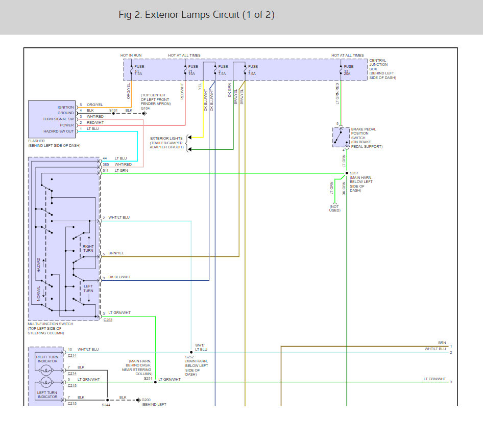

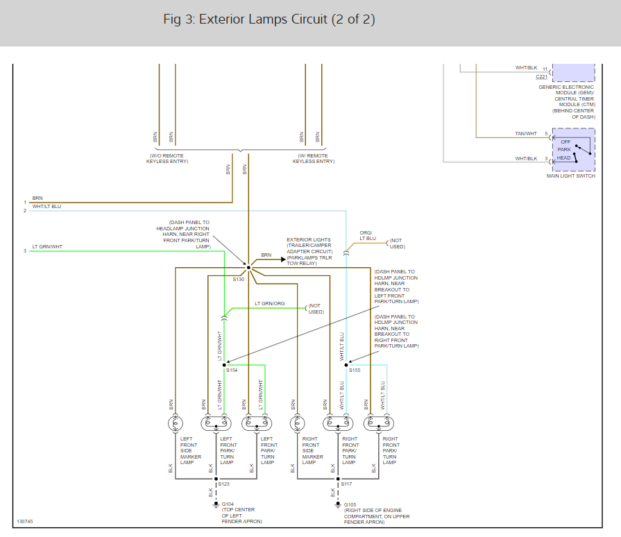

Checked fuses and bulbs. New multi-function switch replaced. Still nothing. What else can we do? Please and thank you.
May 5, 2019 at 4:27 AM
  • 55,865 POSTS

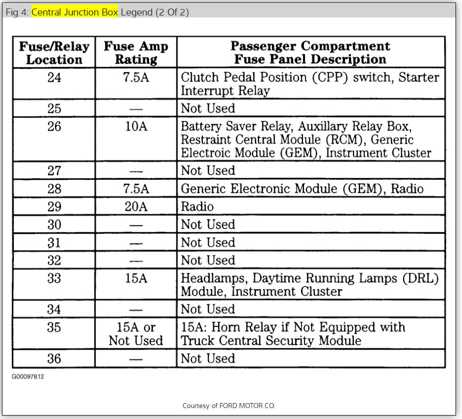

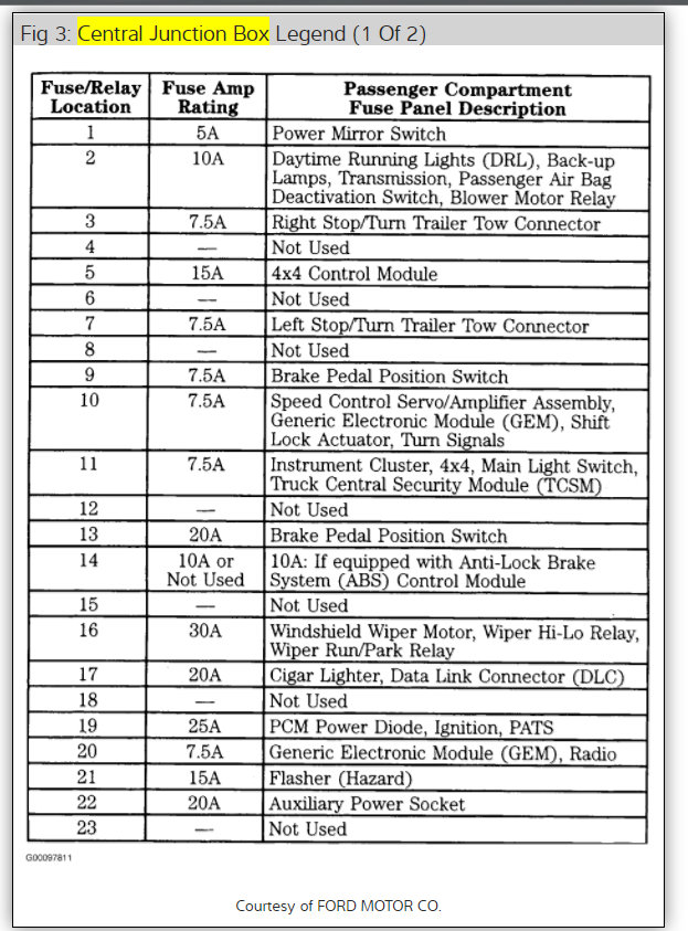

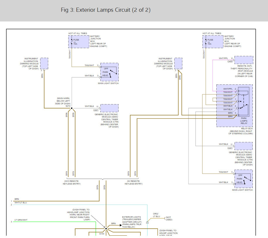

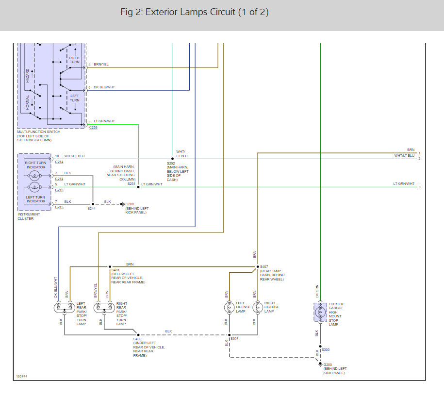

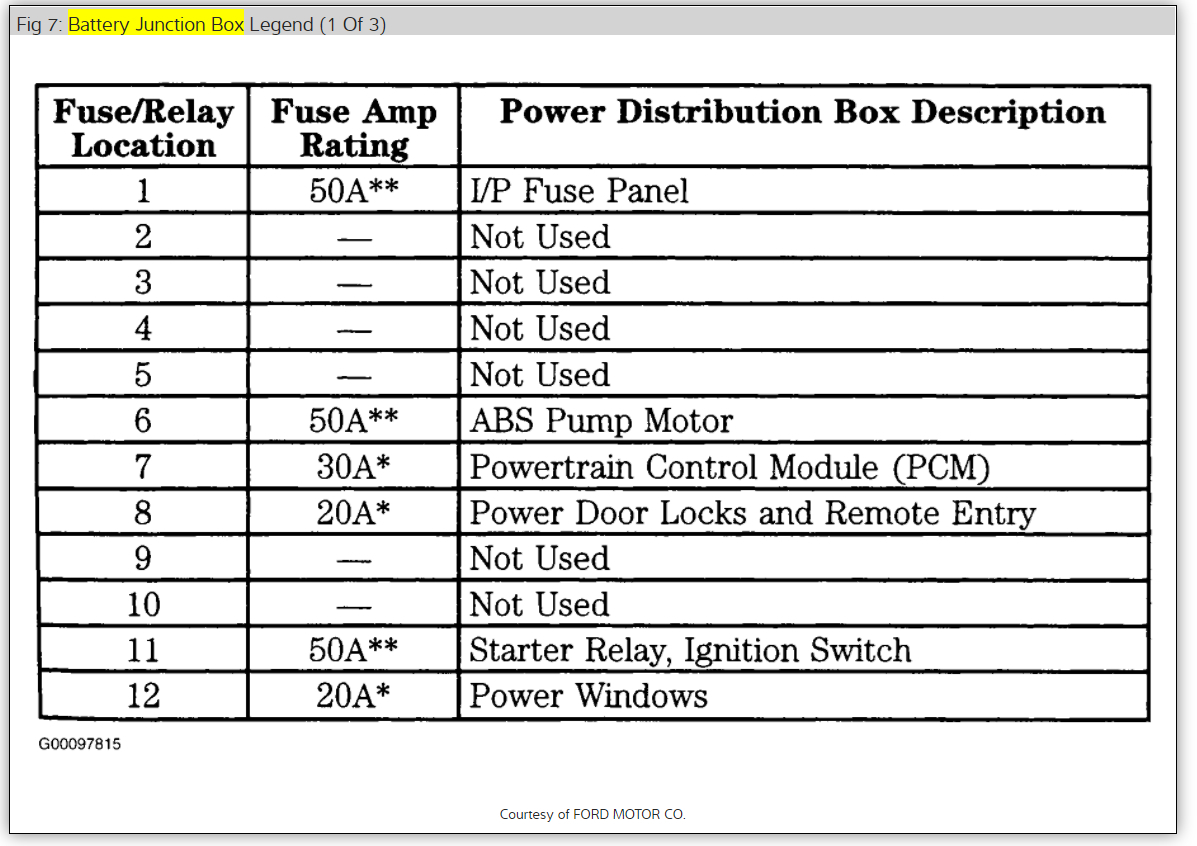

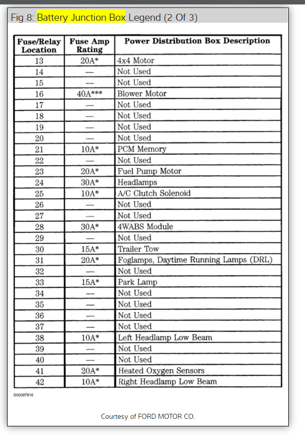

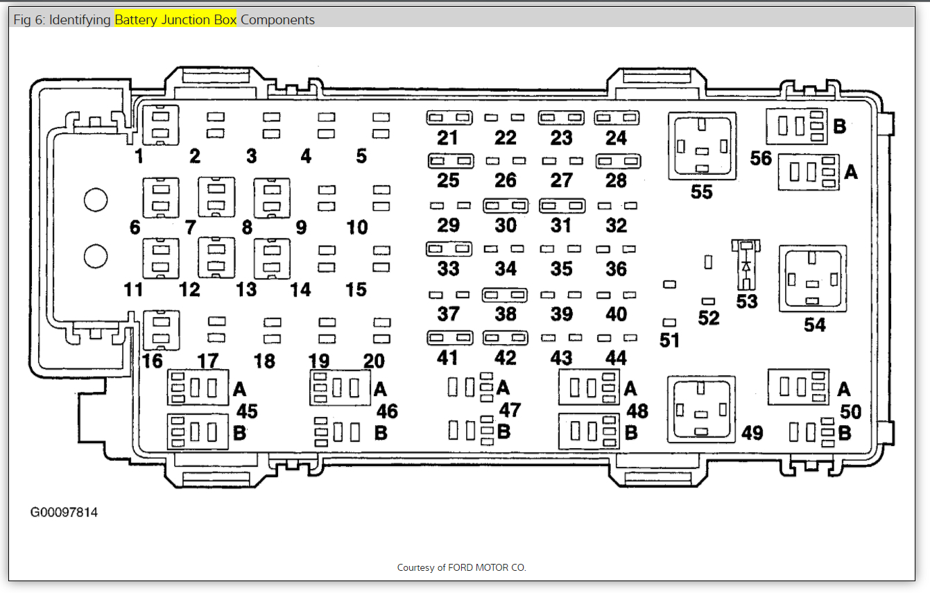

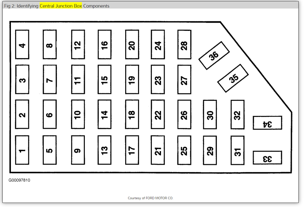

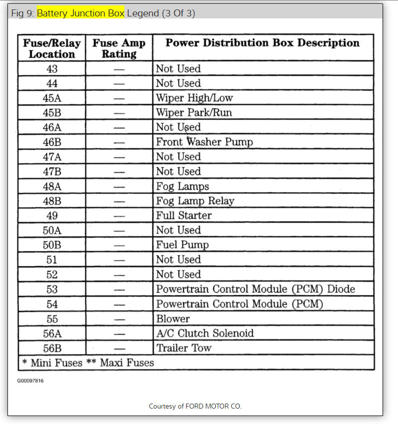

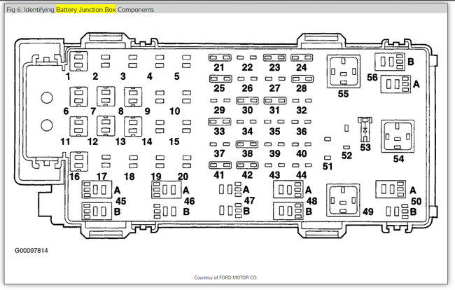

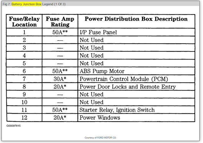

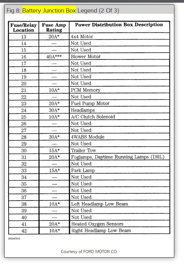

You are loosing power somewhere I would start by checking the power at the fuses here is a guide to help you and the blinker wiring diagrams below so you can see how the system works.
Check out the diagrams (Below). Please let us know what you find. We are interested to see what it is.
