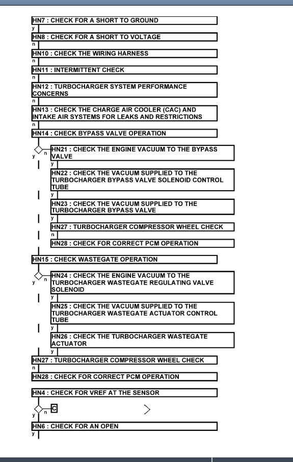

I have the car listed above ST3 model 247bhp on a 62 plate. while driving I lost power and no turbo, car still drives fine but with no power/limited power. there was no lights on the dash until I turned it off then on again and the engine management light came on.
Feb 1, 2020 at 9:56 PM

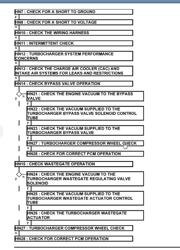

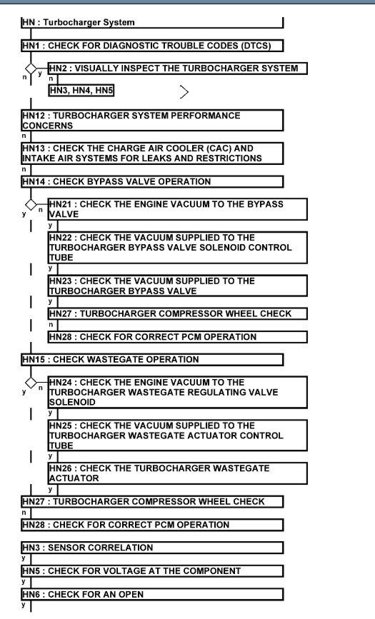

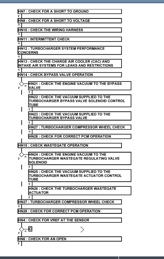

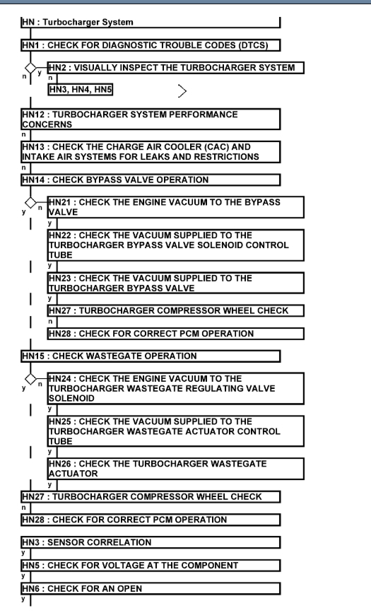

The fact that the light is on, we need to scan for codes. As you can see from the attachments there are 3 pages worth of possible codes related to the turbo.
Let's start with the codes and go from there but it could just be as simple as a vacuum line or more complicated like a wiring issue.
