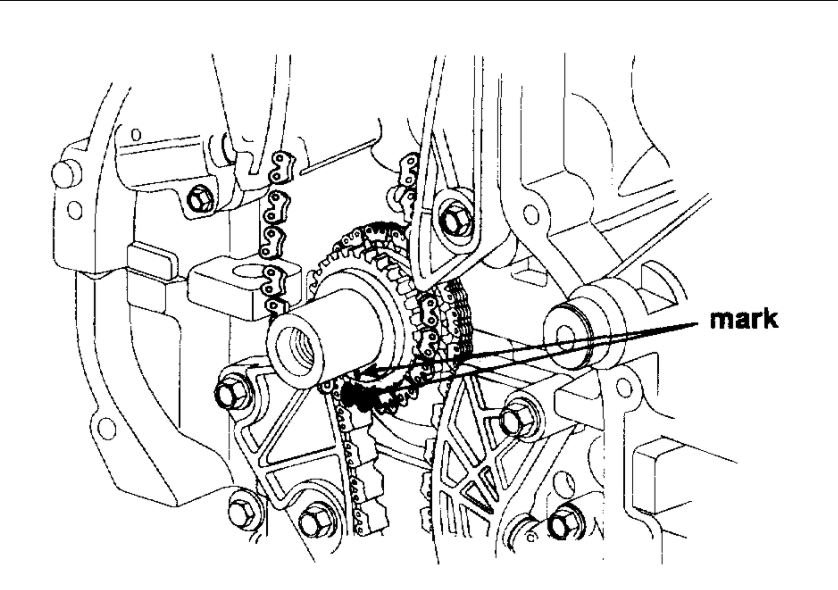

There is no timing chain marks. how can I find out how to line up timing chain properly with no marks?
Oct 26, 2020 at 6:33 PM
Good morning,

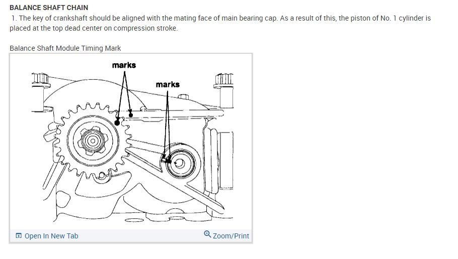

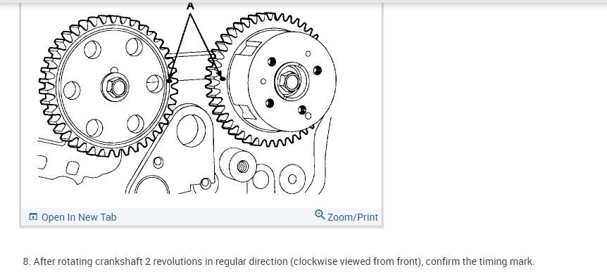

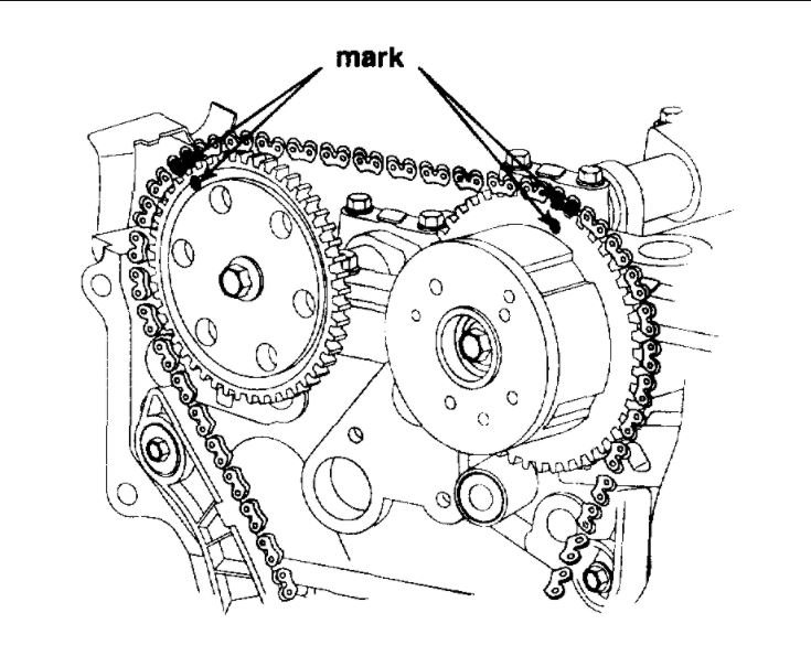

I attached the timing marks for the engine for you.
https://www.2carpros.com/articles/how-a-timing-belt-works
You need the timing chain that has the colored links for installation so you do not install the chain incorrectly and bend some valves.
I attached a YouTube video of installing the chain and setting up the cam timing for you.
https://www.youtube.com/watch?v=xJXg002VjMw
https://www.youtube.com/watch?v=WW9v1Ad66M4

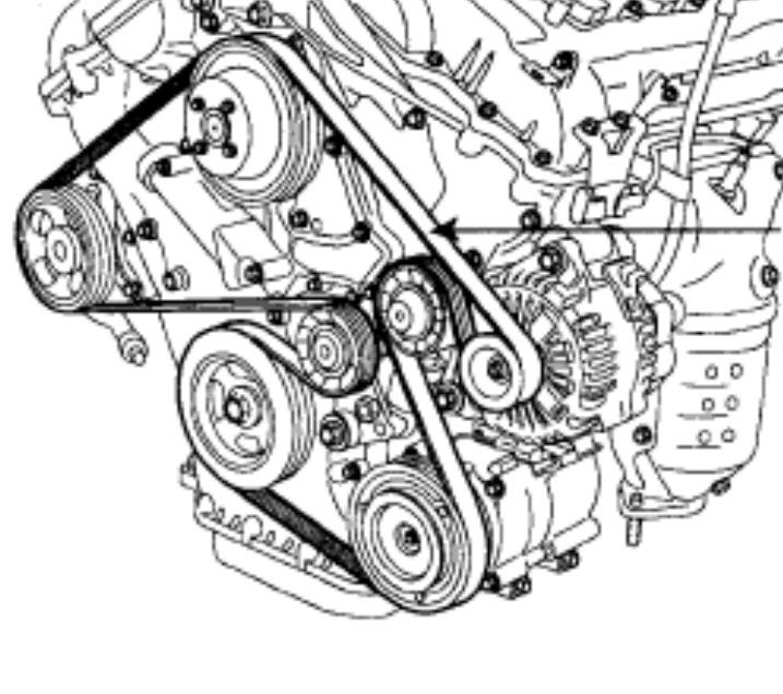

Periodic maintenance. Can you give me the timing belt size and routing?
Oct 27, 2020 at 9:03 AM (Merged)
HMAC300
  • 48,601 POSTS
this has a timing chain not a belt are you sure you just do not want the fan belt? picture shows belt diagram. no size is given. also, tension-er should be replaced. if you want timing chain install then it is too much for us to copy and paste you can rent the manual for a week for your car here on site.
