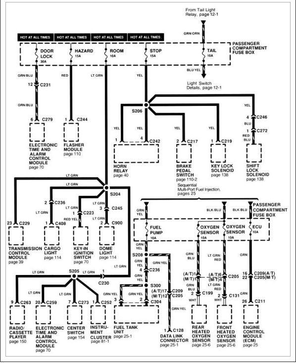

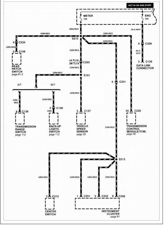

Just because a fuse looks good does not mean it has voltage going through it, go back and check those fuses with either a voltmeter or a twelve volt test light and check both sides of the fuse when it is supposed to be hot. Usually you can just turn the key to run with engine off, and every fuse will be hot.
I do see two fuses though that might be the ones, the ROOM and METER fuses in the passenger compartment fuse block.
Room is hot all the time and METER hot with key on run.

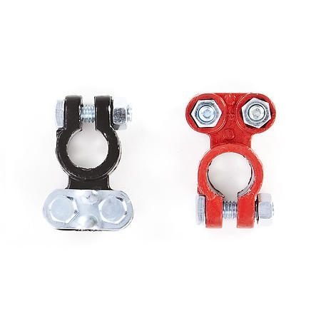

Just get these type, battery terminal ends.
May 30, 2018 at 12:16 AM
HOWARDMORRISON
  • 12 POSTS
Small cables will not fit in a standard battery terminal. Going to try and get one it will crimp on more or less need Japanese style battery clamps.
May 30, 2018 at 12:17 AM
HOWARDMORRISON
  • 12 POSTS
That is the type of terminal I had on it to begin with and I had problems with that in the past.
