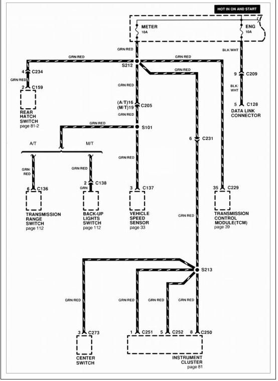

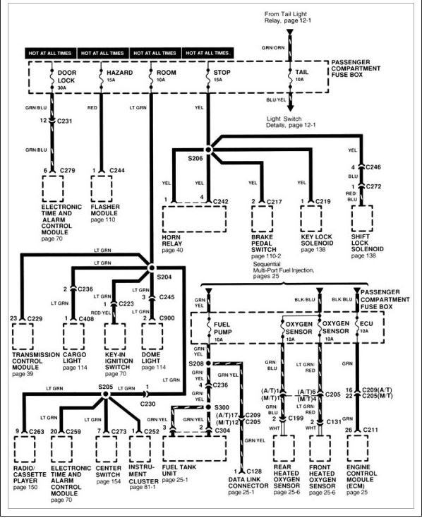

Just because a fuse looks good does not mean it has voltage going through it, go back and check those fuses with either a voltmeter or a twelve volt test light and check both sides of the fuse when it is supposed to be hot. Usually you can just turn the key to run with engine off, and every fuse will be hot.
I do see two fuses though that might be the ones, the ROOM and METER fuses in the passenger compartment fuse block.
Room is hot all the time and METER hot with key on run.

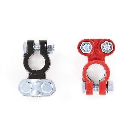

Will check with a voltage meter. Also found loose connection on my battery. I have had issues with this before the battery terminal the cables not thick enough to go in a standard battery terminal. So I am going to have to get one of the crimp on something that I can tighten down really good and go from there. I will check all my fuses with my meter and I will let you know what happens.
May 29, 2018 at 11:59 PM
PATENTED_REPAIR_PRO
  • 1,853 POSTS
Just get these type, battery terminal ends.
May 30, 2018 at 12:16 AM
HOWARDMORRISON
  • 12 POSTS
Small cables will not fit in a standard battery terminal. Going to try and get one it will crimp on more or less need Japanese style battery clamps.
May 30, 2018 at 12:17 AM
HOWARDMORRISON
  • 12 POSTS
That is the type of terminal I had on it to begin with and I had problems with that in the past.
