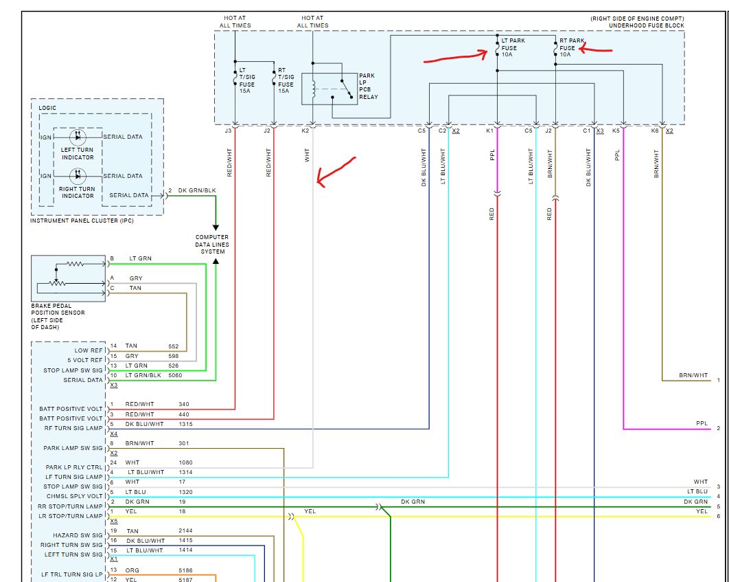

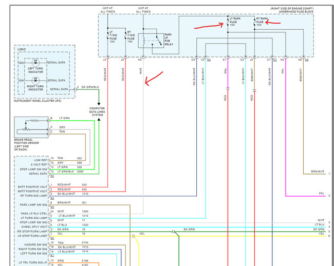

Parking lights and tail lights not working turn signal works brake lights work parking lights flash when locking and unlocking car replaced the headlight switch replaced the 2 parking lights fuzes

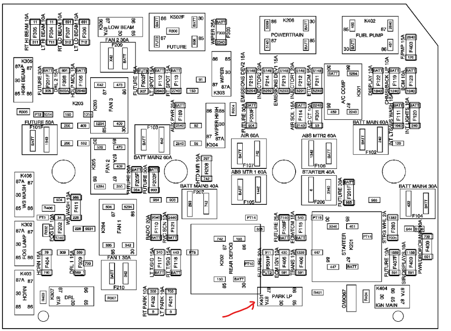

It could be a BCM problem but I would swap out the Park LP PCB relay in the fuse panel under the hood. Please check out the image below.

That is not the right image for my car I do not have a park LP pcb that is changeable I have to replace the whole fuze box to replace that

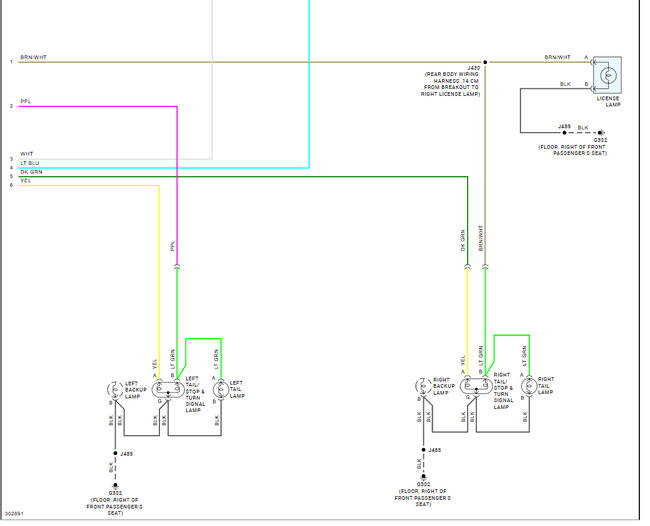

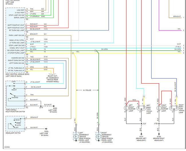

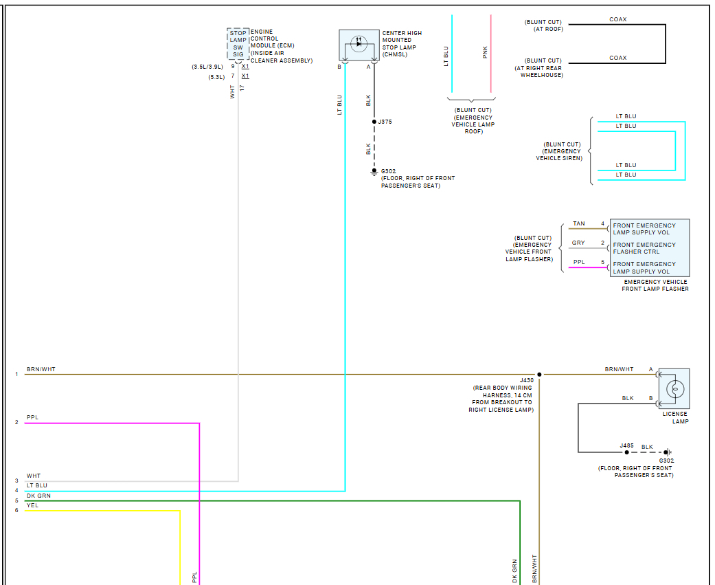

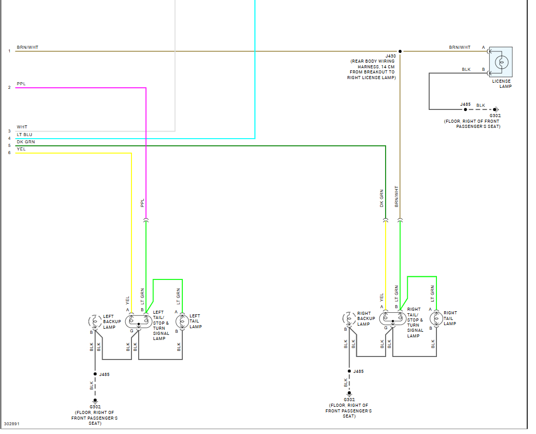

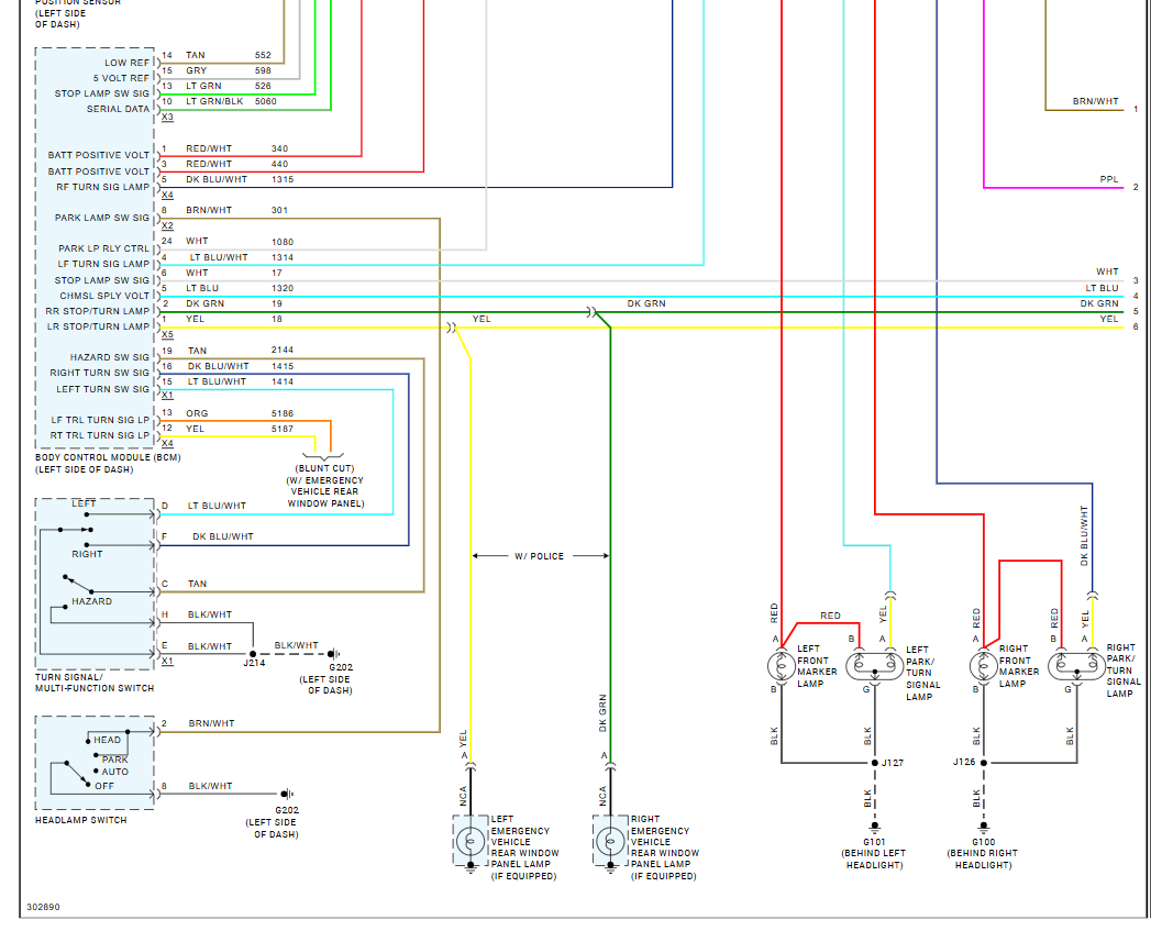

Hmm, with the running lights on, see if the LT and RT fuses get power. Also, the white wire to the fuse panels should go to ground. Here are wiring diagrams so you can see how the system works. This guide can help check for power and ground.

Also, we should do a CAN scan to see if there are any codes for the BCM, this video will help
