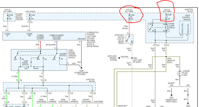

When I turn my headlights on I have no taillights or brake lights.
Apr 23, 2020 at 5:13 PM
  • 110,194 POSTS

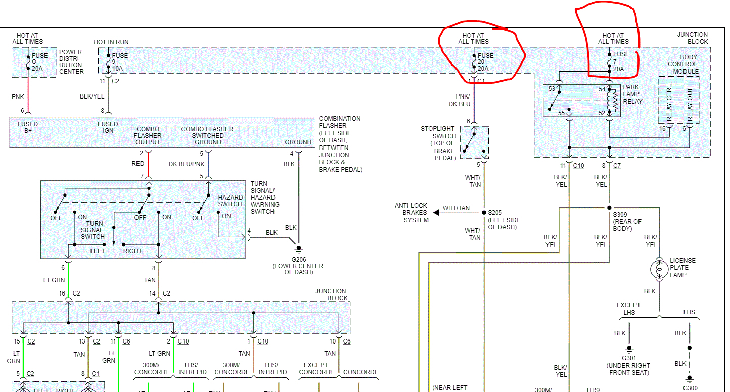

Do the brake lights work when the headlamps are off? Let me know that. Also, I need you to check two fuses. I attached a pic of them below. They are in the fuse box under the hood. Confirm both are good and power is to each.
Let me know what you find.
