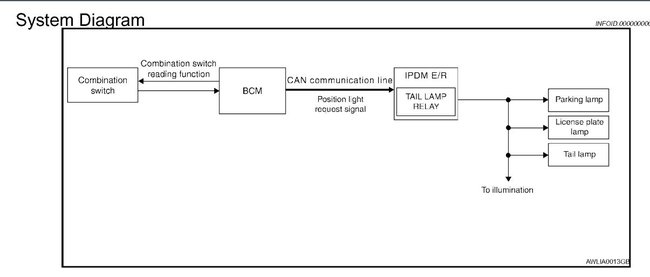

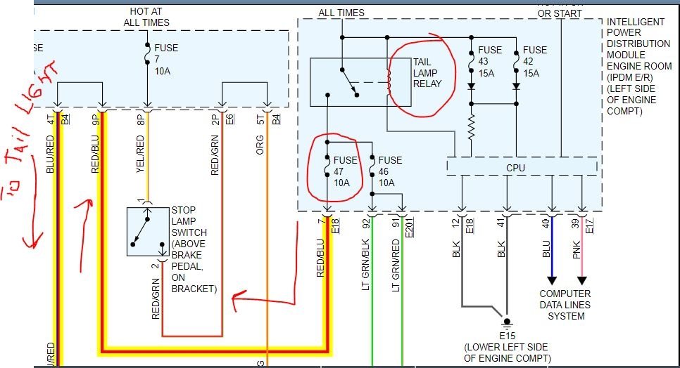

There is no power to any of the taillight running light fuses. The only way I can get taillights is to jump the fuse to another fuse. I have checked every fuse none are popped. I read that it could be a taillight sensor in the trunk but I'm unable to find that. Also maybe BCM relay? Help

I attached a picture I need you to see. Confirm that the fuse I circled is the one that has no power. There is a tail light relay that powers the fuse. If it isn't working, there won't be power to the fuse. Picture 2 shows the circuit.
Also, let me know if any of the lights work. For example, brake lights, signals, reverse lights. Do the front parking lights work?
